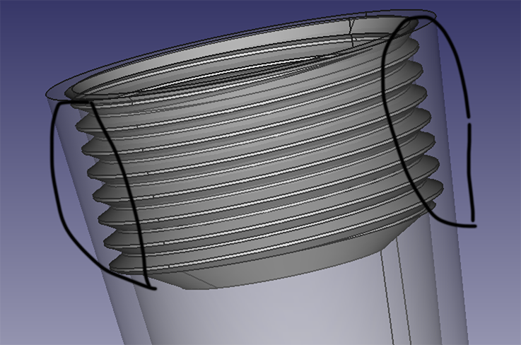

My goal is to add a female 3/4" BSPT thread at the top of a tube but I fear that the overlapping of the tube wall with the thread will create issues when printing (see pic).
What is the best way to create a thread inside a tube?
Thanks very much in advance!

Which 3d printing technology? SLA, SLS, FDM??
Why the thin wall?
Comments 1
Normal helical sweep thread can be used for internally i have tested it with FDM type printer it was good after 3d printing.( makerbot)
Comments 0
in PTC Creo there is an option to make internal thread using helical sweep
Comments 0
Create thread by helical helix profile....
