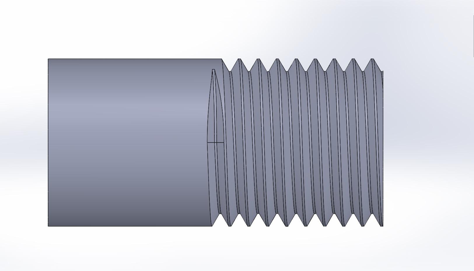

For years I've been struggling to find the best way to do proper thread runout on a physical thread in SolidWorks. For now, the quickest thing I have done is just a straight extruded cut, which looks decent enough, but isn't true runout. This technique doesn't work are all when adding a positive thread to the diameter. Instead, I get fancy with surfaces to try and clean up the runout.
Have any of you perfected a technique to make proper runout on both negative and positive threads?

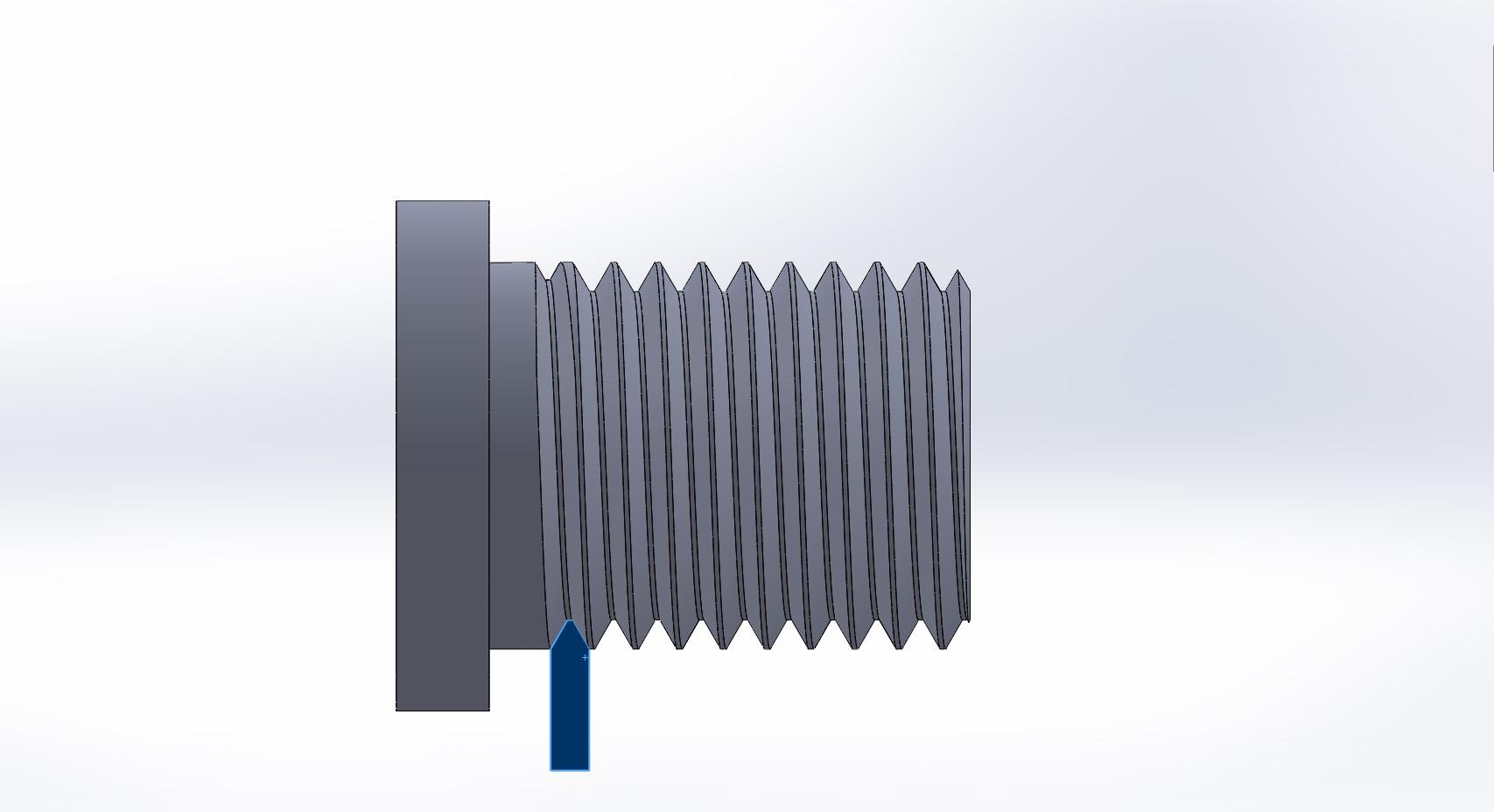

Hi Steven,
What I will tell you is not a refined technique, since I never tried to resolve the issue you raise. It is rather a reflection that may help you find the best solution:

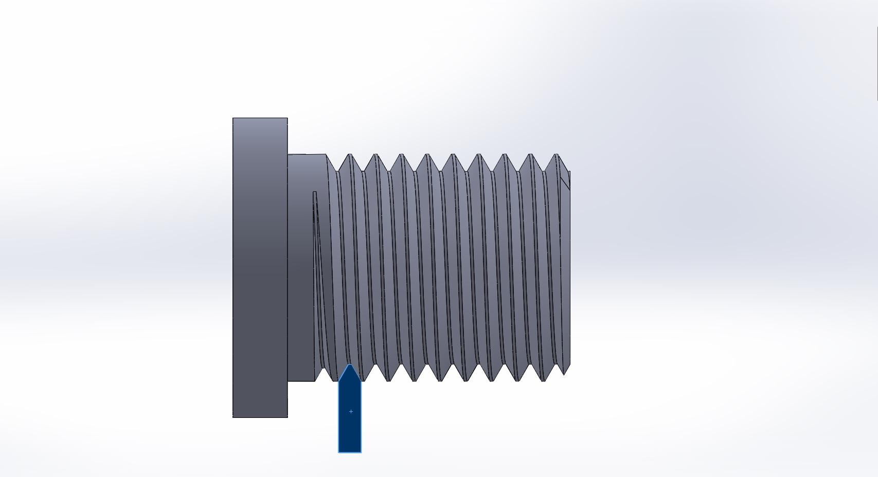

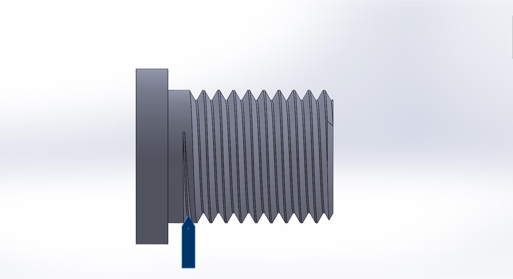

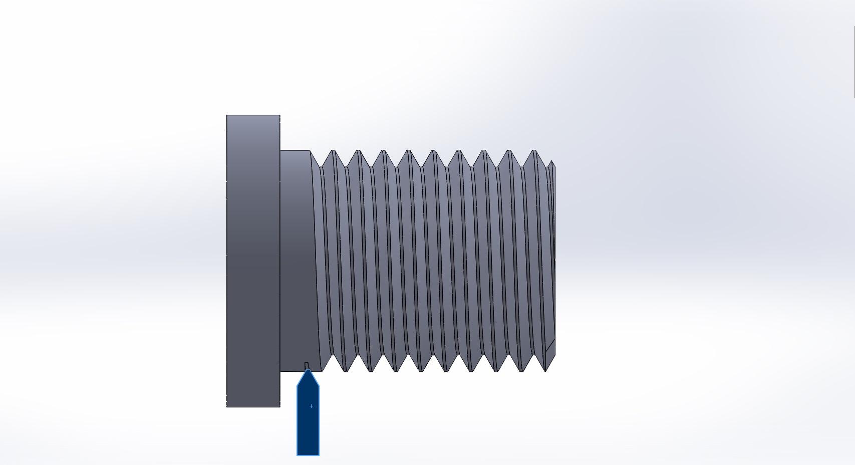

Remembering what I did in my youth when threading on conventional lathes, I think that "the cutting tool" followed its trajectory in a helix and, upon reaching the end, it was progressively withdrawn... with which, it ended up describing a new curve with the same pitch as the thread, but with increasing radii (like a spiral). In a quick test in SolidWorks 2020 I simply drew the fillet section in two positions (inside and outside the part) along "a quarter turn" (this is totally arbitrary) and drew a guide curve so I could apply a loft .
Maybe the idea will help you (comment what you finally achieve!)
Luck!
Marcelo
What J. Riend proposes reproduces the real practice of "moving away from the tool" during turning.

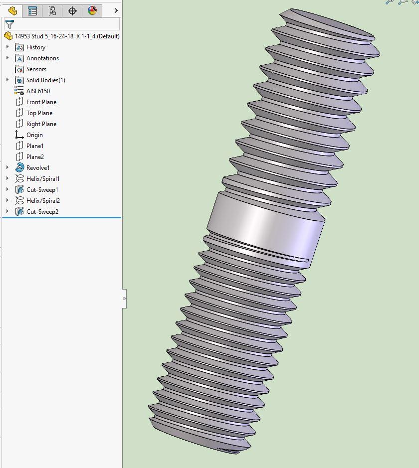

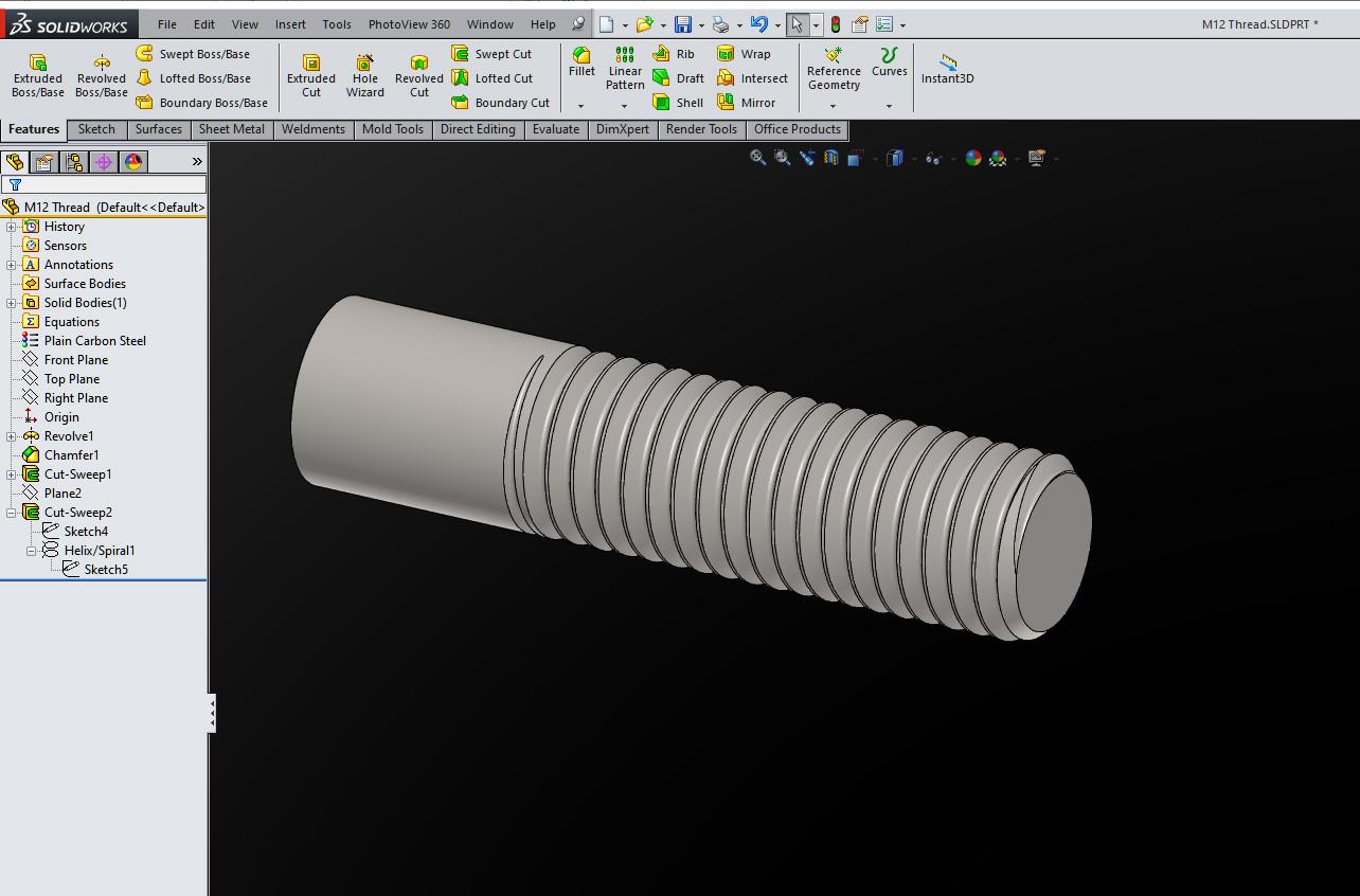

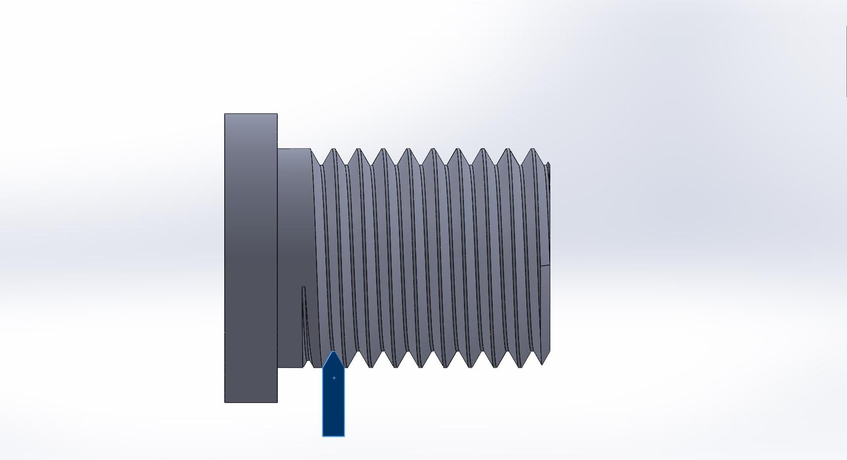

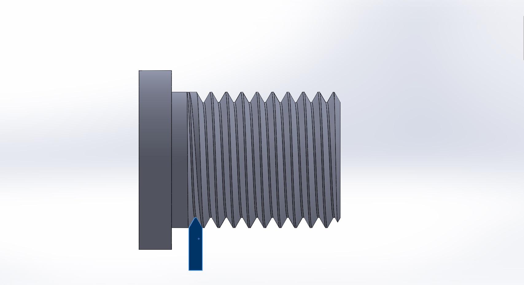

A quick way of modelling a thread runout in Solidworks is to use a tapered helix. I have made a little model to illustrate:
M12 Thread with Runout
Yup this is great
An approximation I use is; the Helix, Variable Pitch feature.
