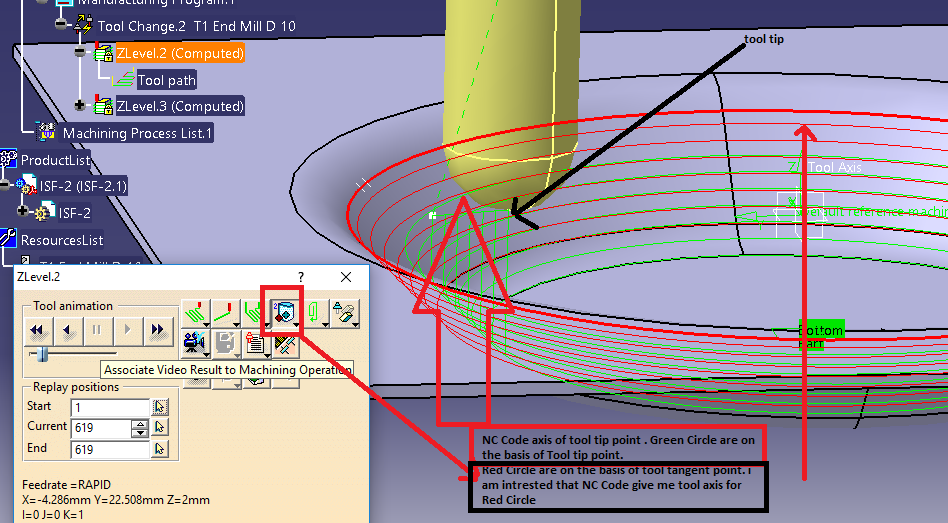

Tool Path for surface Machining in CATIA
I generated a tool path for surface Machining in CATIA, but it gives me a tooltip point when I generated NC Code. I am interested in the tool tangent point axis. How can I get x,y and z point for tool tangent point in NC Code instead of x,y and z point of tool tip.
The darwing picture is attached for clarification.
