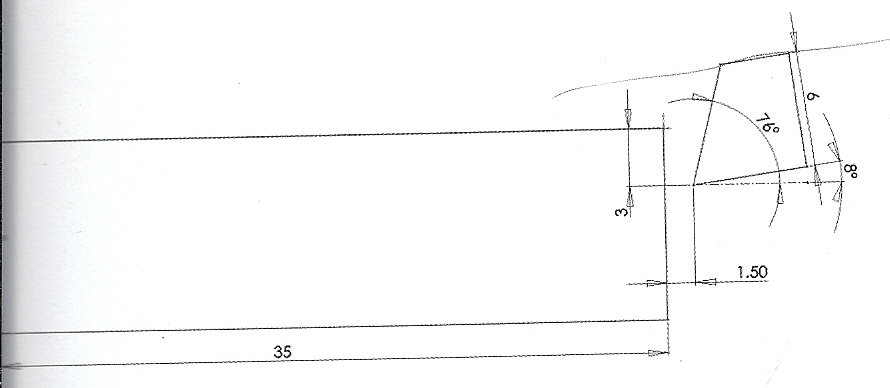

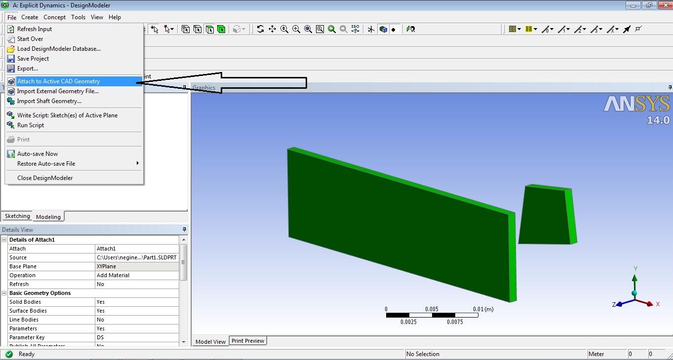

As i mentioned in the first of tutorial, input data is not correct. Because my purpose was to show you how to run simulation step by step, not getting correct answer. I should have spent more time to solve simulation with real figure which I did not have that time unfortunately.
My suggestion is to solve it in small area with real figure for example, analyze model after cutting 5 mm of workpieces otherwise you need to spend a lot of time to solve it.

<h5>just be aware of that the question input as if ( speed , time , dimension ) is not real it mean you can't use it as academic project . I just wanted to show you the processing of cutting tools simulation therefore you need to change input data to make it real project. For instance you can not find cutting tools with 200 m/s so the real figure for speed is around 5 m/s </h5>.

While doing analysis, give details of analysis setting please
Thank you sir. the tutorial was of great help. Butb in my simulation in m unable to see the chips deforming. the deformed chips are getting vanished from the sinmulation and red dots are visible only. where should i make changes to enable the deformed chips ??? plzz reply soon sir
