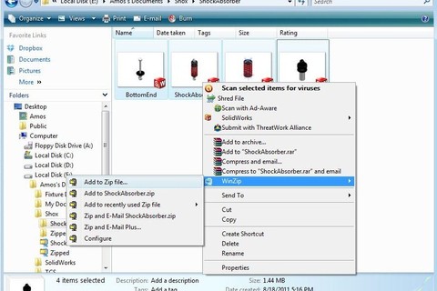

We often stumble upon files that look very interesting and wish to download and explore. We look at the software, and hey its the same stuff we use. Eagerly we download and open it, only to find out that the part file was missing. We downloaded an assembly file alone.
Now these are mistakes we have all done as beginners. This tutorial is mean't to make life a little simple for both the regular users and the newbies here.
8 Answers

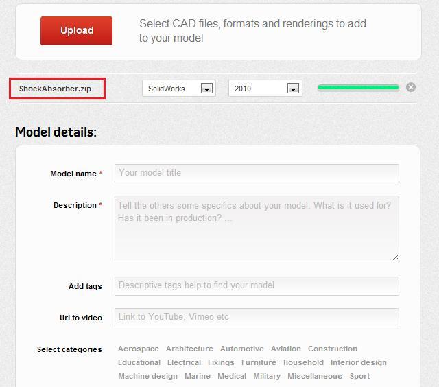

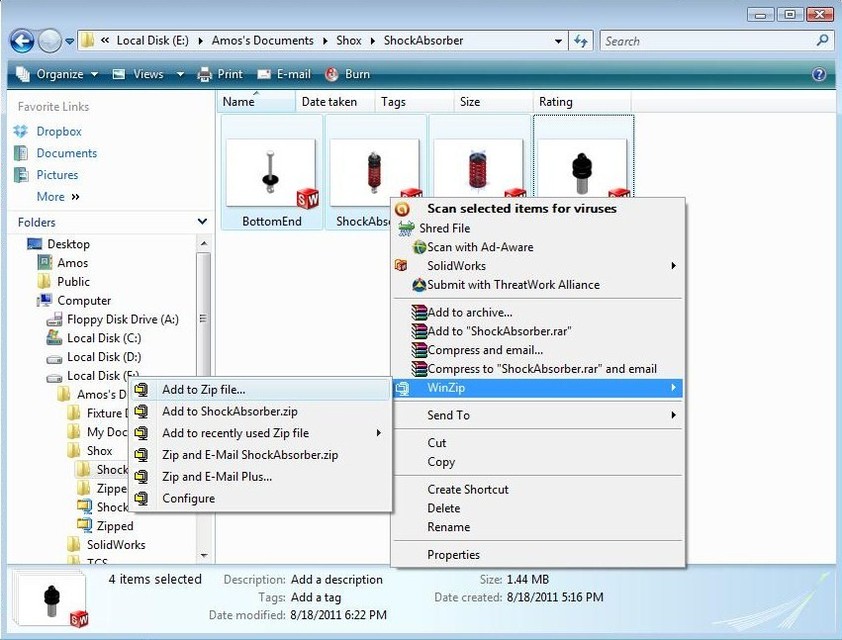

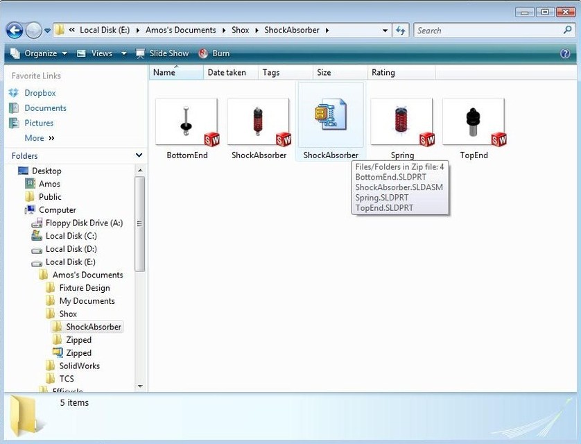

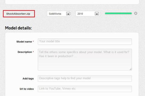

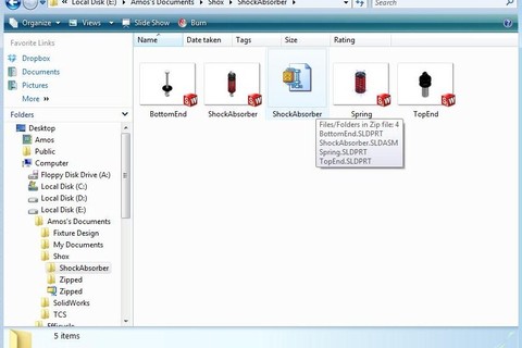

Firstly its important to understand that assembly files are all linked to the part files. These files do not hold all the information of the individual parts. When opened an assembly file searches for the part files linked to it and draws information from it. So in case you have uploaded an assembly file alone, the assembly doesn't get the info it needs and hence doesn't work!
The process is quite simple, but the aim of this tutorial is to make people realize how important it is to avoid making this error.
Answered with a tutorial: https://grabcad.com/tutorials/tutorial-how-to-upload-assembly-files-which-contain-more-than-one-part

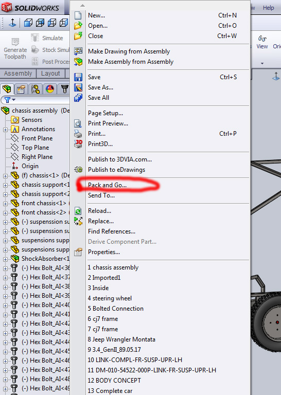

if all of your parts are not at same folder mean if you are using files from various folders then the best method recommended by solidworks is just
"Pack And Go" check the attachment picture and you also save it as zip file
Both methods work, there is also a Pack and Go in Inventor, this is probably the best method for ALL programs if your using library parts located in either another folder, on a server, or different HD.
To do this in Solid Edge use the Revision Manager to make a copy of all the files into one folder and then zip the folder.
