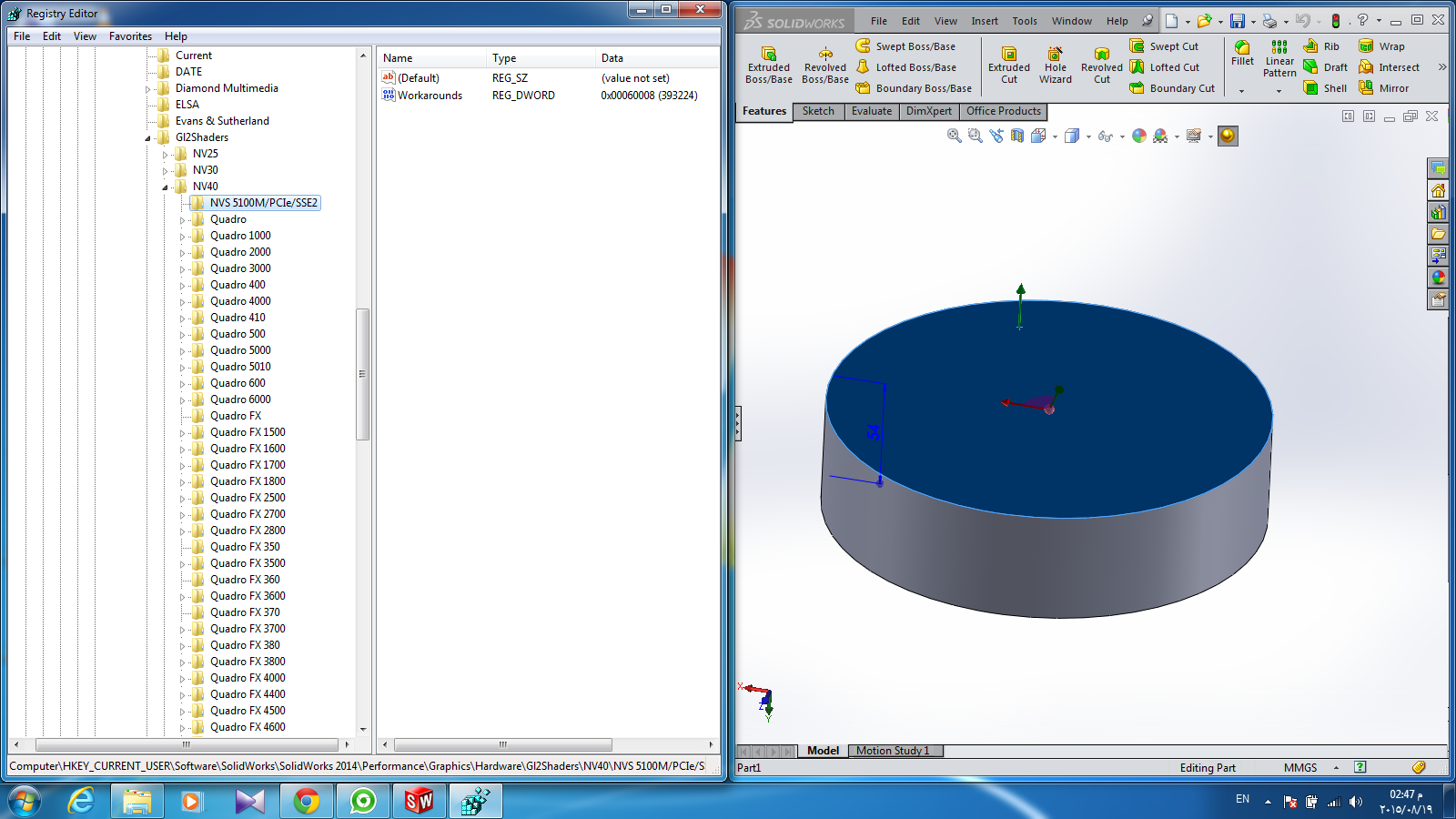

plz help with NVS5100m
it works with almost GeForce
but what about NVS
plz help
