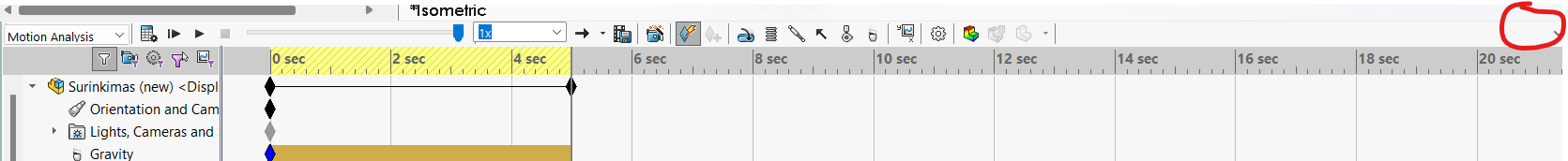

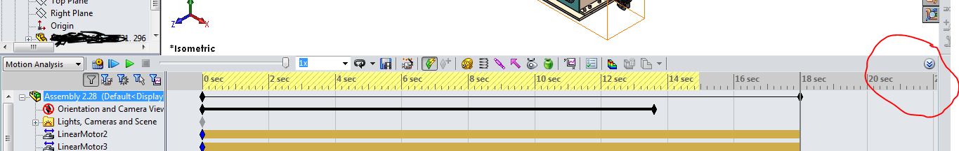

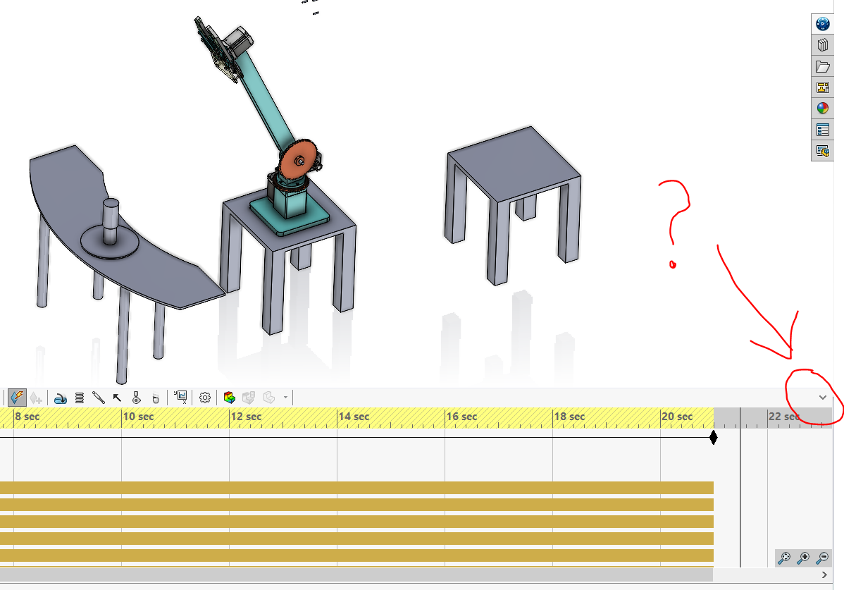

Dear all,
I've tried all your suggest like turn on the add-ins, and change the motion study type, but still can't access the event based motion feature.
Hello, maybe someone already figured out how to enable event based motion view? because I have the same issue
