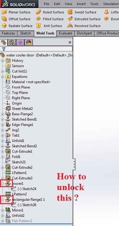

unlock ? kaiwei 31 Aug, 2015 01:03 AM what is this? can unlock ? unlock.jpg 1 Answer Yahya T Khedr Answered on 12 Feb, 2019 07:10 PM That's because forming tools made before SW 2012 have a lock icon and aren't accessible in the Form Tool Feature. You'll have to delete it, then make both the louver & flange again.
