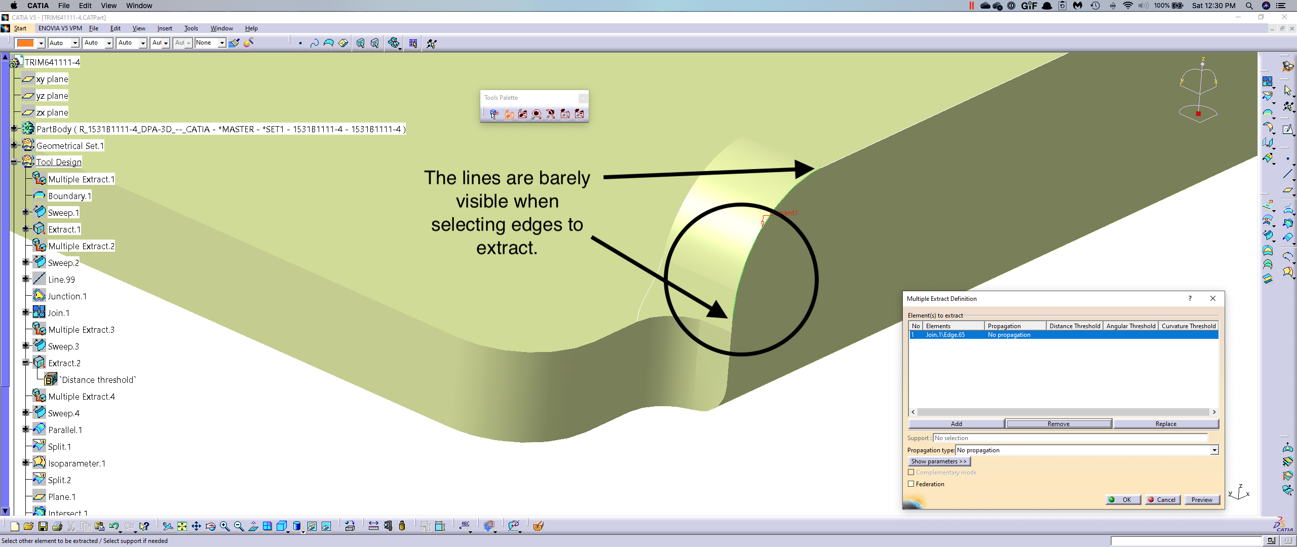

Is there a setting to increase the thickness of lines on edges when extracting? The green lines are so small its sometimes hard to see where they end. It's the same with the white lines after extraction.

Thanks Ananth, Here is a pic.

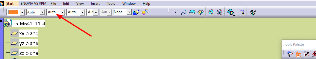

1. [Ref 1.png] The selected drop down list controls the thickness of lines, edges. By default catia has second line thickness. Now select an edge, then select your suitable thickness.

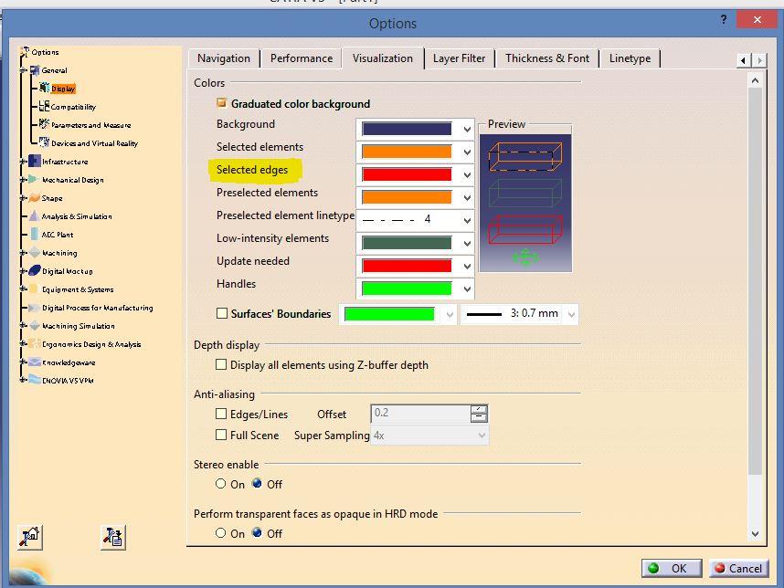

3. [Ref 3.JPG] In case if you wish to change color of selected edges or any surface etc., go to Tools > Options > General > Display > Visualization.
Hope this solves problem.
Thank you Ananth. My lines don't seem to change thickness with the drop downs but using the other views you recommended does help.
