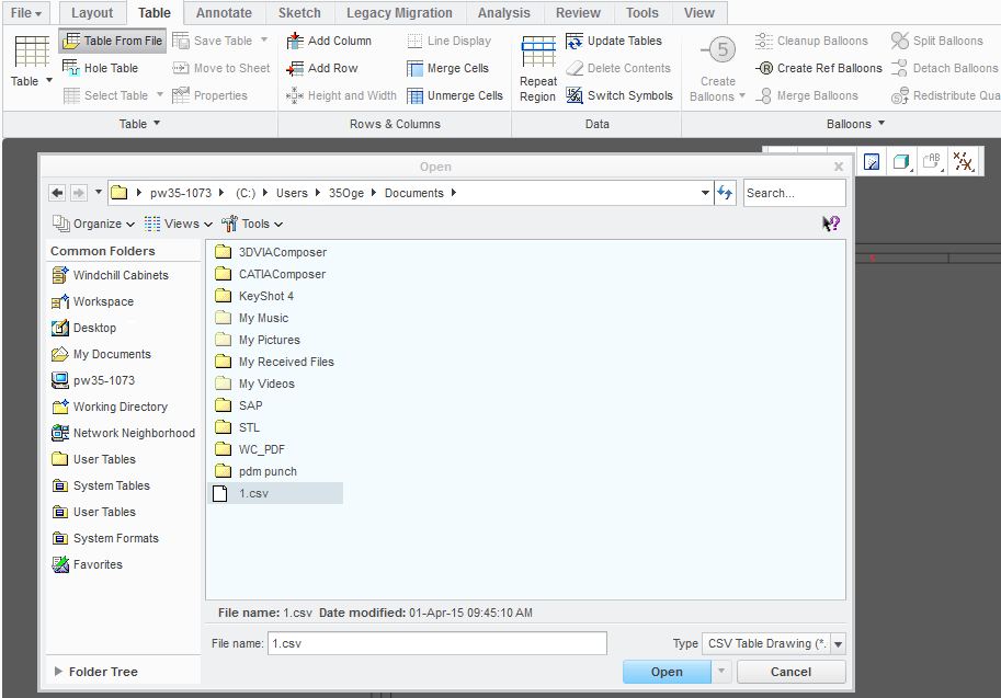

what about importing table from excel to a drawing .....? is it possible?
if it is possible...how can I import a table from excel to a drawing in creo parametric?....can anyboy explain me ?
2 Answers
Save the excel file as a CSV file.
Then in the Creo drawing..
Select the Table tab.
Click the Table From File
In the Open dialogue box change the type (lower right) to CSV
Browse you way to the file and select it the hit open (or double click)
Then you can drag the table on the drawing and right mouse click to place
