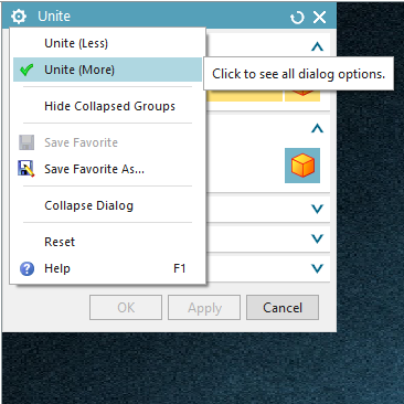

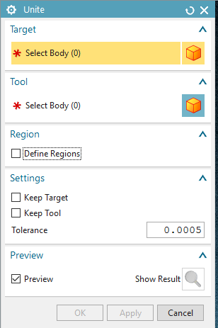

I'm trying to unite the inner body with the outer one. But the moment i unite, the inner body get trimmed.
movie.avi ERROR.mp4
cmalco
cmalco
Answered on 28 Aug, 2019 11:15 AM
Make sure "Keep Target" & "Keep Tool" are unchecked.
You'll need to set your Unite fly-out to "more options" to see these. When in doubt, always check the expanded options.
unite_expanded_list_more.PNG unite_expanded_list_more.PNG unite_expanded_list.PNG unite_expanded_list.PNG
