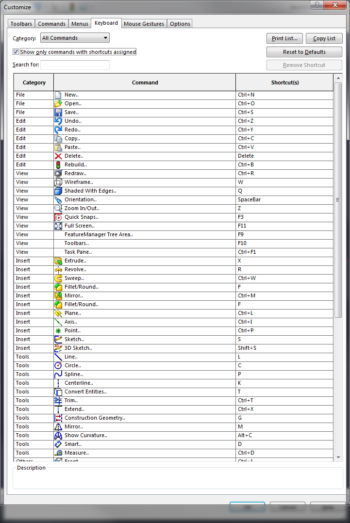

What kind of shortcuts do you use while CADing?
And what kind of keys have you bound for them?
For example, i use:
smart dimension = ctrl+shift+D
centerline = shift+L

smart dim D
measure ctrl-D (because it's very similar to dim, and D stands for distance)
centerline K (it's right next to L for line)
Forget about the default shortcuts and make your own. Everyone uses different tools for different reasons and everyone has their preferences so everyone should have different shortcuts.
All your most used commands should be one letter. After you've used up all the letters and numbers, then go to key combinations with alt, ctrl, shift. You should have a 5 button mouse with ctrl alt shift on the mouse so that you hit one key on the keyboard and the other part of the combo on the mouse, it's faster that way. Right thumb hits ctrl by touch then left finger hits the keyboard, that way you are looking for just one key on a combo.
