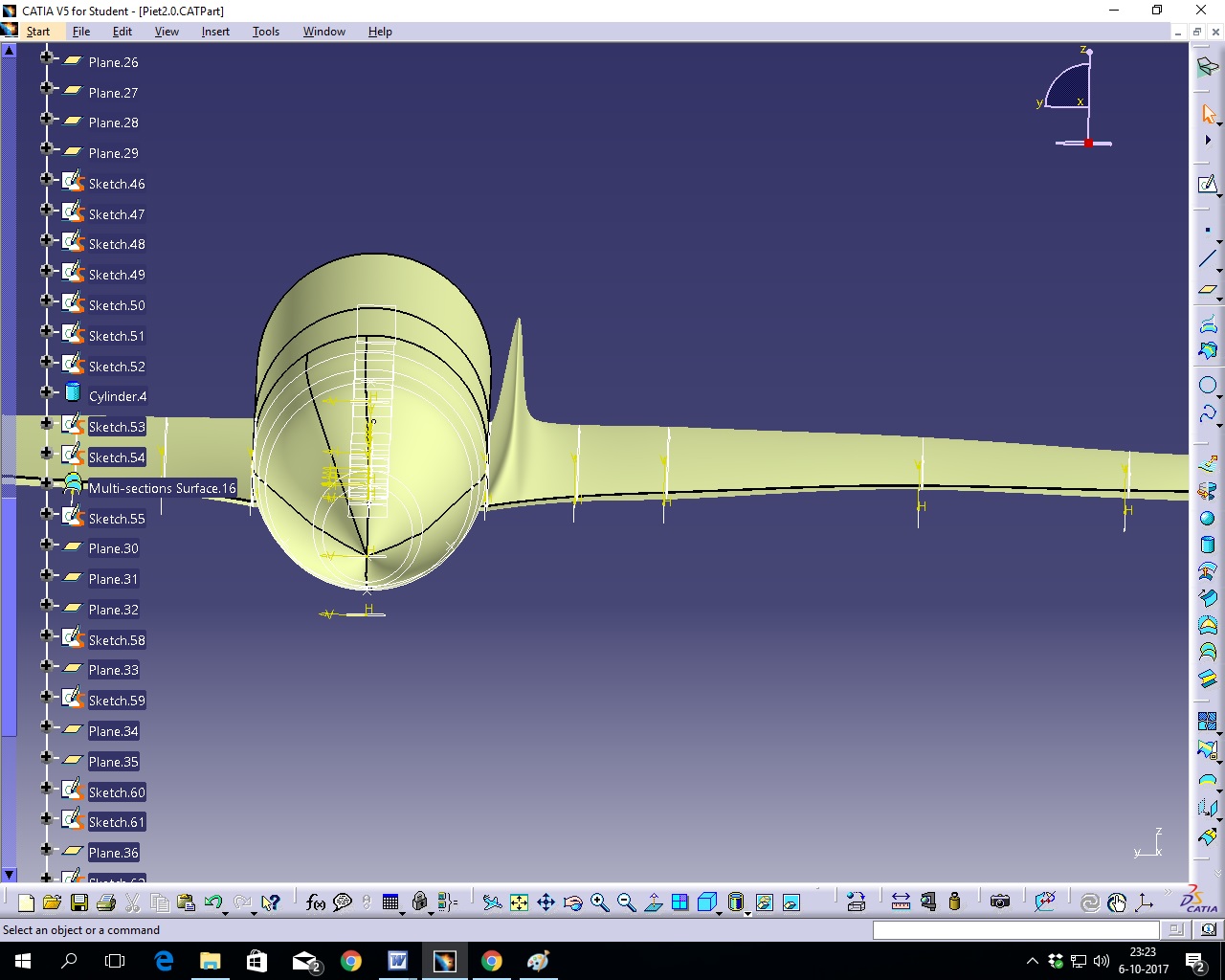

Why does this happen? felix schoonhoven 11 Oct, 2017 01:10 PM I am working on a project and i have a weird bump. What did i do wrong? hjdfslahjklasf.jpg 2 Answers özgür kesebir Answered on 11 Oct, 2017 04:10 PM I guess the reason of that bad tangecy continutie. try to change position of section. Jack K Answered on 11 Oct, 2017 03:30 PM Based on all the information that was provided, my guess is there's an inverted direction vector somewhere in the Multi-Section Surface.
