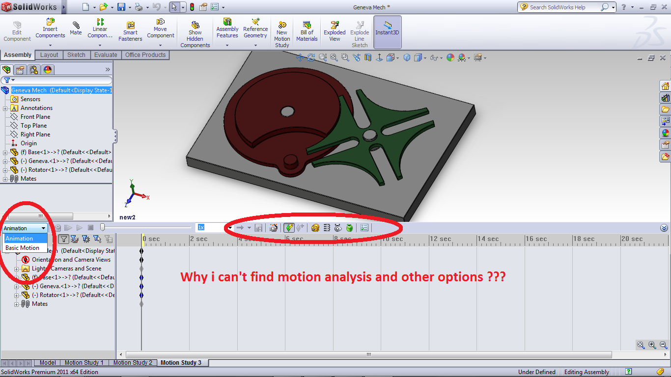

Why i can't find motion analysis??
I want to do motion analysis; but i cant find it.!
nether more options are available.
Plz help me in the matter.!

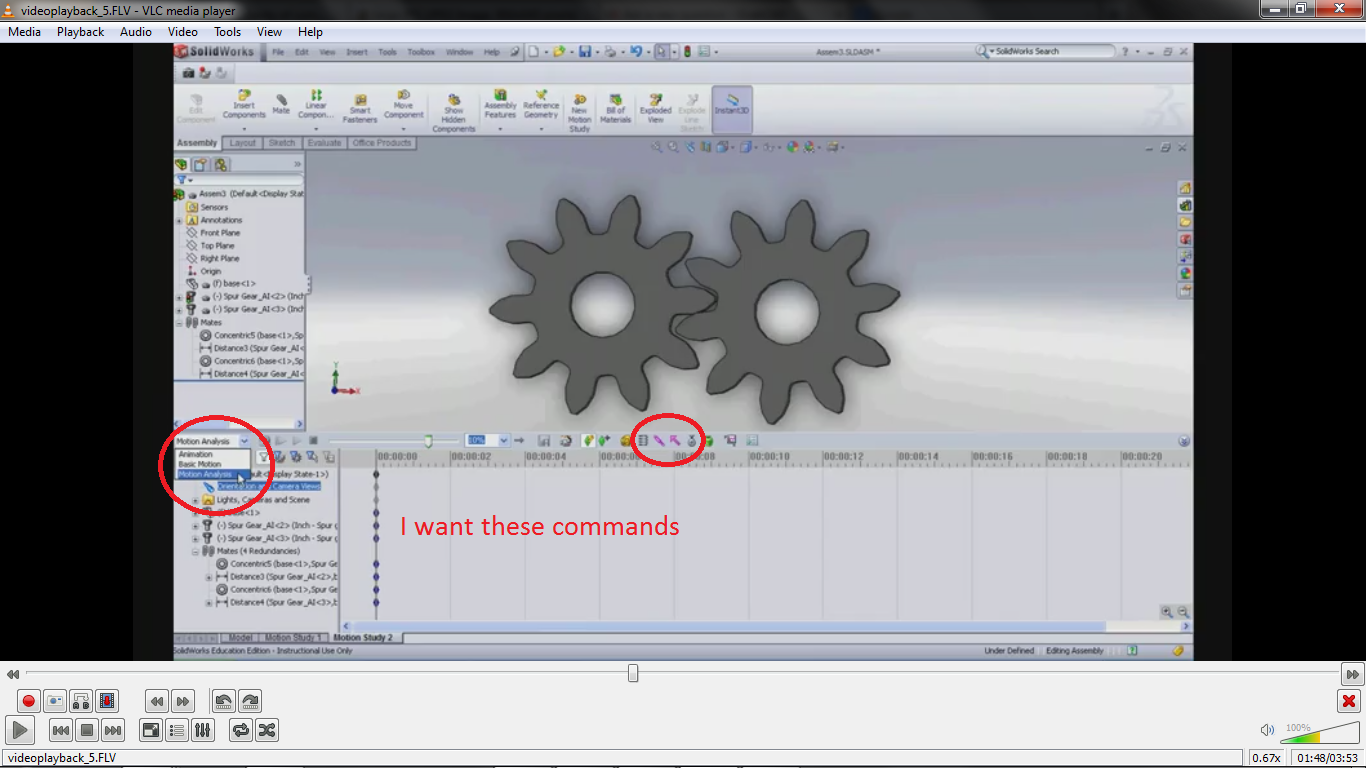

i had attached another picture.
i want these extra commands with mption analysis.

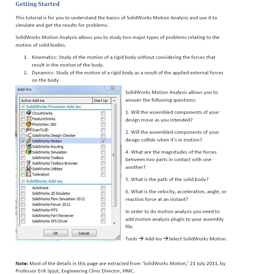

Motion analysis is only available as an add-in bundled with SolidWorks Premium. If you have the Premium version and still don't see it, turn it on by going to Tools > Add-Ins. http://help.solidworks.com/2013/English/SolidWorks/motionstudies/c_Motion_Analysis.htm
http://help.solidworks.com/2013/English/solidworks/sldworks/t_add_ins.htm

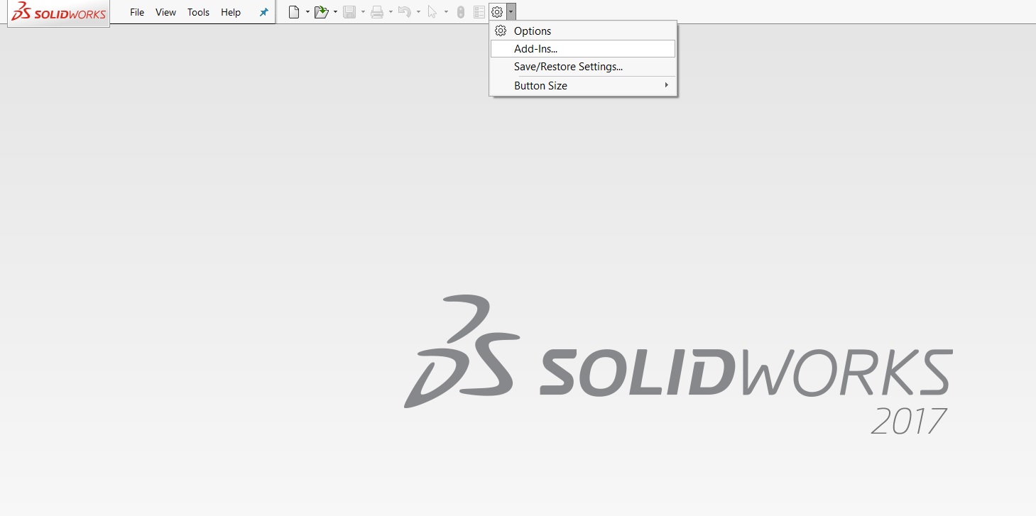

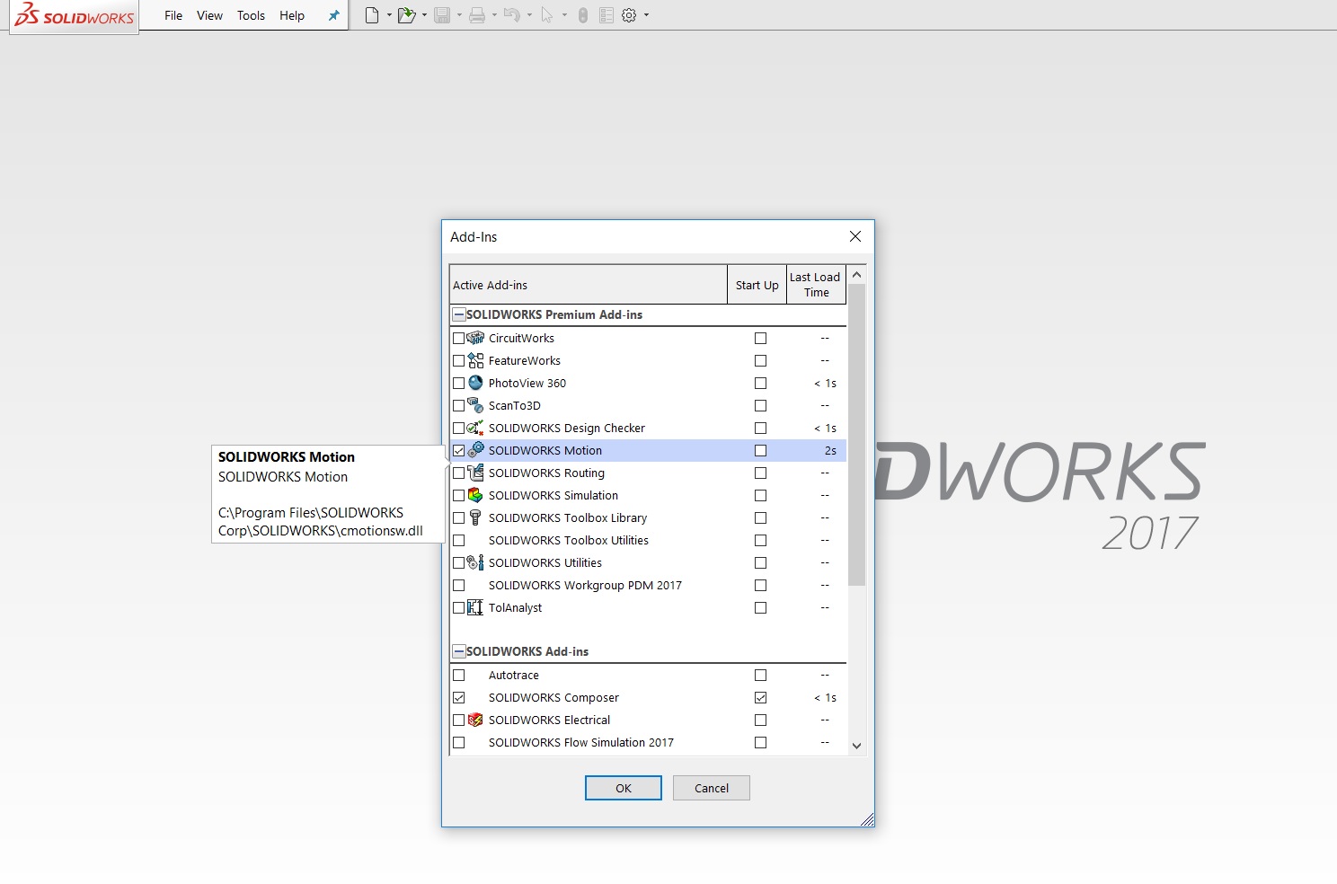

Check The Add-ins
step1: go to add ins
step2: tick SOLIDWORKS Motion and press OK
