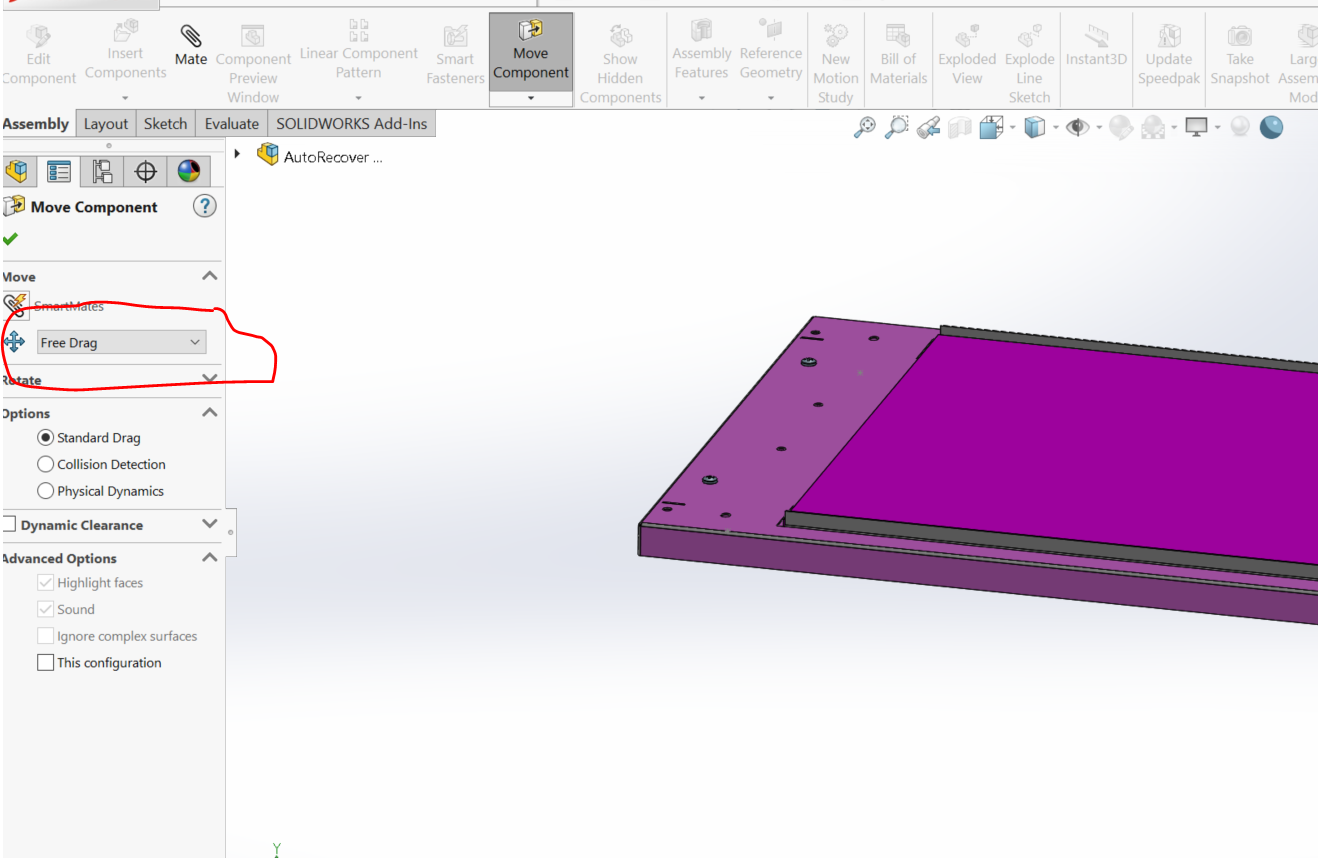

If you select the 'Move component' command you can toggle between 'Free drag' and other options that will allow you to move parts around on axis or planes.

Yes, it gets trickier between drag and rotation of the part in Solidworks assembly. Use "Move Component" and "Rotate Component" to get free drag or free rotation only.
To say that this option won't let you use arrow keys to move part. Arrow keys are there to change the angle of view only in Solidworks.
