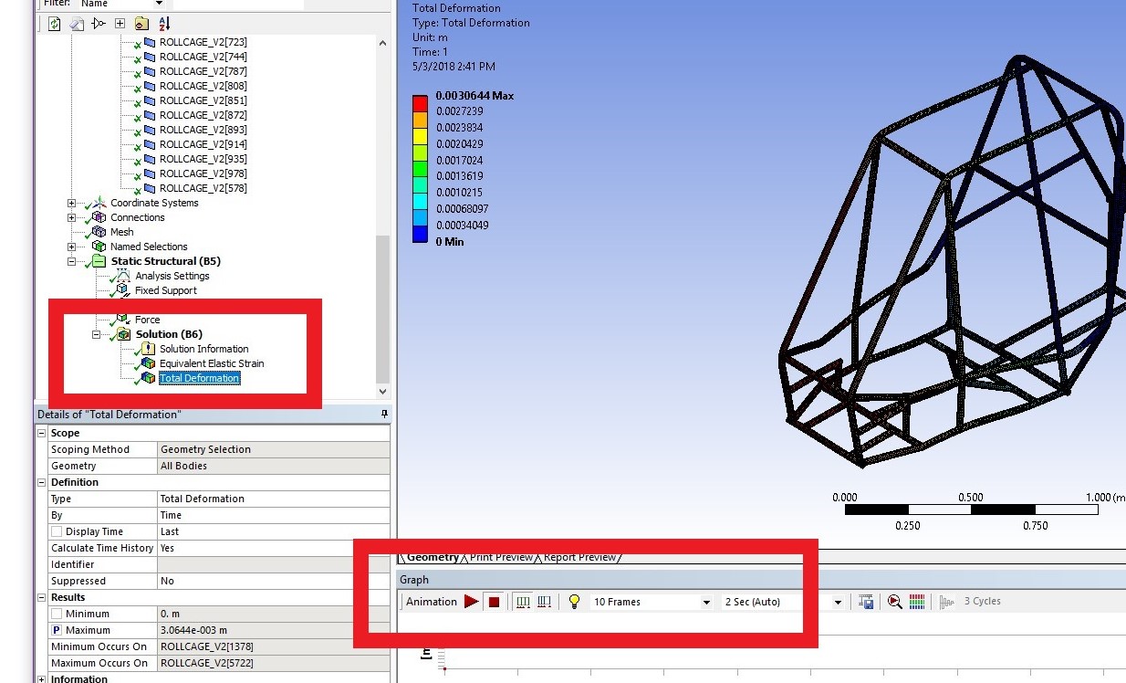

Step 14: Calculate for Von Mises stress and max deformation
Next determining which parameters to solve.
Select “Solution”> “Deformation”> “total”
Select “Stress”> “Equivalent (von mises)”

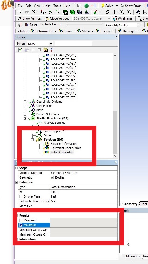

Step 15: Check Parameters
check parameters for Maximum under results for both “Equivalen Elastic Strain” and “Total Deformation”
Step 16: Begin solving FEA
click “solve”. Mesh Status will pop-up.
Step 17: Animation of Result
toggle between “total deformation” and “Equivalent Elastic Strain” and animation for visuals.
Step 18: Check out Result bar
use Result window bar to locate maximum and other features.
Step 19: Parameter Set
Back to ANSYS WorkBench select “Parameter Set”
Step 20: Numerical value FEA
From step 15, we activated the parameters for Maximum displacement and Stress in this window we can see the numeric values.
