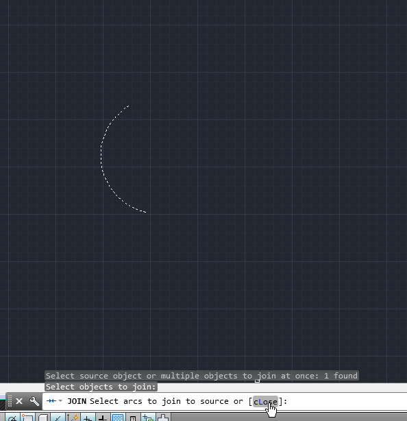

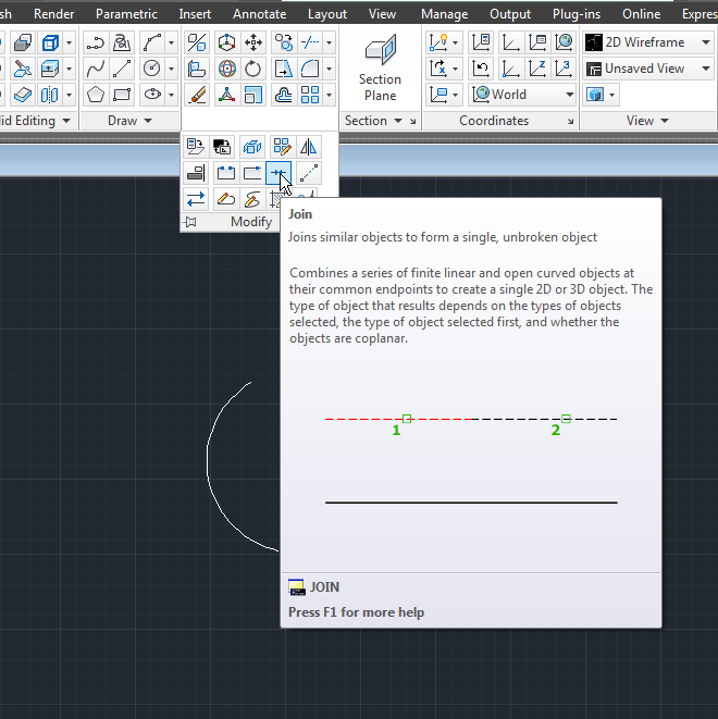

Use "Modify" tab then select "Join" Command, click on end of arc then "Right Click" and "Close" command will appear, Click on "Close" and the Arc is converted to a Circle.

    Go to "Modify" Tab select the "Join" command

    Click on one end of Arc then "Right Click" and "Close" command will appear, click on "Close" command.
  4. Step 4:
    The Arc is then converted to a Circle
