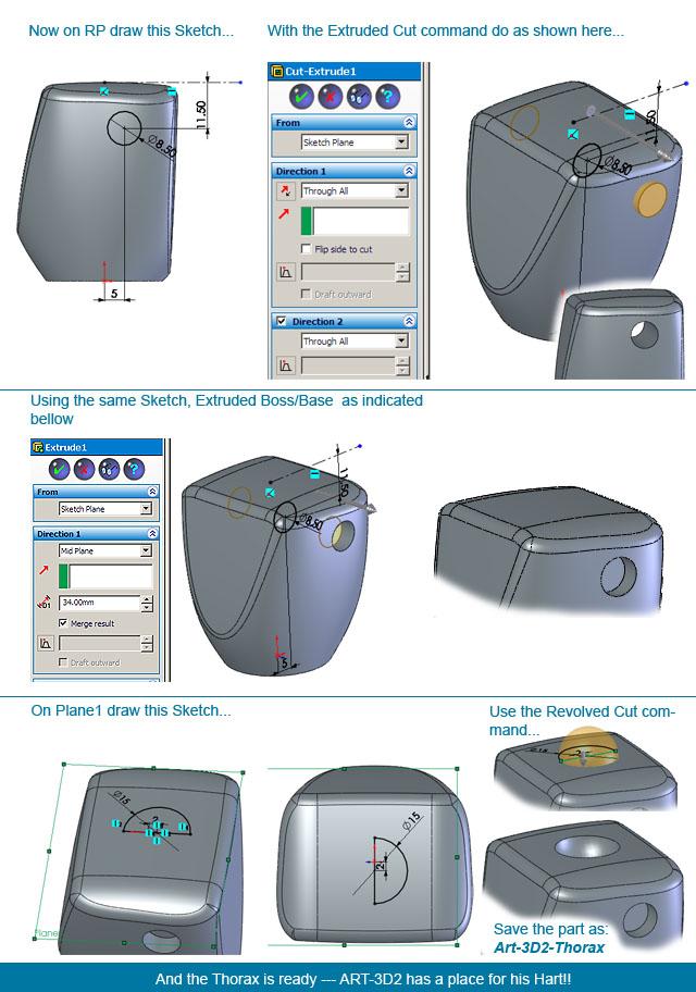

This was a personal project of mine.
To model a mannequin in 3D so that it could be used for ergonomic studies, illustrations, marketing, graphic instructions, etc.

Step 3: The Thorax...
Step 4: More on the Thorax...
Step 5: Surfacing the Thorax...
Step 6: Trimming the Chest...
Step 7: And the Back...
Step 8: Cutting the Top of the Thorax...
Step 9: Closing & Solidifying the Thorax...
