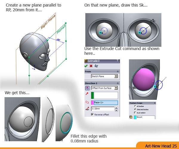

New Head for Art-3D-2
This is the modeling of a new head for our dear Art-3D-2.
You will learn a lot of Surfacing tricks.
You can see the hole Art-3D-2 tutorial here:
Art-3D-2
Enjoy

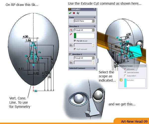

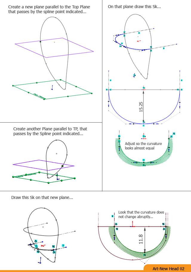

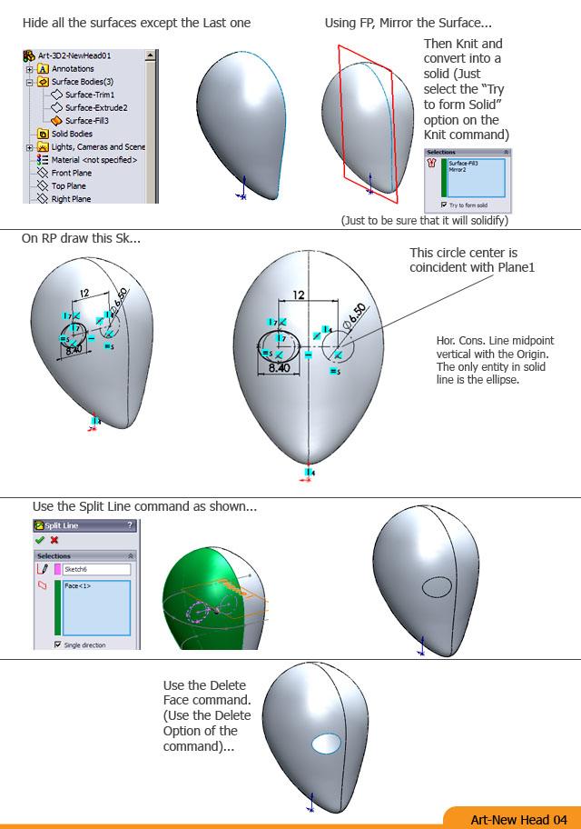

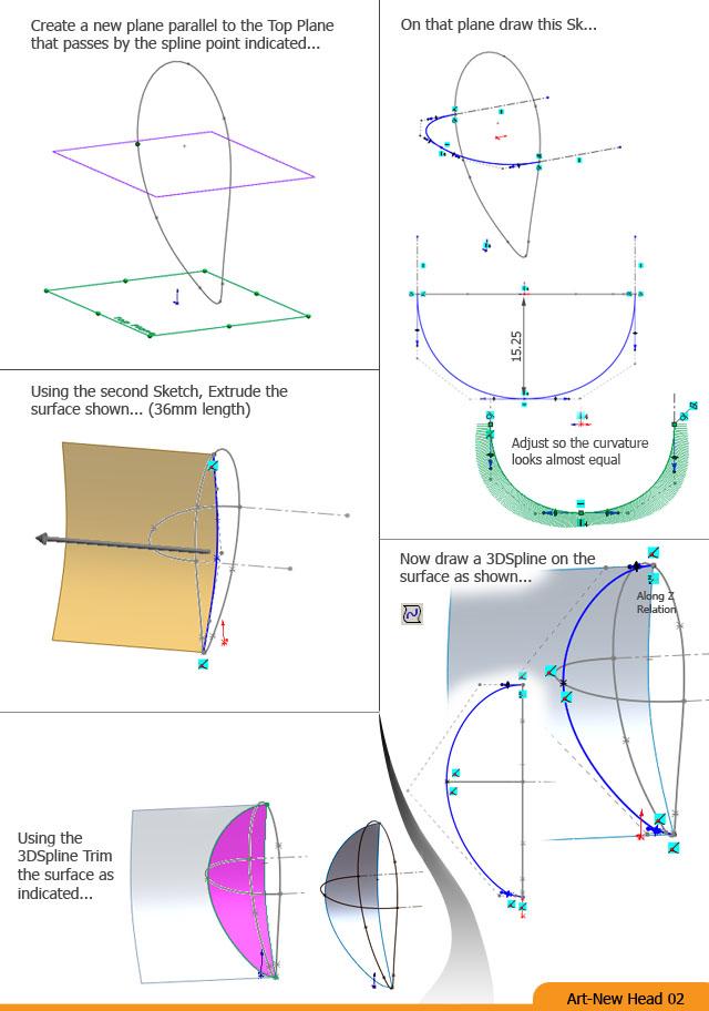

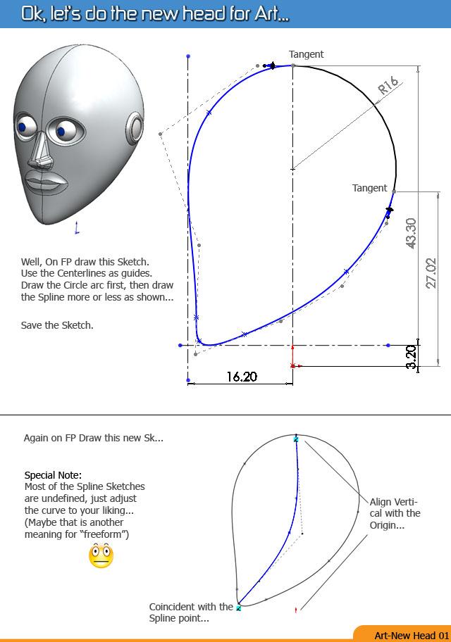

  1. Step 1: First Sketches for the head...
  2. Step 2: Planes and Profiles...

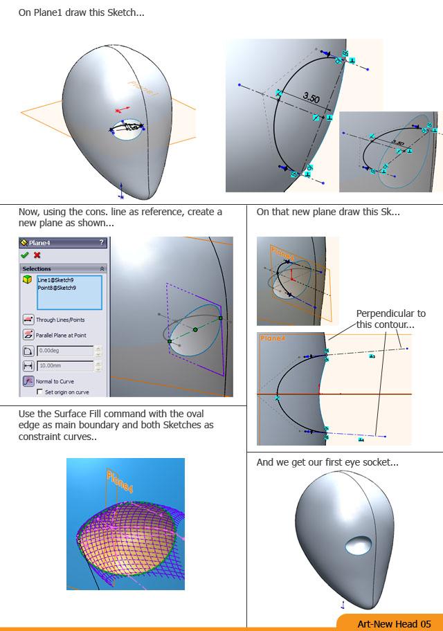

  3. Step 3: Auxiliary Surface...

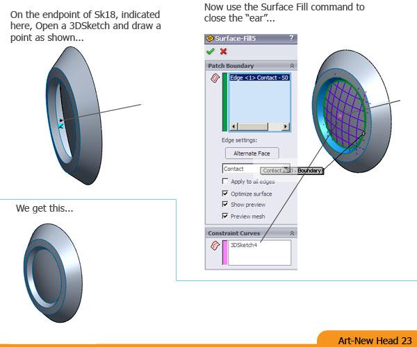

  4. Step 4: Surfacing with Surface Fill Cmd...

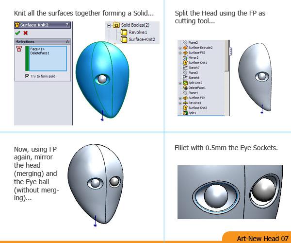

  5. Step 5: Mirroring & Eyes Socket...

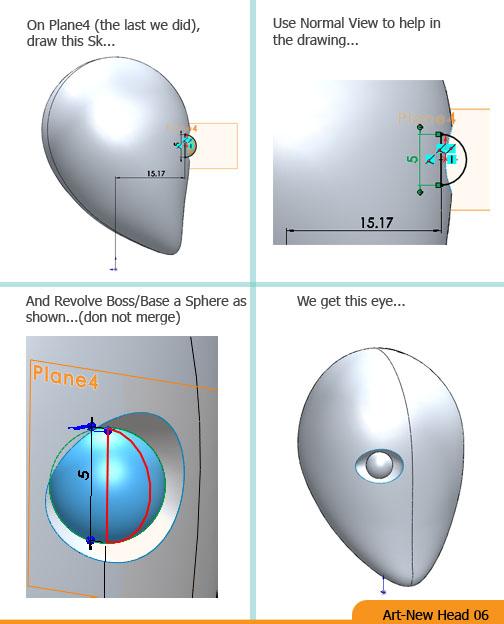

  6. Step 6: Eye Socket...
  7. Step 7: Eye Ball...
  8. Step 8: Mirroring Eye Balls...

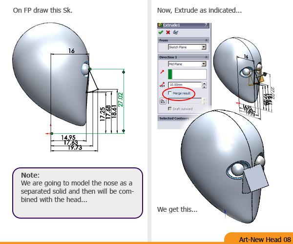

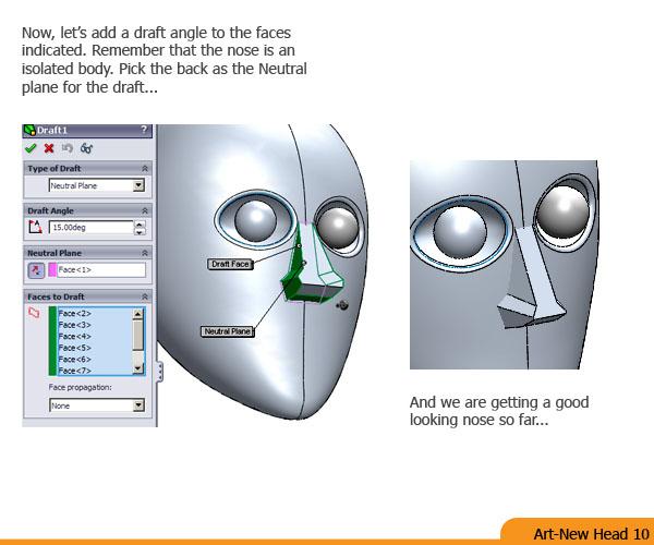

  9. Step 9: Nose...
  10. Step 10: More on the Nose...
  11. Step 11: More...
  12. Step 12: Refining the Nose...

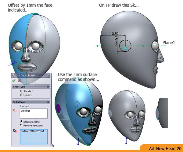

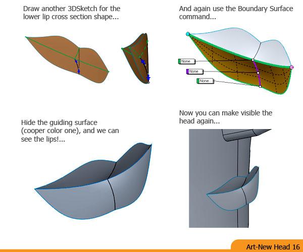

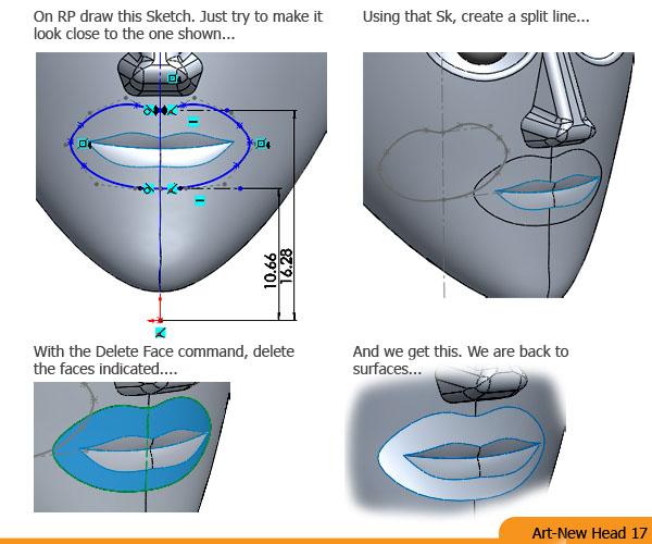

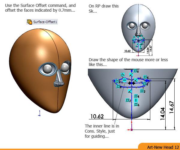

  13. Step 13: Offsetting for the Lips...

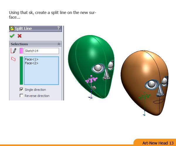

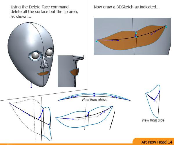

  14. Step 14: Splitting the Lips...
  15. Step 15: 3D Sk for corner of mouth...

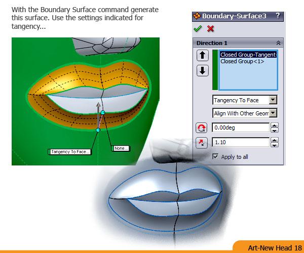

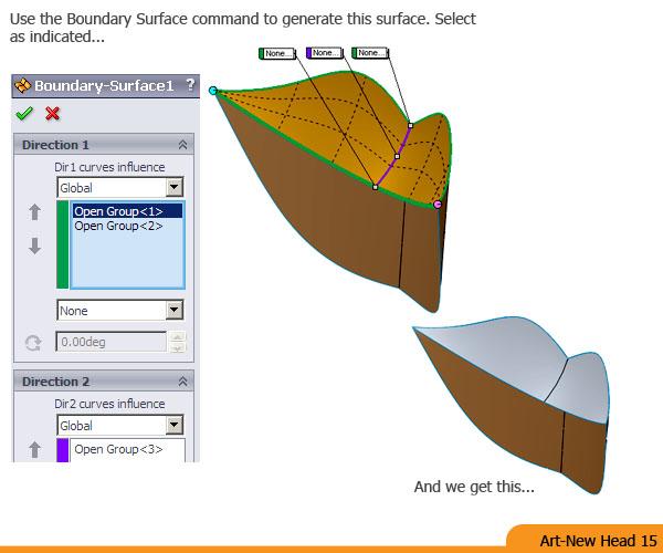

  16. Step 16: Surfacing the Lips...
  17. Step 17: Surfacing Lips (Final)...
  18. Step 18: Modeling around the mouth...
  19. Step 19: Surfacing the surroundings of mouth...

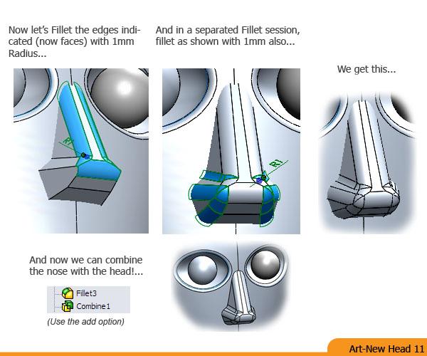

  20. Step 20: Filleting Nose...
  21. Step 21: Ears (Preparation)...

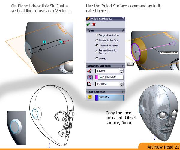

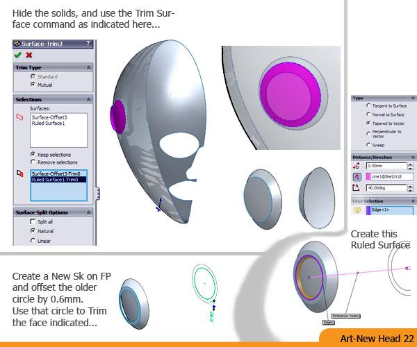

  22. Step 22: Rule surfacing...
  23. Step 23: Shaping the Ear...
  24. Step 24: Ear's Inside Surface...

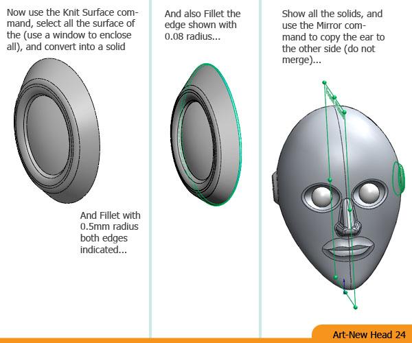

  25. Step 25: Ending the Ears...
  26. Step 26: Modeling the Pupils...
  27. Step 27: Socket for the Nest...

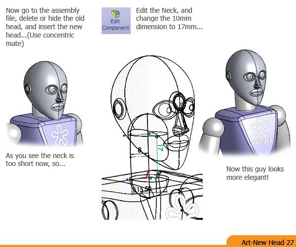

  28. Step 28: Assembling the New Head...
  29. Step 29: Rendering!...Look Nice!!
