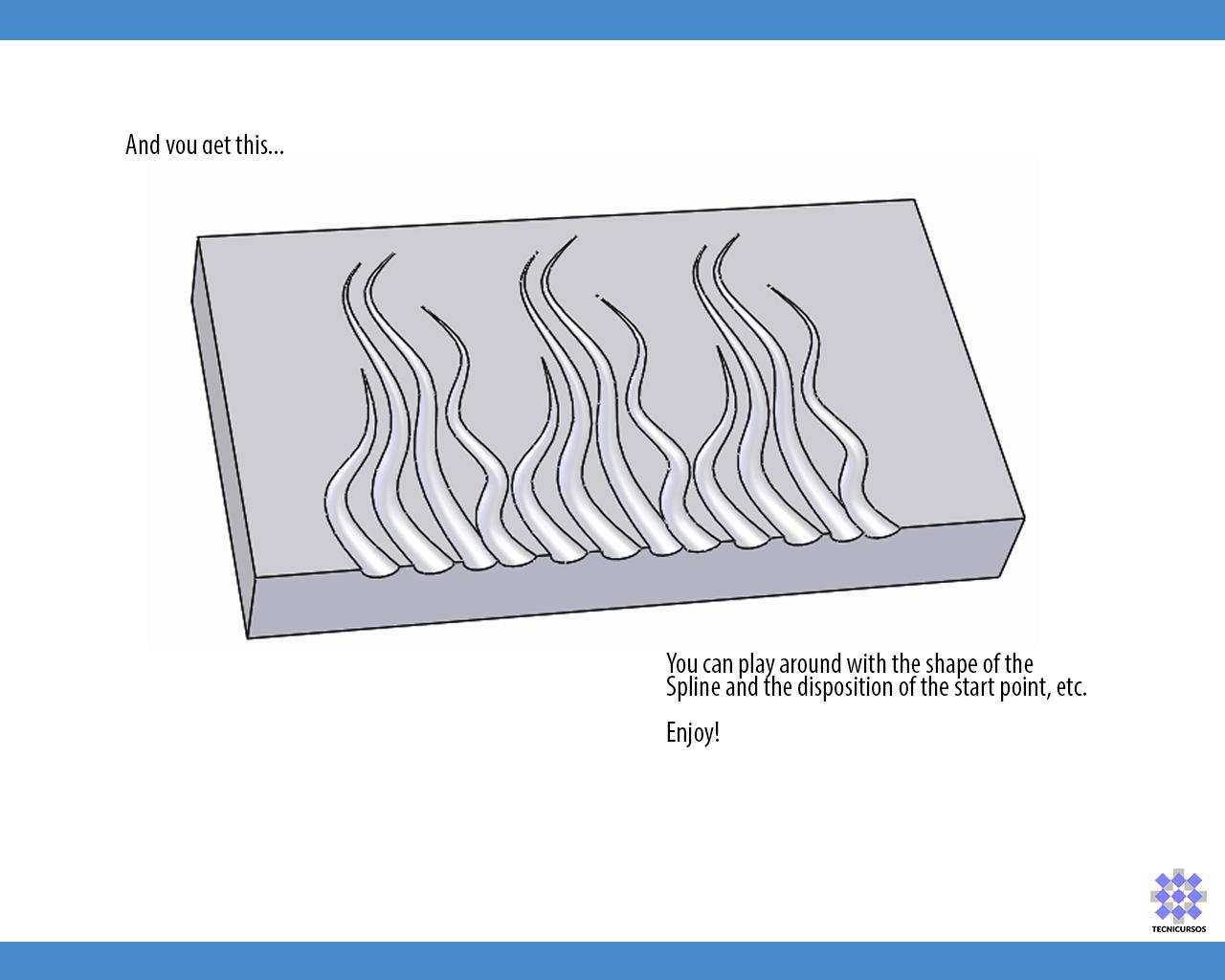

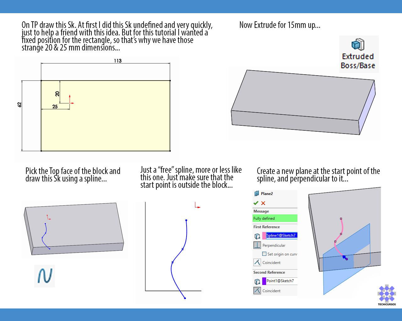

  1. Step 1: First: the Block...
  2. Step 2: Cutting with Loft...
  3. Step 3: Final Result... (Please experiment!)
  4. Step 4: Some rendering...
