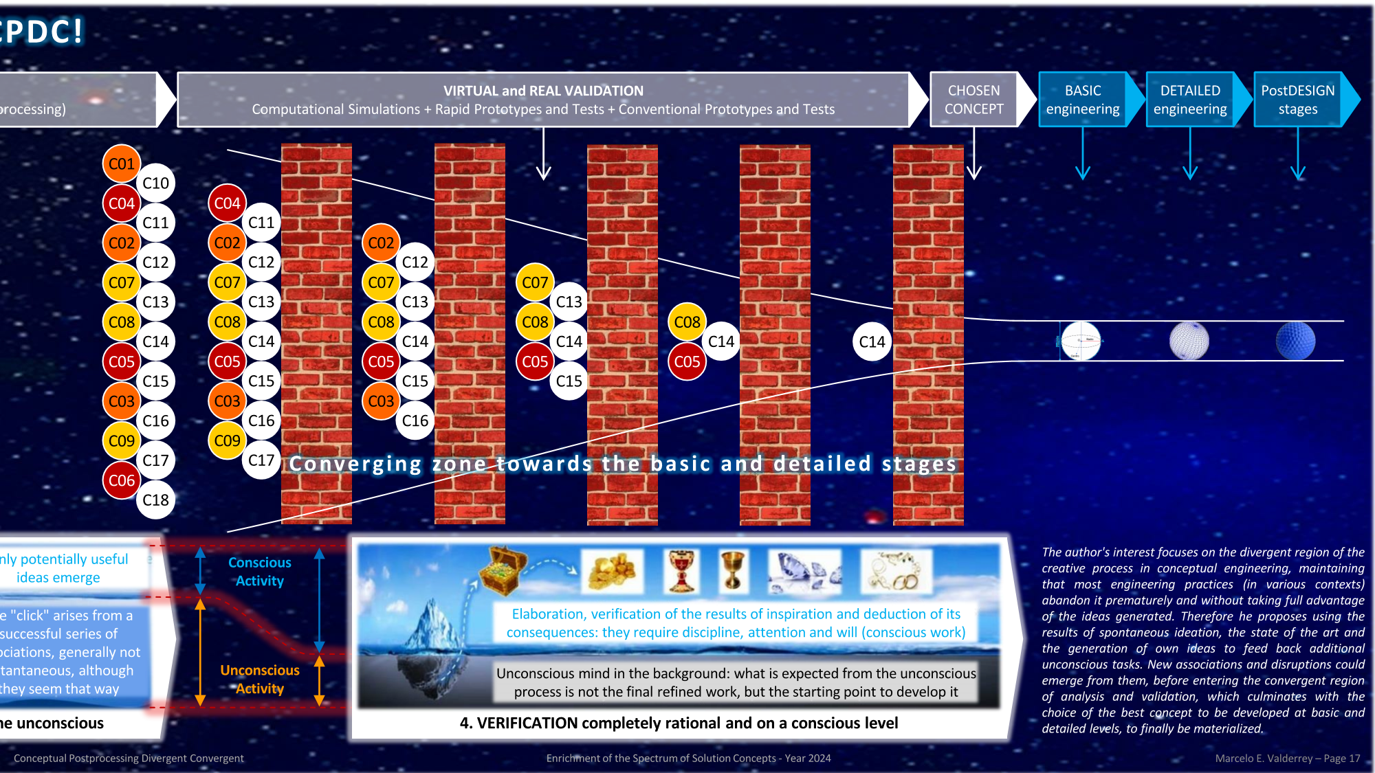

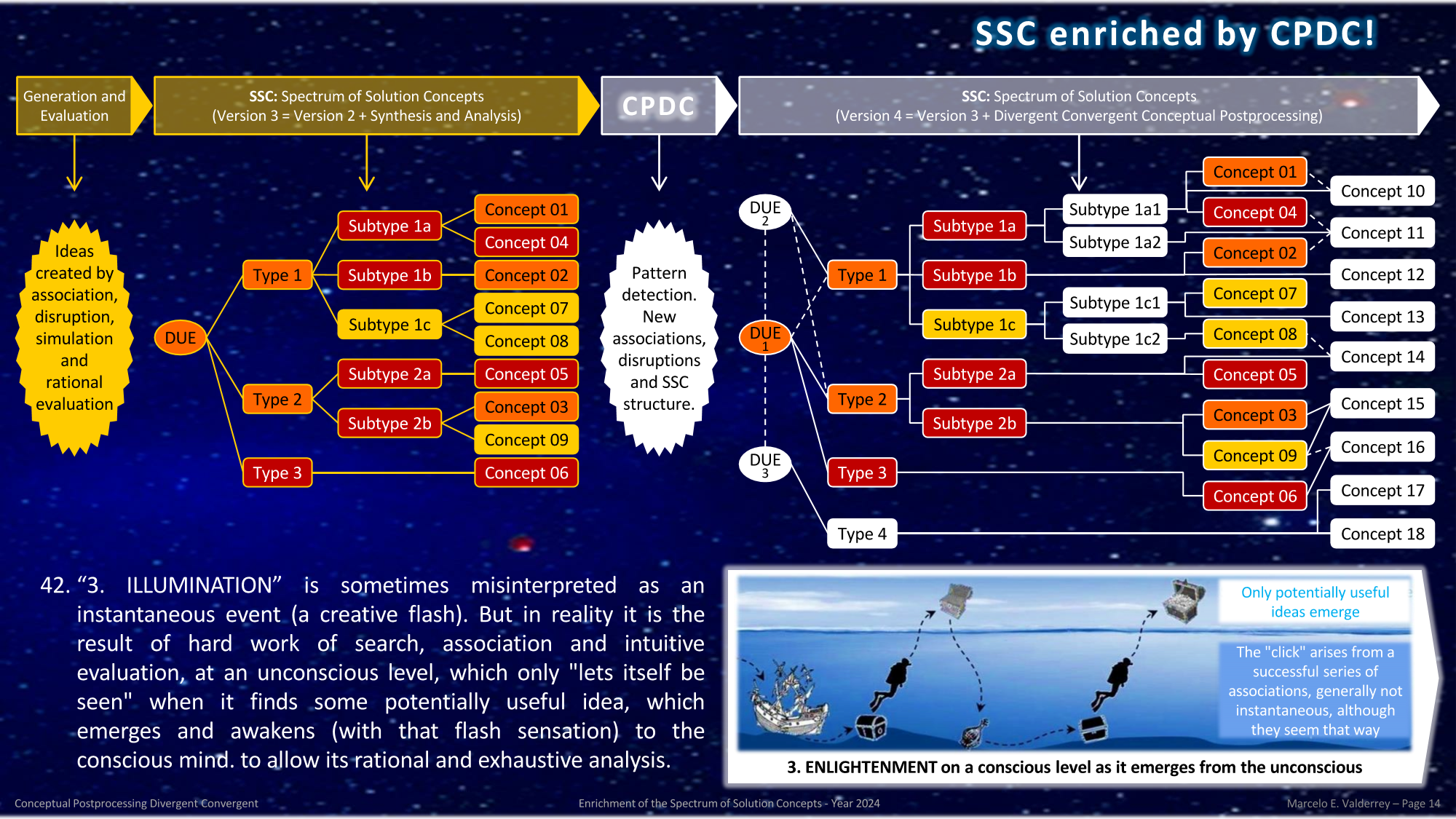

This tutorial describes a relevant task within the conceptual engineering process that consists of post-processing the SSC (Spectrum of Solution Concepts) to understand and classify the solutions achieved, and deepen the learning of the problem.
Its objective is to obtain new solutions, either by association of pre-existing ones, by the discovery of conceptual omissions or by a crisis of ideas and paradigms that induces the breaking of molds and the appearance of disruptive concepts.
In order to properly contextualize this task, all the milestones of the conceptual stage are reviewed, highlighting the moment in which the CPDC is executed and glimpsing its relevance.

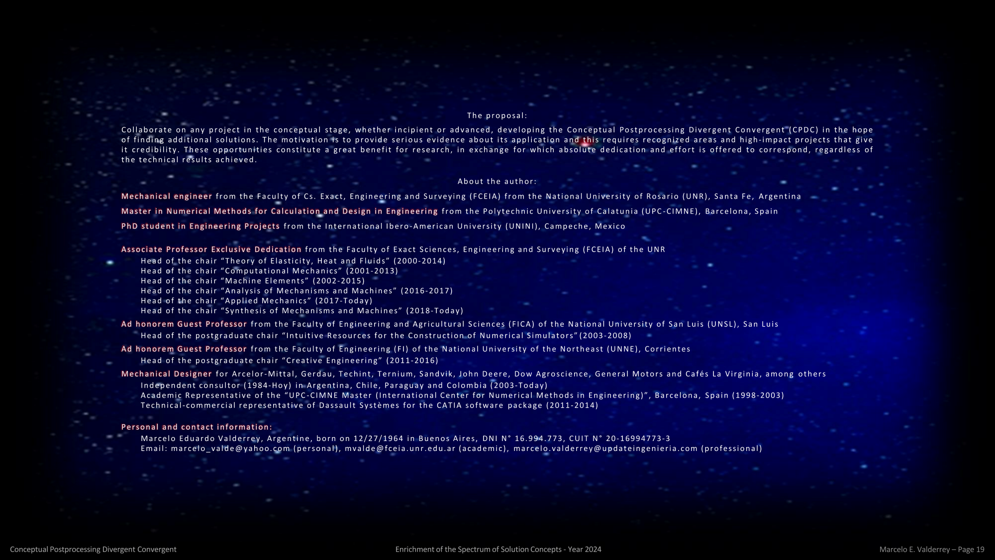

It is important to highlight that the present material, methodology and notations correspond to the context of the School of Mechanical Engineering (EIM) of the Faculty of Exact Sciences, Engineering and Surveying (FCEIA) of the National University of Rosario (UNR), Santa Fe, Republic Argentina. Therefore, these are not universal concepts or symbolisms but, on the contrary, particular ones developed by the chair specifically for said context, with an approach based on psychology and neuroscience that is complementary to the more formal and rational ones of use common in engineering.

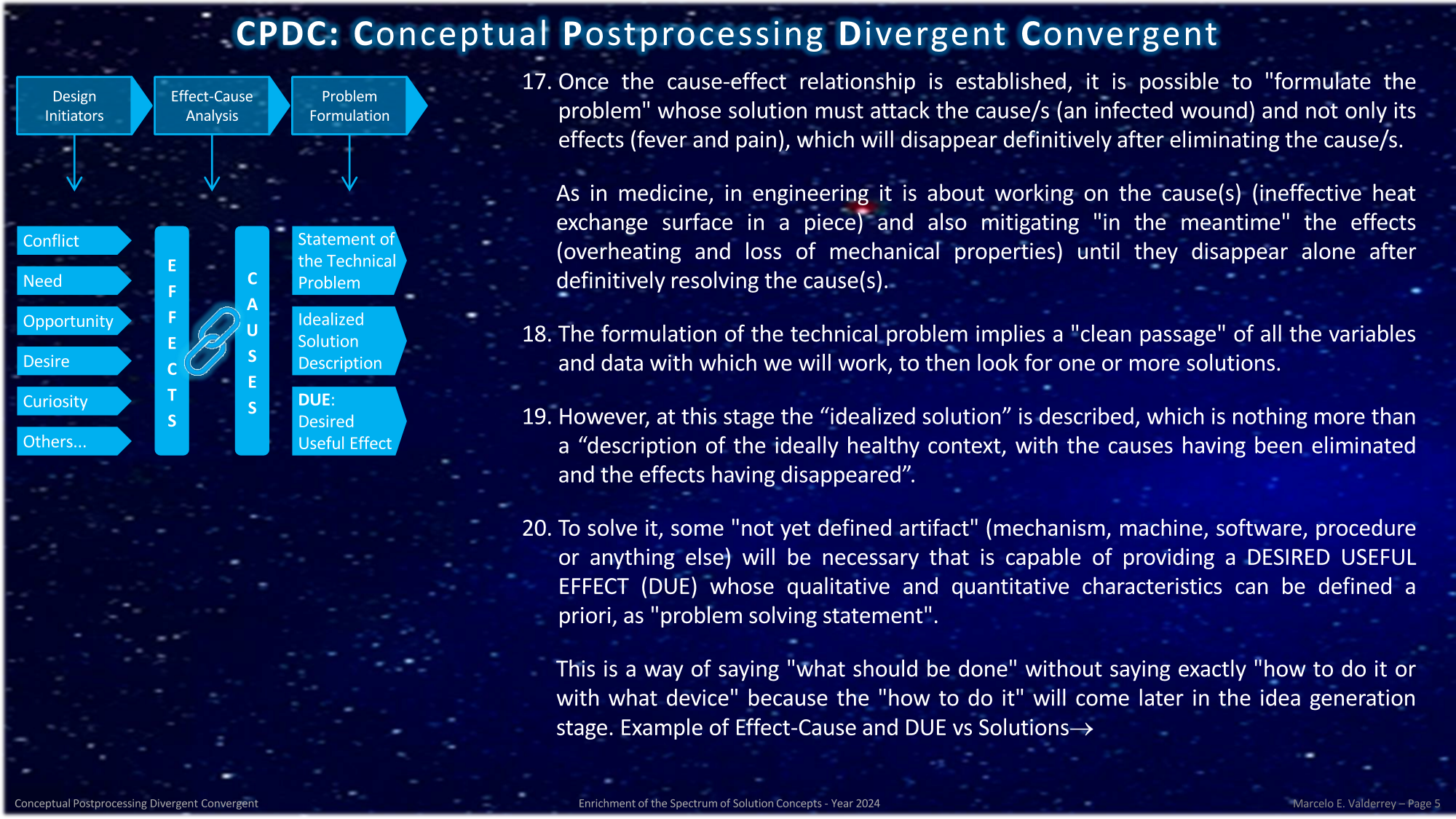

Step 4: "causes" derived from the effect-cause analysis
Step 5: "DUE" and formulation of the design problem
