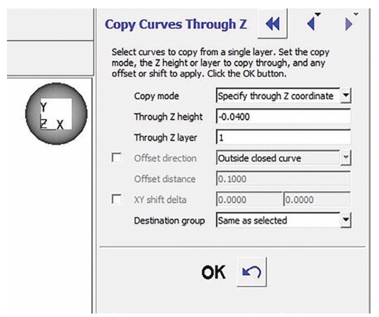

STEP H: From the Edit menu, select Copy Curves Through Z to extend the outer perimeter model contour down to the build sheet. Change the Copy mode to Specify through Z coordinate. Enter the desired value into the Through Z height field (in this case: -0.0400). Change the Destination group to Same as selected (Figure 6).
STEP I: From the Edit menu, select Offset Curves to offset the outer perimeter model contour inward. Change the Offset direction to Inside closed curve. Enter the desired value into the Offset distance field (in this case: 0.0200). Change the Destination group to Same as selected. Change Keep original to Yes (Figure 7).
STEP J: From the Edit menu, select Copy Curves Through Z to extend the new inner perimeter model contour down to the build sheet. Change the Copy mode to Specify through Z coordinate. Specify the desired value into the Through Z height eld (in this case: -0.0400). Change the Destination group to Same as selected (Figure 8).
