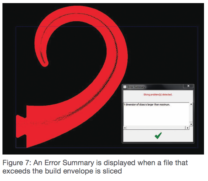

STEP 2: Open, orient and slice the STL file (Figure 6).
STEP 3: If the part exceeds the maximum X or Y dimension, an Error Summary will pop up. Click to accept the error (Figure 7).
