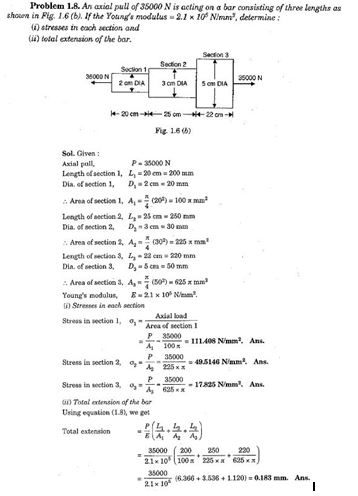

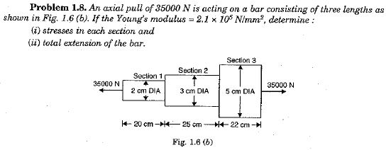

FEA of bars of Variable sections -The deformation occurs due to Tensile load.
Please check out the deformation results of solved problem and its FEA results in Creo are same.
  1. Step 1:
    Please sketch & make 3D model of the above variable section in PTC creo parametric.

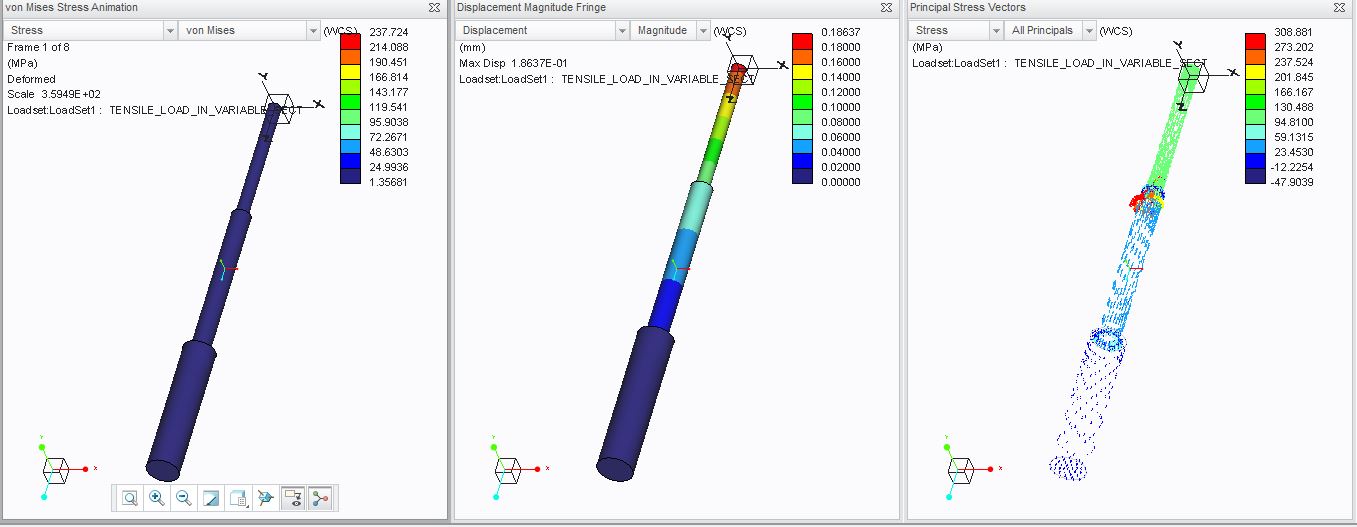

    Review the results of deformation which is matching with the given problem results.
  7. Step 7:
    Note: The results based on the unit conversion of the model. If its wrong the calculated results & Creo FEA results will not match.
  8. Step 8:
    FEA Creo Result:
