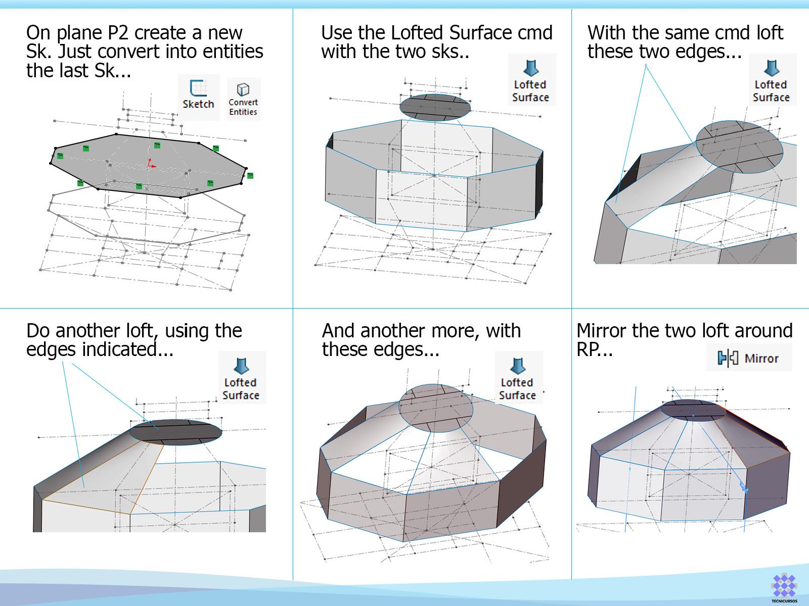

  3. Step 3: Splitting Disc & More Sks...
  4. Step 4: Surface Lofting...
  5. Step 5: More Lofting & And Bottom...

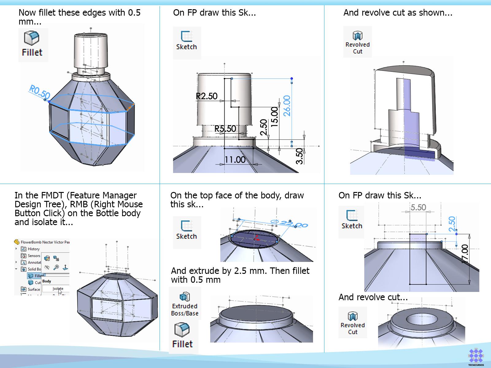

  7. Step 7: Filleting & Nameplate nest...
  8. Step 8: Cap Work & Body Top...

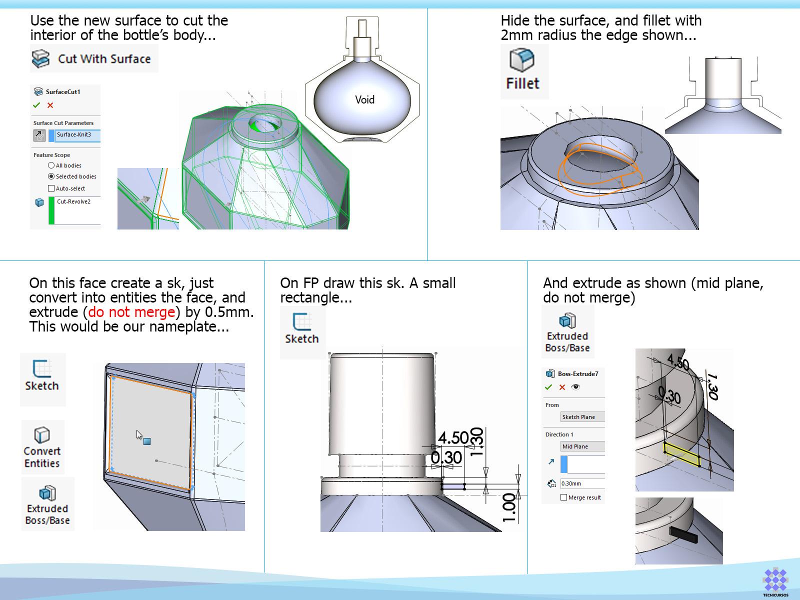

  9. Step 9: Surfacing for Hollowing the Bottle...
  10. Step 10: Cutting Inside Void & Nameplate...

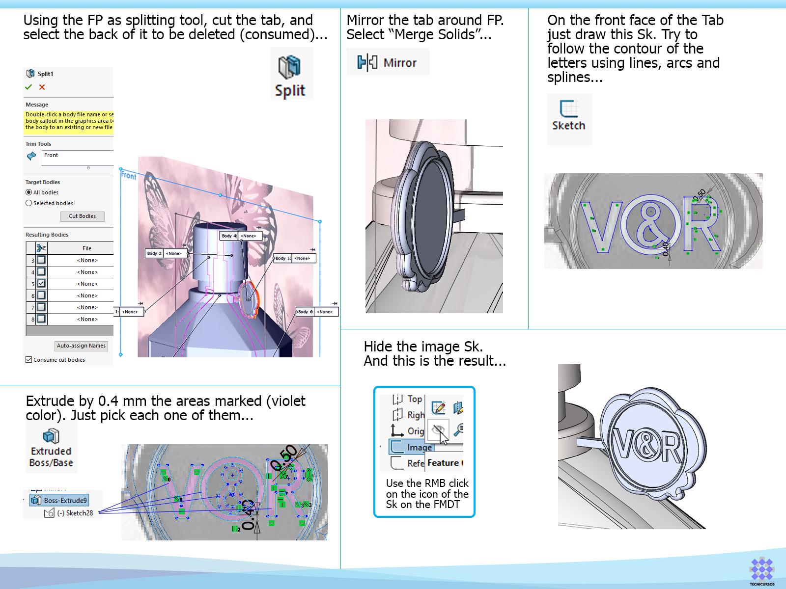

  11. Step 11: Working on the Tab...
  12. Step 12: More on the Tab & Lettering...
  13. Step 13: Liquid Inside... (Trick)
  14. Step 14: Nameplate Engraving...
