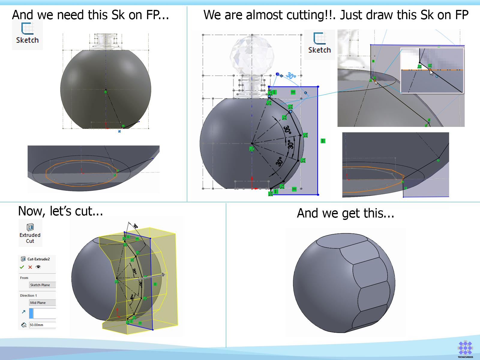

Some friends of the community asked us to upload the tutorial to see how we modeled this perfume bottle. And here we have the tutorial, I hope you like it and find it useful.
You can download the model from here:
H&D type Perfume Bottle
  1. Step 1: "Basic" Sketch...
    We recommend using an image of the product in a sketch, adjust the image to the approximate dimensions of the bottle, and from there draw a sketch with all the references that we will use during the modeling.
  2. Step 2: First Sketches & Planes...(Trick)
  3. Step 3: Splitting Top & Bottom...
  4. Step 4: First Cut!...
  5. Step 5: Circular Pattern & New Sk...
  6. Step 6: Second Cut & Array...
  7. Step 7: Finishing the Bottle's Body...
  8. Step 8: Work on the Knob & Dropper...
  9. Step 9: Important Cutting Trick...
  10. Step 10: Circular Pattern & Knit...
  11. Step 11: Closing the Knob & Second Cut...
  12. Step 12: Circular Pattern & Finishing the Knob...
  13. Step 13: Appearances and Final Rendering...
