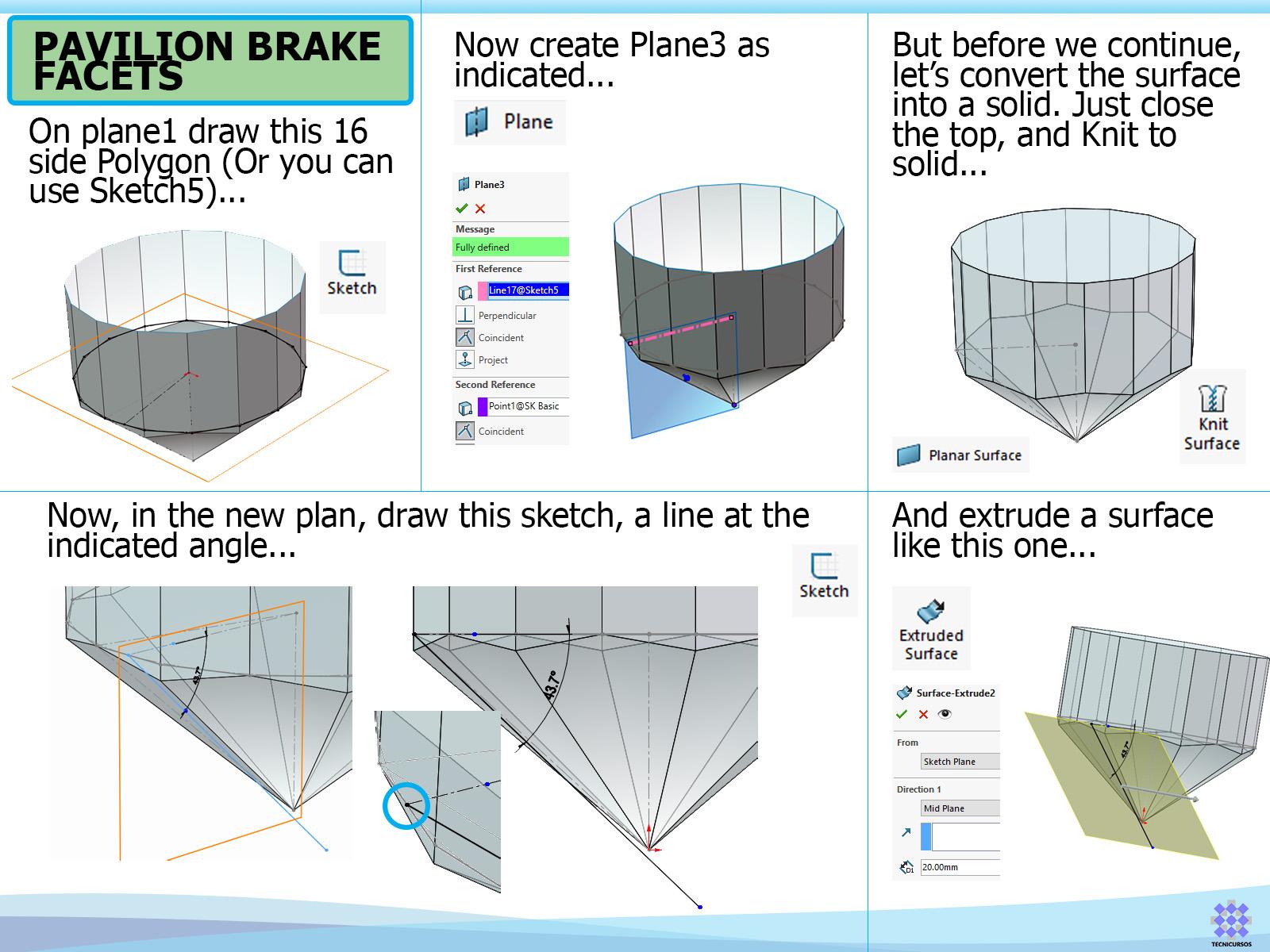

Step 4: Pavilion Brake Facets...

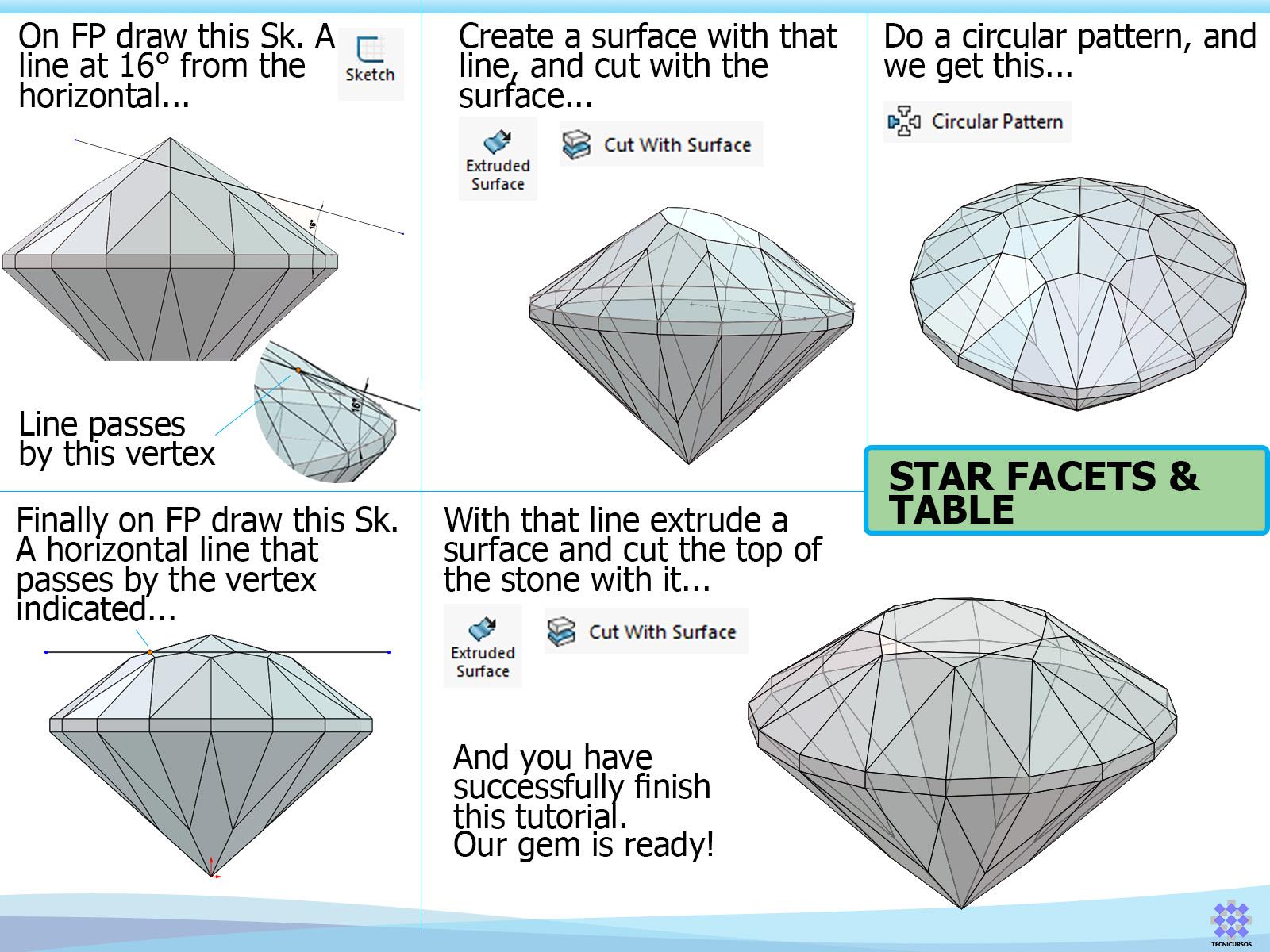

Step 6: Crown Main Facets...
35° for the Crown main facets.
Step 7: Brake Facets...
37.5° angle for the Brake facets
Step 8: Star Facets & Table...
Step 9: Finishing & Rendering...
