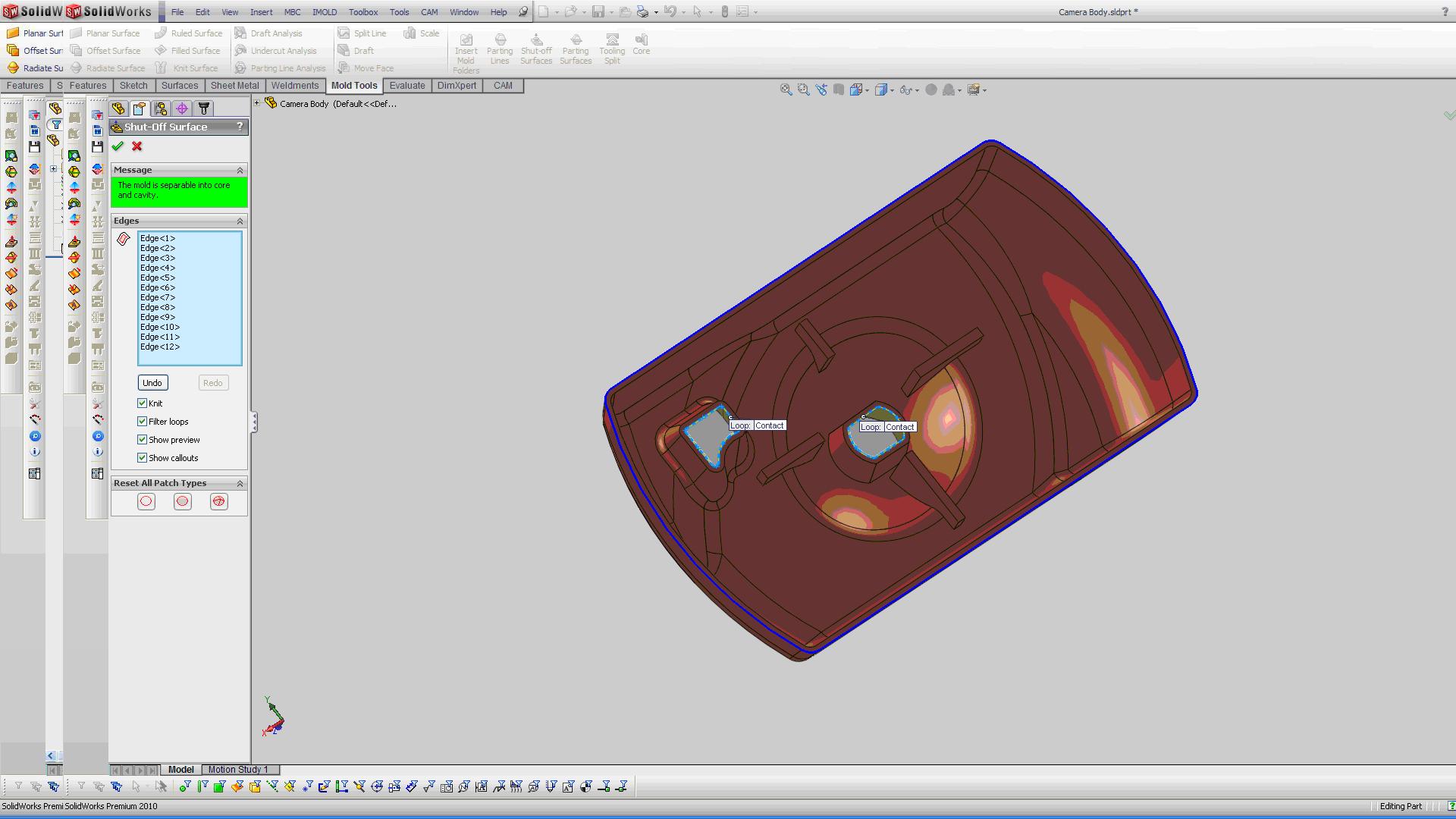

Step 4
Shut Off Surfaces, this close all gaps. -

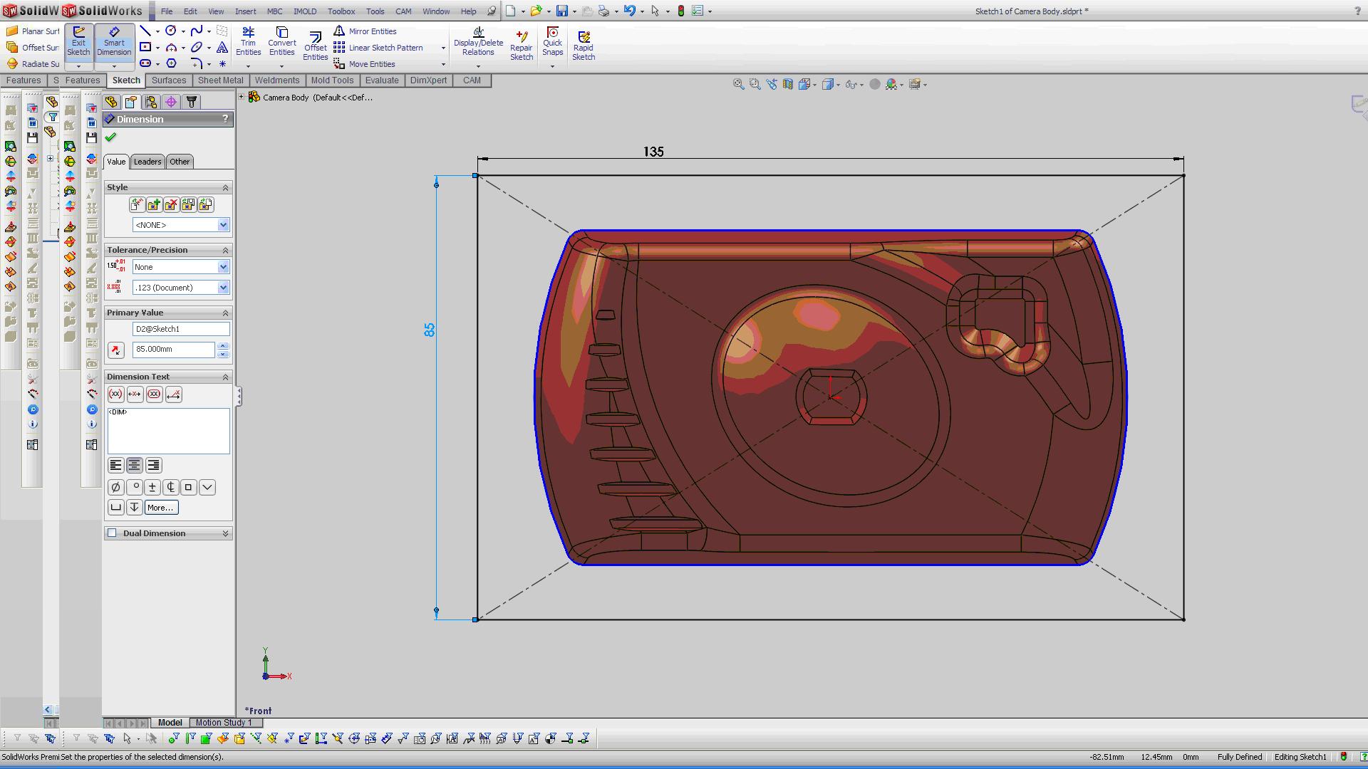

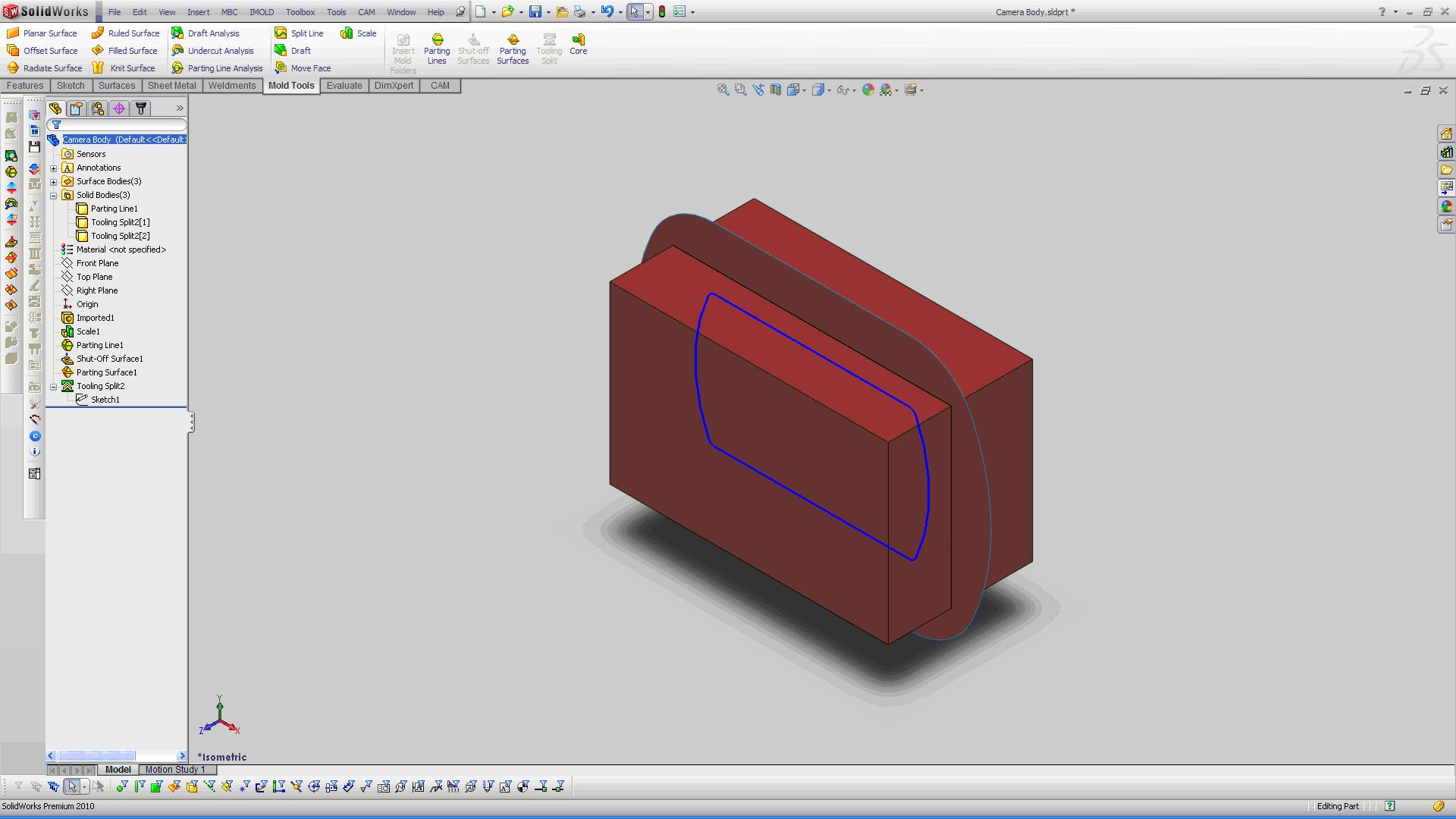

Step 6:
Step 6
Create Core and Cavity by Tool Split. Press and select plane in this example it is Front Plane, in this plane create sketch (it will be mold block). Press OK -

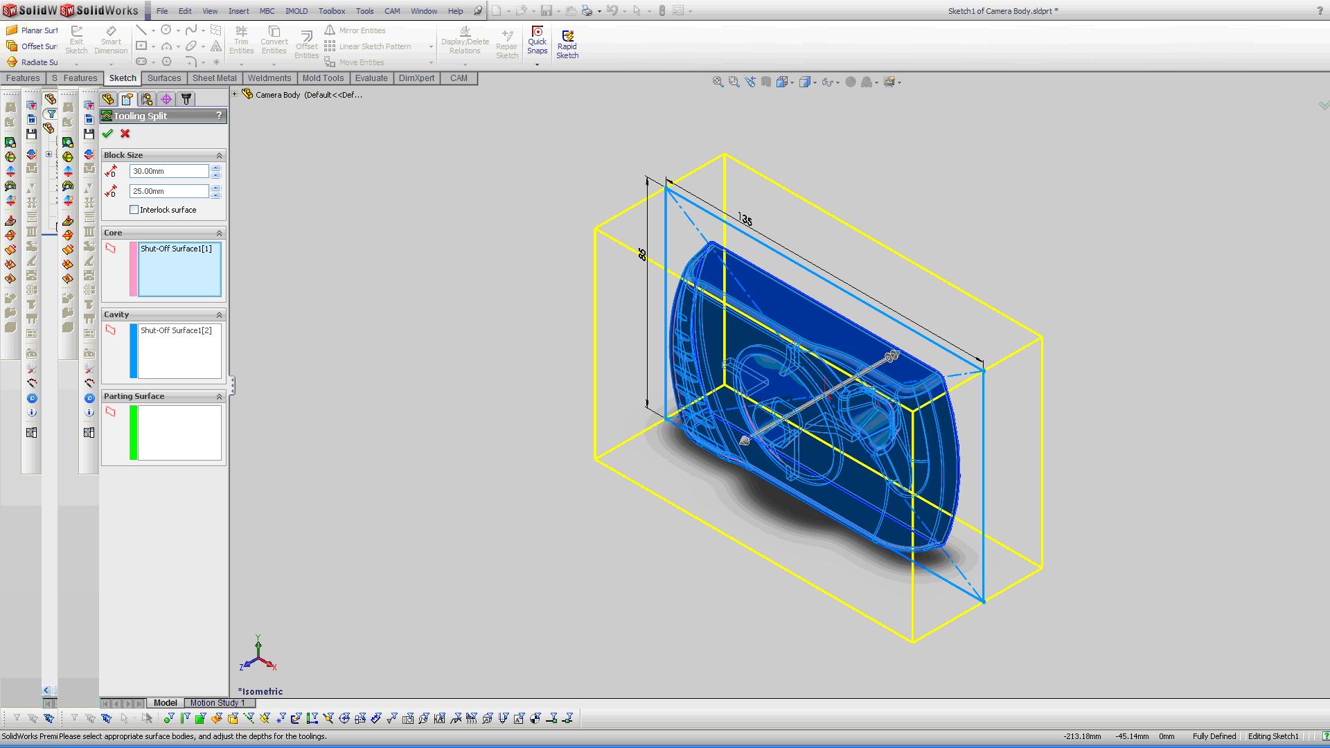

Step 7:
Step 7
Enter value of Core and Cavity. Press OK -

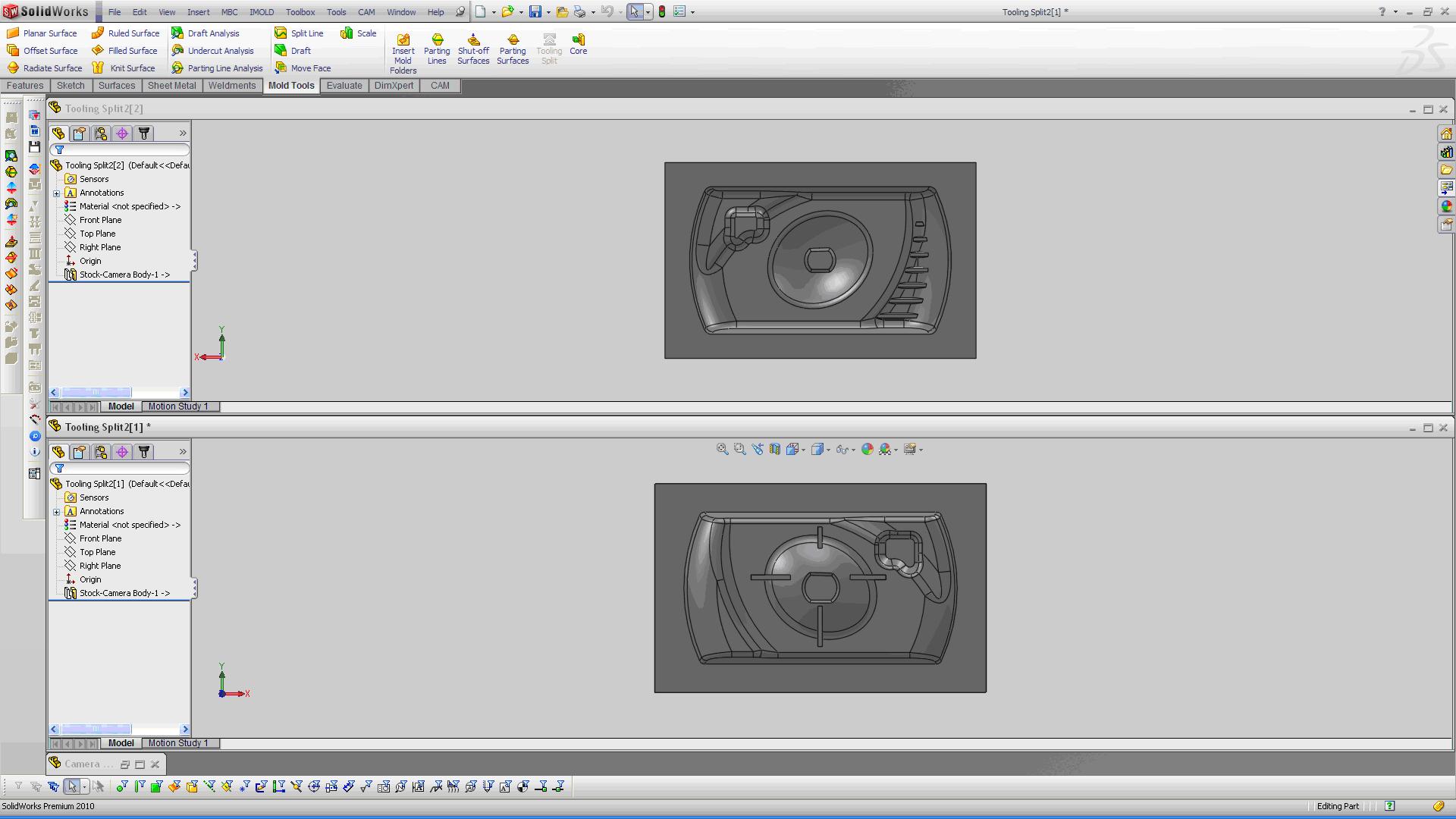

Step 8:
Step 8
First Result -

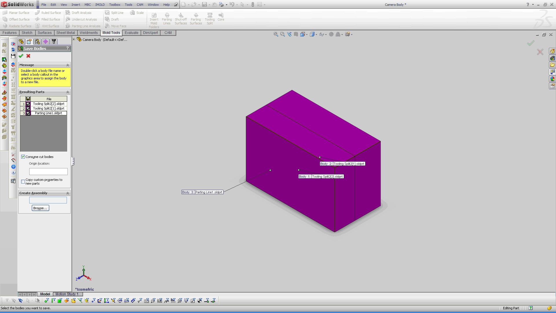

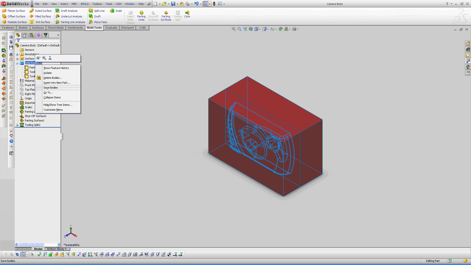

Split for independent parts. At Solid Body press right mouse bottom and choose Save Bodies -
Step 10:
Step 10
Save Bodies -
Step 11:
Step 11
Final Result
