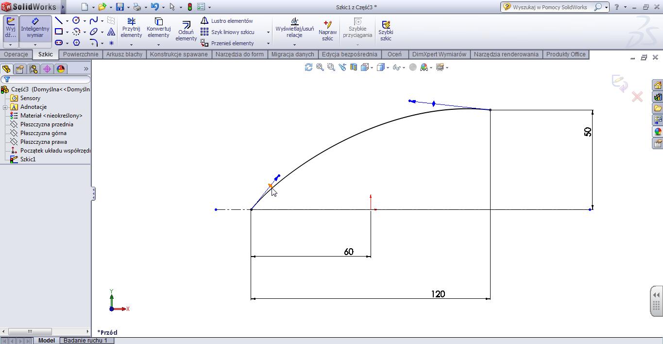

  1. Step 1:
    This is a very simple
    the example curves drawn on planes
  2. Step 2:
    make dimensions the distance of points from each other and from the Centre of reference
  3. Step 3:
    then we can give your relationship vertical or horizontal, depending on what we need
  4. Step 4:
    then select the dimension and clicking on the arrow to the point of the curve, we can give the value of the length
  5. Step 5:
    Another way to define the account to which the arrow is a curve while the dimension, select the arrow
  6. Step 6:
    then mark the line the center of a horizontal/vertical passing through the Centre of the coordinate system
  7. Step 7:
    and then after we enter the value of the angle variance arrow to the point of the curve
  8. Step 8:
    or we make by selecting the arrow and in the properties panel finding, quoted below, we enter the value of the angle in mind that we enter values from 0 to 180 and from 0 to-180 if we wanted to approach it in a second page
  9. Step 9:
    a little bit differently, we will sketch in 3D when you draw a curve, click anoder the arrow and then we can give its relationships relative to the reference axis, for example, in relation to the axis X
  10. Step 10:
    or with relation to the axis Y
