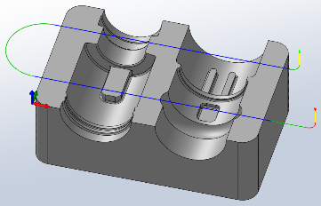

  4. Step 4: Facing

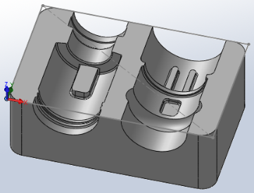

    To clear the top face of our stock and ensure that it is completely horizontal, we will begin with a facing operation.
    ➝ Click Face on the CAM toolbar or select it form the CAM, Toolpaths menu.
    This creates a new operation and opens the Property Manager where you can edit the individual parameters controlling the toolpath, as well as selecting the actual geometry to machine.
    The property page is divided into number of groups, and in this tutorial we will go through each one by one changing the necessary settings in each group as we go along.
    1. Tool
    ➝ Press Library
    ➝ From the library Tutorial under Sample Libraries, select tool #1 - Ø50mm flat
    ➝ Press Select
    2. Geometry
    For the facing operation we can use the Sketch1 feature that we made visible when creating the coordinate system.
    ➝ From the feature tree, locate Sketch1 like we did when creating the coordinate system feature.
    ➝ Click Sketch1 to select it as the facing geometry.
    We are now done using the sketch, and can hide it to avoid unnecessary items shown on our model.
    ➝ Right click Sketch1 and choose Hide.
    3. Passes
    Face
    The parameters in this group controls how the actual facing toolpath is laid out.
    When you selected the 50mm tool, the Stepover and Pass Extension parameter were automatically updated to reflect the new tool diameter. We will leave the parameters at their defaults, except the pass extension, which we can increase.
    ➝ Change Pass Extension: 5mm
    4. Start calculation

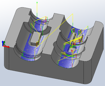

    Click at the top of the property manager. This will automatically start calculation of the toolpath.
    The toolpath will now be calculated and a preview will be shown in the model view:

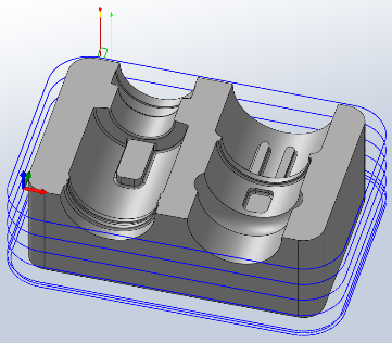

  5. Step 5: Outside Contouring (2D)
    We want to run a contouring toolpath along the outer edges of the part to create the rounded corners and to finish the walls properly.
    ➝ Click 2D Contour on the CAM toolbar or select it from the CAM, Toolpaths menu.
    1. Tool
    By default, newly created operations use the same tool as the previous operation. In this case, we get the tool from the facing operation selected. This is not useful for this operation, so we will select a different tool instead.
    ➝ Press Library
    ➝ From the library Tutorial under Sample Libraries, select tool #2 - Ø16mm flat
    ➝ Press Select
    2. Geometry
    Here we select the geometry we want to machine. We want to run the tool around the outside edge of the part.
    ➝ Select the edges to be machined. Move the mouse over the bottom front edge, it will be highlighted, then click on it. Depending on the side of the edge you click you can determine the direction of the contour. By clicking closer to the desired start of an edge you can determine the direction of the contour. For climb milling click close to the bottom right side of the edge. After you finished your geometry selections, the graphics window should look like this:
    3. Heights
    Since our job stock is set to have 1mm Z offset, we need the contouring toolpath to go below the height of the selected geometry.
    ➝ Change Bottom: -2.0mm
    4. Passes
    2D Contour
    To machine the contour in steps of 10mm, set these parameters:
    ➝ Enable Multiple Depths
    ➝ Change Maximum Roughing Stepdown: 10.0mm
    To avoid leaving marks at every step, we can do a single finishing pass at the final depth by setting these parameters:
    ➝ Enable Roughing Passes
    ➝ Enable Finish Only At Final Depth
    5. Start calculation

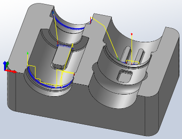

    ➝ Click at the top of the property manager.
    The toolpath will now be calculated and shown in the graphic area.

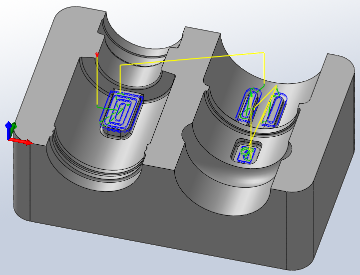

  6. Step 6: Adaptive Clearing
    In this tutorial, we will use the Adaptive Clearing strategy to rough out the bulk of material.
    Adaptive Clearing is a modern HSM (High Speed Machining) strategy designed for roughing on modern machines capable of running complex NC files at high speeds.
    The defining parameters in Adaptive Clearing is the Optimal Load and the Stepdown, but whereas traditional roughing strategies requires you to set the load (or stepover) and stepdown for the worst case scenario, Adaptive Clearing allows you to use the recommended maximum values provided by your tool vendor. This is possible since the specified Maximum Load is guaranteed not to be exceeded.
    The Maximum Load is the Optimal Load + the Load Deviation.
    ➝ Click Adaptive Clearing on the CAM toolbar or select it form the CAM, Toolpaths menu.
    1. Tool
    ➝ Press Library
    ➝ From the library Tutorial under Sample Libraries, select tool #11 - Ø10R1mm bullnose
    ➝ Press Select
    2. Geometry
    Rest Machining
    By default, the adaptive clearing strategy does rest machining from the job stock.
    In this tutorial, we have already removed some of the stock with the previous operations, so to avoid having the adaptive clearing strategy remove the same material, we need to specify that rest machining should take the previous operations into account.
    ➝ Select From Previous Operation(s) from the Rest Material Source drop down
    Other settings in this group we will leave unchanged.
    3. Passes
    Adaptive Clearing
    The parameters in this group control the for Adaptive Clearing passes.
    In this tutorial we will use the default parameters. Generally, however, you will have to look up the values for the stepdown and load parameters in your tool catalog.
    Stock to Leave
    The Stock to leave parameter control the amount of material to leave in the radial (in the XY-plane) and axial (along the Z-axis) directions. The default values of 0.5mm are suitable in this example, so we will leave them unchanged.

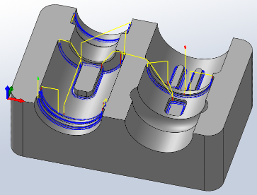

    ➝ Click at the top of the property manager. The resulting toolpath will look like this:

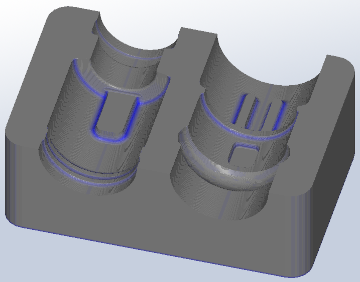

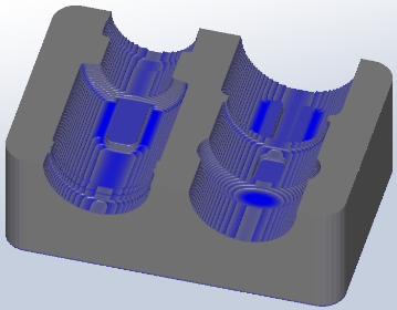

    5. Verification

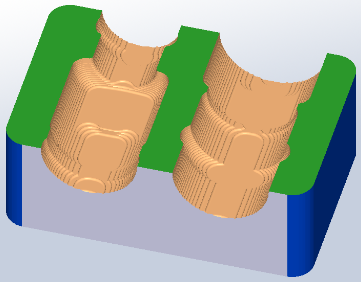

    To verify the toolpath use the stock simulation, right click on the Job node in the Operation Manager and select Stock Simulation (All). Press the Start button and watch the stock simulation up to the final stock shape.
    Click to exit the Stock Simulation.
    If you want to see the entire model during the stock simulation right click on the screen and select Fit to window in the bottom of menu. You can also switch to various views to se the final part from exactly directions.
    Once the verification is complete, you can do a comparison with the stock by using the stock compare feature.
    Press Stock to compare the model and stock. This will color the verified part depending on the amount of material left.
    The color in comparison depends on the amount of material left.
    Grey indicate that there is no stock left while blue indicate that there is more stock left.
    You can measure the exact amount of stock left by moving your mouse over the model and watching the Distance display update in the Stock group on the property page.
    Additionally, the Comparison group lets you control the number of steps in calculated in the comparison, as well of the size of the steps. The default is 100 steps of 0.01 mm. This means that the coloring is done beween 0.0 and 1.0 mm stock in 100 steps.
    The comparison clearly shows that there are a number of areas that our 10mm tool cannot reach. In the next step we will rough these areas using rest machining.

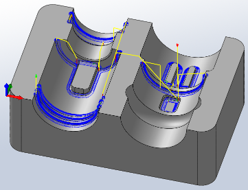

  7. Step 7: Adaptive Clearing Rest Machining
    To rough out the remaining stock where the 16 mm tool could not fit, we will remove the rest material using the Adaptive Clearing with a smaller tool.
    We will start by making a copy of the previously created operation.
    ➝ Right click on the Adaptive1 operation
    ➝ Choose Duplicate
    ➝ Right click on the newly created operation and select Rename from the context menu.
    Alternatively, you can use F2 key to rename.
    ➝ Change the name to Adaptive2-Rest.
    ➝ Right click on the new operation
    ➝ Choose Edit
    This will open the property page for the new operation. Notice that all parameter values are the same as the Adaptive Clearing operation created before.
    In many cases creating a copy (using Cut and Paste, or the Duplicate option) is faster than creating a new operation since you often use similar parameter settings in successive operations.
    1. Tool
    ➝ Press Library
    ➝ From the library Tutorial under Sample Libraries, select tool #14 - Ø5R0.5mm bullnose
    ➝ Press Select
    2. Passes
    Adaptive Clearing
    ➝ Change Optimal Load: 1.0mm
    ➝ Change Maximum Roughing Stepdown: 5mm
    ➝ Change Fine Stepdown: 1mm
    Stock to Leave
    ➝ Change Radial (Wall) Stock To Leave: 0.3mm
    ➝ Change Axial (Floor) Stock To Leave: 0.3mm (Automatically updated)
    3. Start calculation

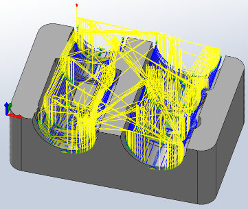

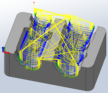

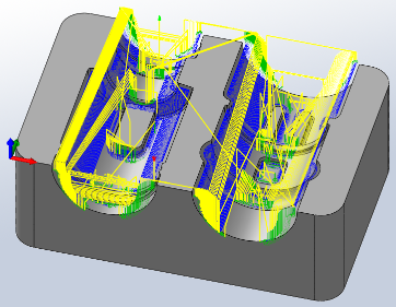

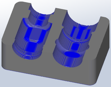

    4. Verification

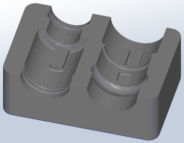

    To verify the toolpath use the stock simulation, right click on the Job node in the Operation Manager and select Stock Simulation (All). Press the Start button and watch the stock simulation up to the final stock shape. Press Stock to compare the model and stock. This will color the verified part depending on the amount of material left.
    There is now primarily material left in the narrow slots on the part.

  9. Step 9: Contour Finishing
    In this operation we will use the 3D contour finishing strategy to finish the steep areas of the part.
    ➝ Click Contour on the CAM toolbar or selected it from the HSMWorks Toolpaths menu.
    1. Tool
    For this operation we will need a 6mm ball end mill. Again, we select this from the Tutorial sample library.
    ➝ Press Library
    ➝ From the library Tutorial under Sample Libraries, select tool #21 - Ø6mm ball
    ➝ Press Select
    2. Geometry
    Machining Boundary
    ➝ Change Tool Containment to Tool Center on Boundary.
    ➝ Change Additional Offset: 1.0mm
    Slope
    ➝ Enable Slope
    ➝ Change From Slope Angle: 30deg
    3. Passes
    Contour
    In this group change only the following settings:
    ➝ Change Maximum Stepdown: 0.3mm
    ➝ Disable Flat Area Detection
    4. Linking
    ➝ Change Retraction policy to Minimum Retraction.
    ➝ Change Safe Distance: 5mm
    ➝ Change Maximum Stay-Down Distance: 8mm
  10. Step 10: Parallel
    In this operation we will use the parallel finishing strategy to machine the part .
    ➝ Click Parallel on the CAM toolbar or select it from the CAM, Toolpaths menu.
    1. Tool
    The previous tool #21 - Ø6mm ball should still be selected.
    2. Geometry
    Slope
    The contour operation have covered the slope range from 30 to 90 degrees. Thus, if we specify that this parallel operation should machine from 0 to 35 degrees this gives us a 5 degree overlap between the two operation.
    ➝ Enable Slope
    ➝ Change To Slope Angle: 35deg
    Check Surfaces
    We want to finish the shallow areas of the part. Specifically those under 30 degrees not reached by the contour finishing operation. But since we have already finished the flat areas, we want to prevent the tool from touching these flat surfaces. For this purpose we can use check surfaces.
    ➝ Enable Check Surfaces
    ➝ In the Check surface selection field, select all of the flat faces:
    3. Heights
    ➝ Set Top: -1mm
    When you set the Top value to 1mm under the top plane of the part, the tool will machine only inside cavities of the part and not on the upper surface.
    Alternatively we could have included the top surfaces in the check surface selection.
    4. Passes
    Parallel Finishing
    ➝ Change Stepover: 0.2mm
    ➝ Change Pass Direction: 45deg
    4. Linking
    ➝ Change Safe Distance: 6mm
    Leads & Transitions
    ➝ Change Transition method to Straight line.
    6. Verification
    From the comparison we can see that we have now finished most areas of the part, but that we are still missing material in the smaller fillets.

    By zooming in on the comparison we see that we have are still missing a bit of material in the fillets with radius 0.5mm.
  13. Step 13: Pencil 3
    Since the 2mm tool does not remove all the material in the R0.5mm fillets we will create a third pencil operation with a 1mm ball mill to handle the 0.5mm fillets.
    ➝ Click Pencil on the HSMWorks Toolbar or select it from the CAM, Toolpaths menu.
    1. Tool
    ➝ Press Library
    ➝ From the library Tutorial under Sample Libraries, select tool #24 - Ø1mm ball
    ➝ Press Select
    2. Passes
    Pencil
    ➝ Change Number Of Stepovers: 15
    ➝ Change Stepover: 0.05mm
    4. Verification
    We have essentially finished our part to within the tolerance specified in the various operations, and the only stock that is remaining is that between the stepovers of the various toolpaths.
    If we want an even better finish, you can edit the operations and use a higher tolerance and smaller steps in the toolpath.
