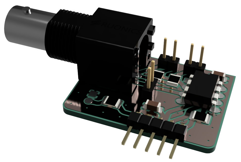

    The Picture below uses the decal placement process. To be covered in Separate Tutorial.
    The Picture below uses a version of the actual board created in this tutorial.
    This tutorial will only deal with the front side of the PCB Board but the Back is created in the exact same method.
