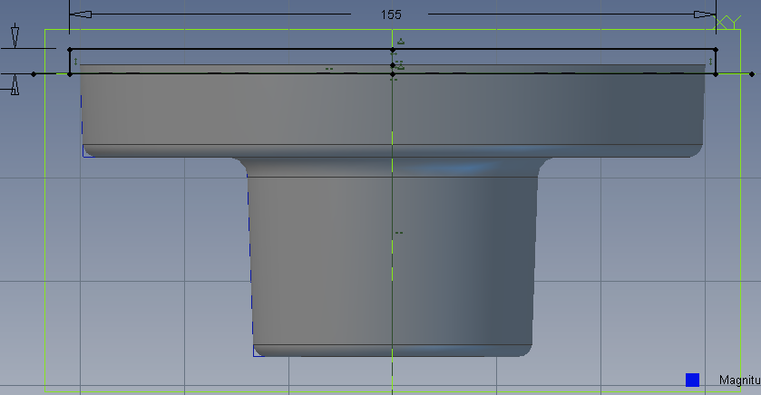

I have produced the base feature by revolving a sketch. I have allowed 2mm on top face for machining and put 2 deg. of draft on faces required to be able to extract the pattern from the sand mold
Base feature
I have added fillets to corners as would be standard for both the pattern and casting
