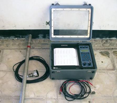

  5. Step 5: SBES Kit
    Single-Beam Echo-Sounder Kit for Hydrographic Survey
    • Precision survey echo sounder
    • GPS antenna
    • Transducer
