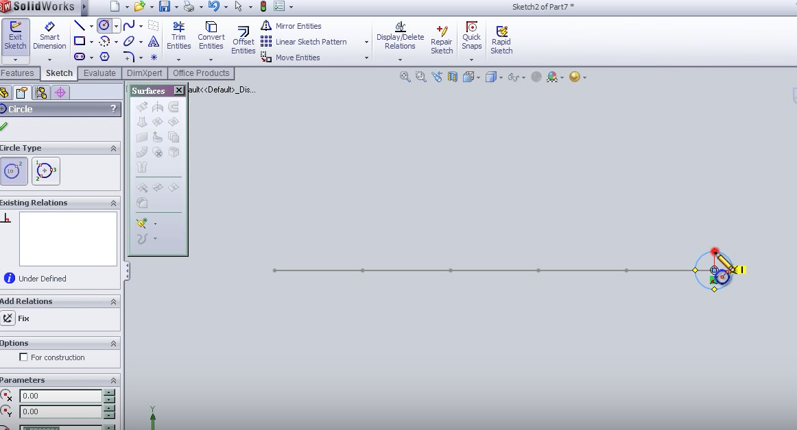

Your sketch will transform to how it’s pictured below. From here, select the rightmost endpoint. Using your circle tool, create a circle surrounding the rightmost endpoint. Set the smart dimensions of this circle to 10mm.

From there, access your surfaces toolbox. To do this, right click on the toolbar at the top of your screen. A menu will drop down (pictured below). Select “Surfaces” and the surfaces toolbox will then appear on the left hand side of your screen. From this toolbox, select the “swept” button.
Step 5:
Once you have clicked the “swept” tool, a box like the one pictured below will appear on the left hand of your screen. The Profile (Sketch2) is the circle that you just created.
