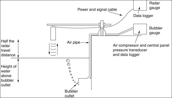

Before computers, (Tide Houses) were constructed to shelter permanent water level recorders, protecting them from harsh environmental conditions. In this diagram, we can see how the analog data recorder is situated inside the house with the float, and the stilling well located directly beneath it. Attached to one of the piers' pilings is a tidal staff. This device would allow scientists to manually observe the tidal level and then compare it to the readings taken by the analog recorder.
While similar in design to older tide houses, "newer tide station enclosures" are designed to protect sensitive electronics, transmitting equipment, and backup power and data storage devices. The older stilling well has been replaced with an acoustic sounding tube and the tidal staff with a pressure sensor. The new field equipment is designed to operate with the highest level of accuracy with a minimum of maintenance, transmitting data directly back to NOAA headquarters for analysis and distribution.

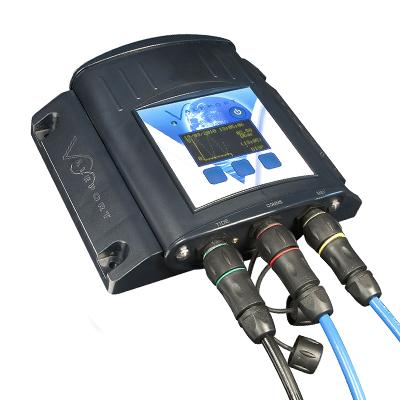

The TideMaster tide gauge has been designed to provide an accurate, versatile and easily deployed tide gauge for use in short or long term hydrographic survey operations. It can be configured with either a traditional vented pressure sensor or a VRS-20 radar level sensor.
The Tidemaster is the cost-effective way to accurately record water height, with the added option of gathering meteorological data using its ultrasonic wind speed and direction sensor.

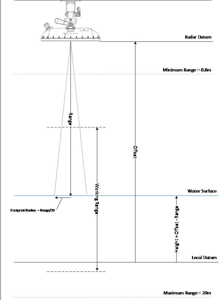

Minimum Range: 0.8 m
Maximum Range: 20 m
Beam Angle: ±6°
Frequency: 25 GHz
Accuracy: ±10 mm
Precision: 1 mm

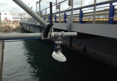

VRS-20 radar Mounting surface

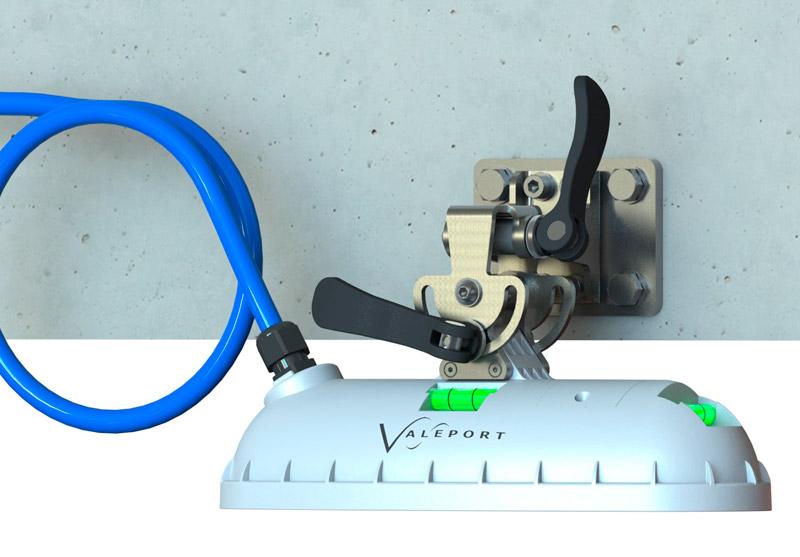

- Levelling
The VRS-20 needs to be parallel to the water surface for reliable and consistent operation. To aid
this, the sensor has been fitted with two bubble levels. Once the clamp or mounting bracket is firmly
fixed to the mounting surface the two axis adjustment on the bracket can be adjusted until the VRS-20 is level.
