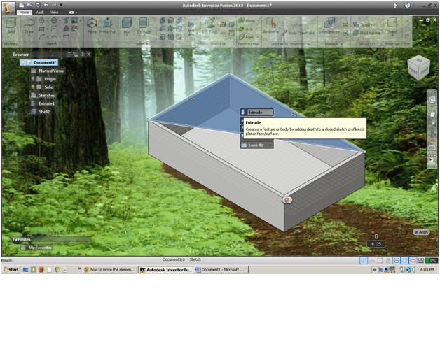

  1. Step 1:
    Select the remainder of the shelled out face.
  2. Step 2:
    Select “DRAW”. This icon is highlighted in the photo above.
  3. Step 3:
    Draw the outline of the side you wish to create. (this must be a closed figure and will be indicated as such by the brown color seen above.)
  4. Step 4:
    Select “SOLID”. This icon is highlighted in the photo above.
  5. Step 5:
    Select the shape you drew in step eight. An icon will appear as seen in the above photo.
  6. Step 6:
    Select “EXTRUDE”. This icon will appear by rolling the mouse over the previously mentioned icon.
  7. Step 7:
    Input the negative value of the wall thickness of the rest of the part. (this will default the computer to changing it to a cut extrude but will be fixed in the next step.)
  8. Step 8:
    Select the drop down box highlighted in the above photo. (for those who care this is called the “Boolean” options.)
  9. Step 9:
    Select “JOIN”. This will change the extrusion back to a normal bass/boss extrusion.
  10. Step 10:
    Select “OK”. This icon is highlighted in the above photo.
