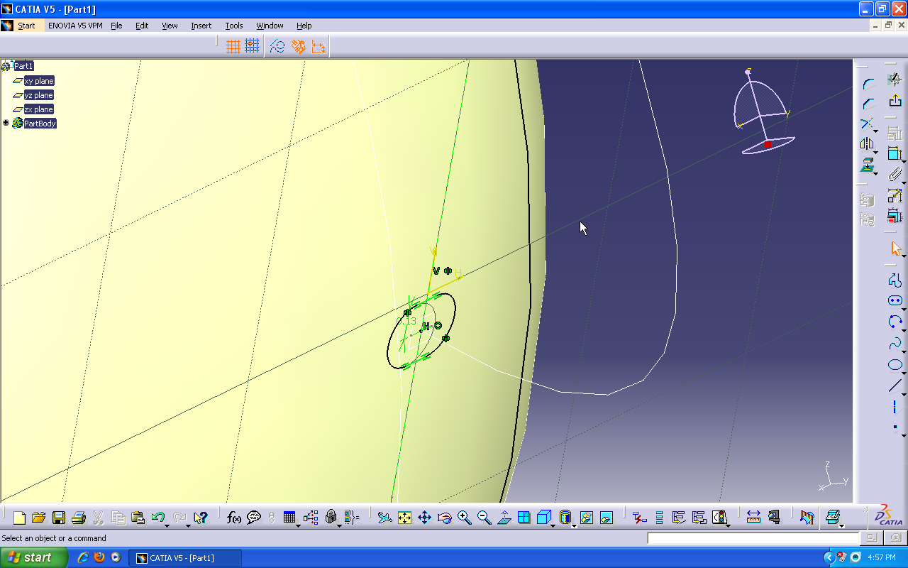

Insert a plane at the tip of the spline and click ok.
Step 5:
Draw your handle's profile and make it coincident with the spline in the center.

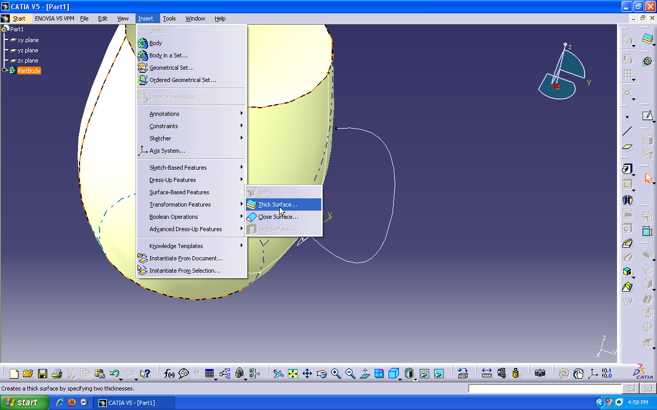

If you were in GSD then go to part design workbench
insert->surface based feature->thick surface.

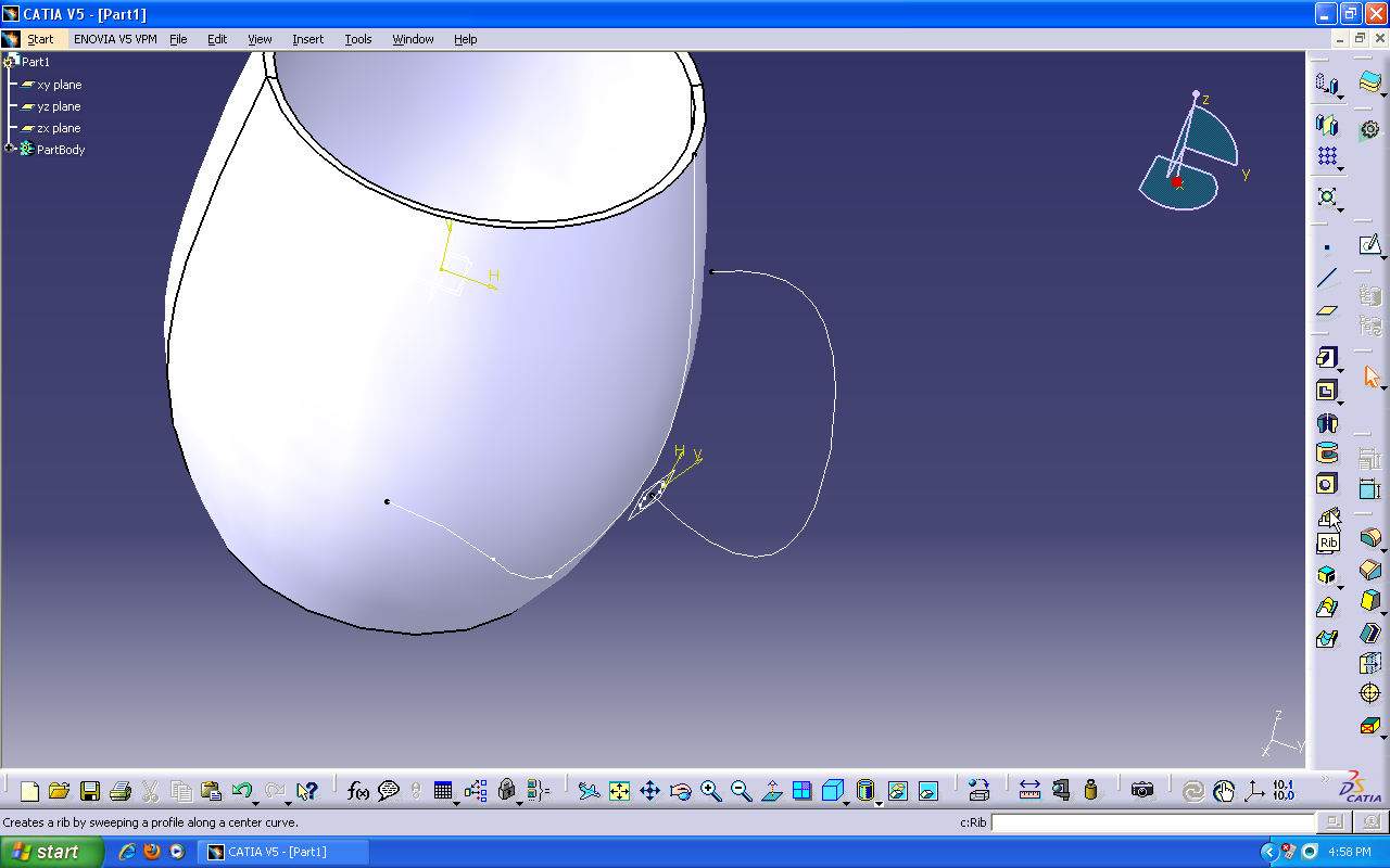

Step 7:
hide all the surfaces
Step 8:
after hiding the surface your model will look like this
Step 9:

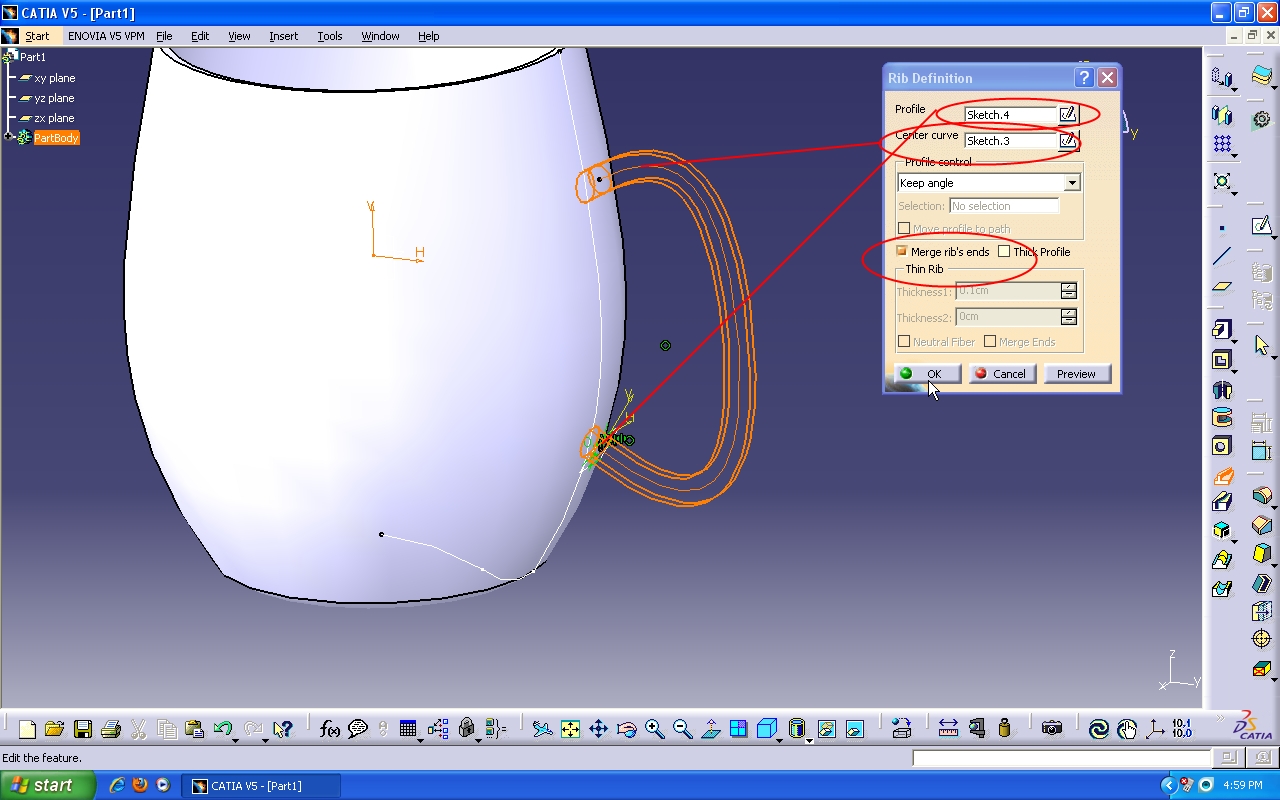

Now use "rib" feature. Invoke it from the main menu by using insert->features->rib definition or find it in the tool bar.
Select the profile as made in step 5, center curve as the spline and check "merge rib" option.
Step 10:
Here's you mug ready to use.
