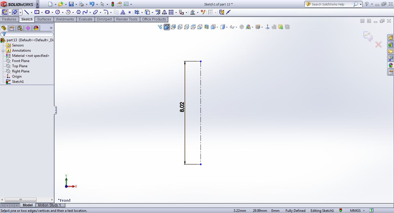

  1. Step 1:
    open a sketch on the front plane and draw a centerline
  2. Step 2:
    start the drawing

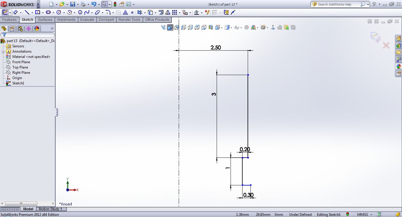

  3. Step 3:
    continue

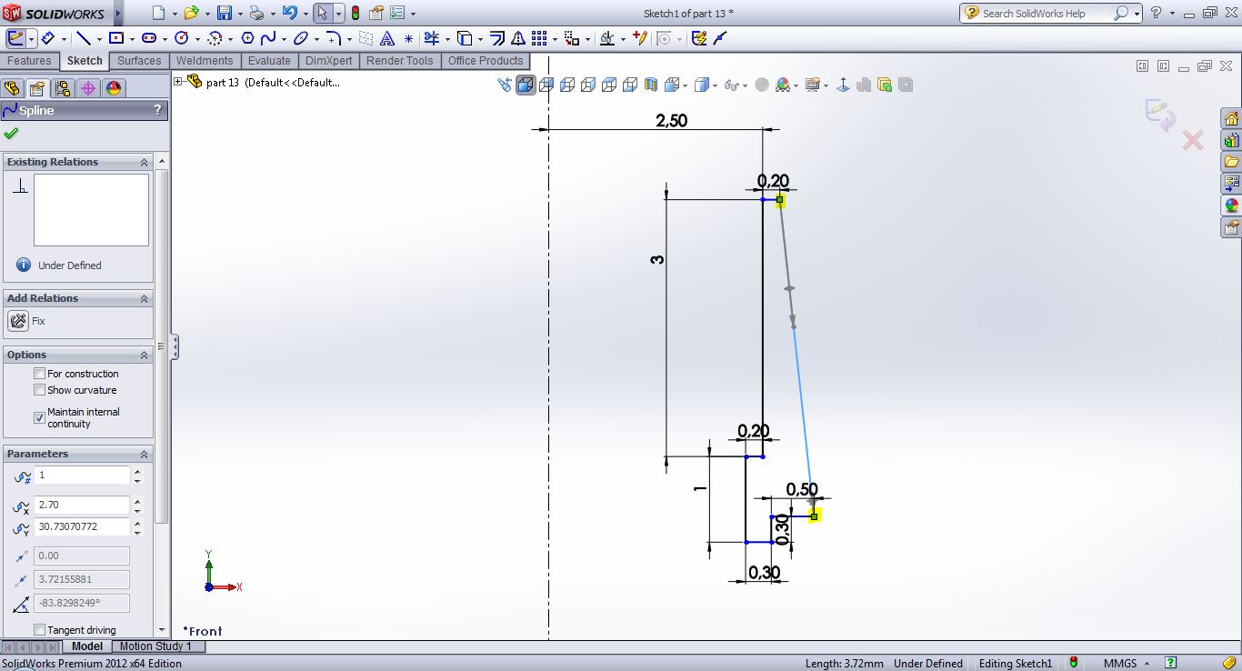

  4. Step 4:
    draw a spline between shown points

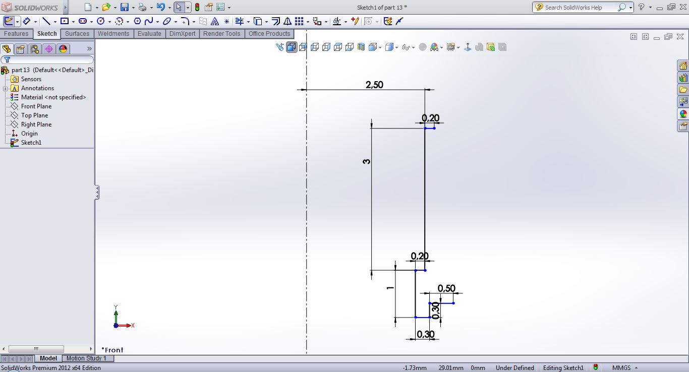

  5. Step 5:
    hold and drag from shown place and enter the angle parameter
  6. Step 6:
    finally make your sketch like this

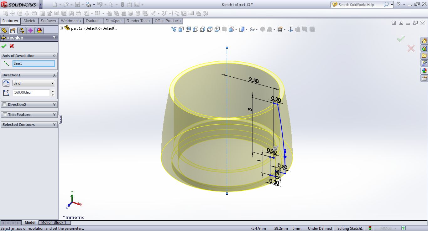

  7. Step 7:
    use revolve command
