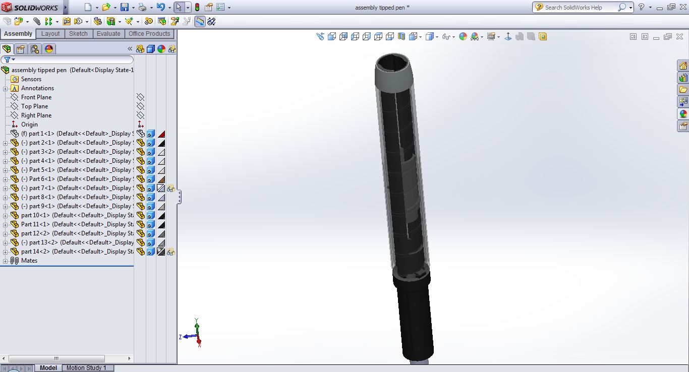

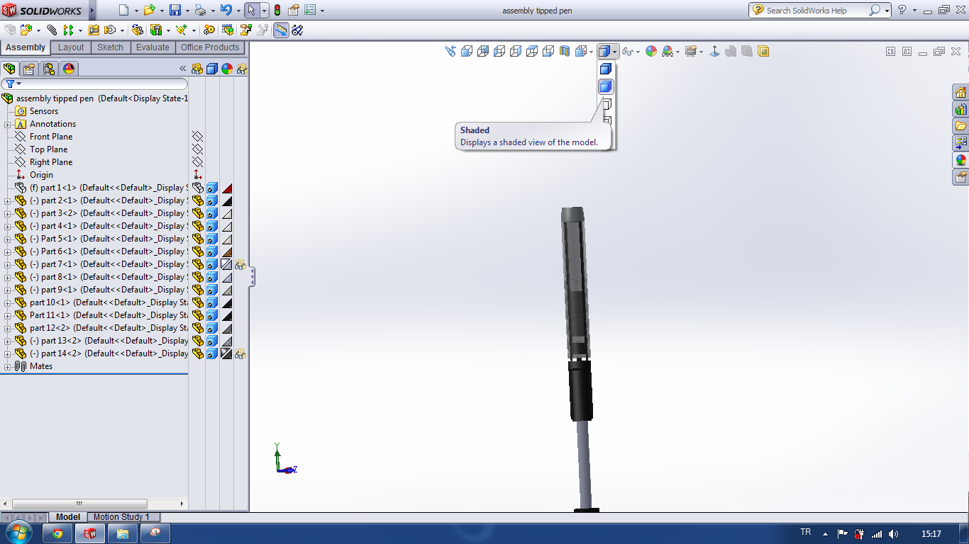

  1. Step 1:
    change transparency of part 14
  2. Step 2:
    use this option
  3. Step 3:

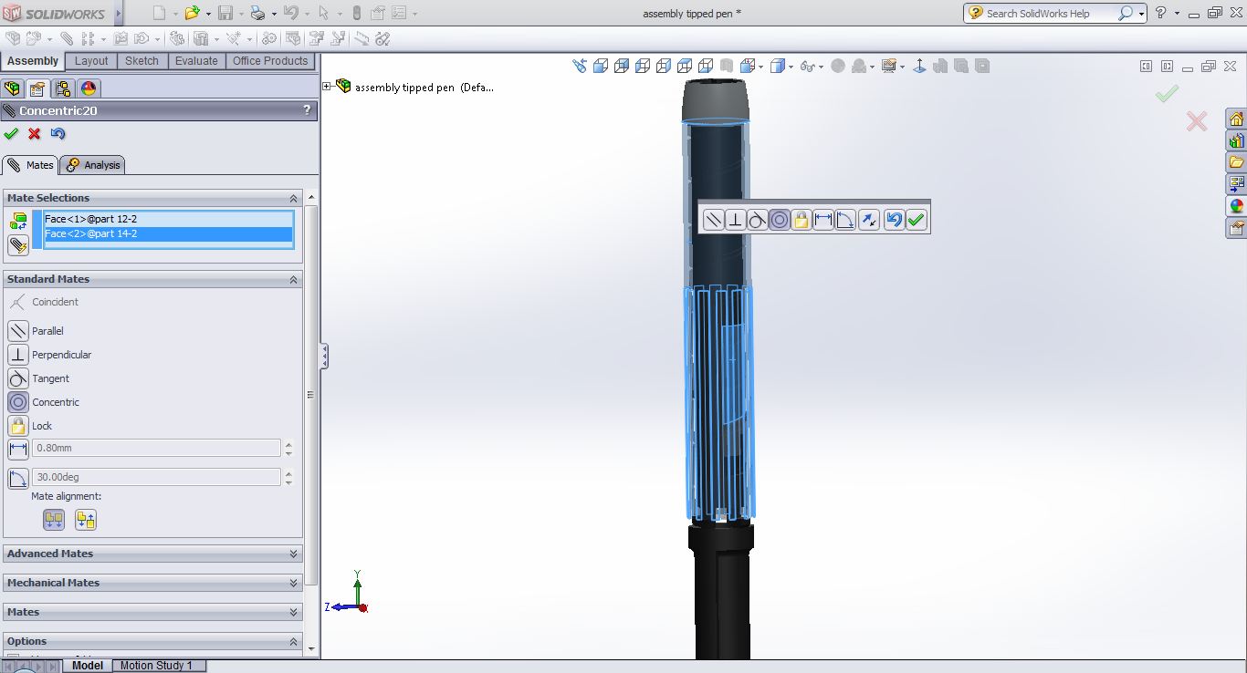

  5. Step 5:
    use mechanical mates option and click on screw button
  6. Step 6:
    enter shown values
  7. Step 7:
    most importand mate completed. now if you turn part 14, part 12 will move up and down

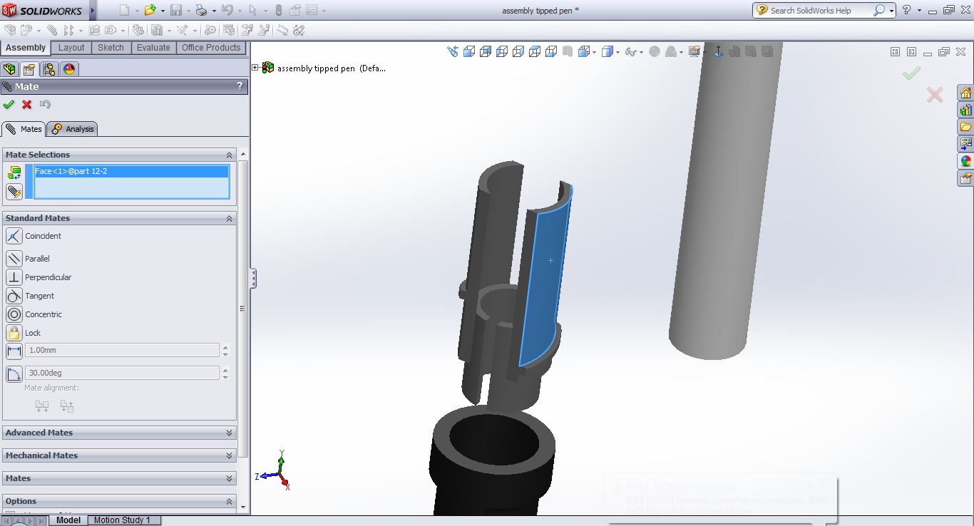

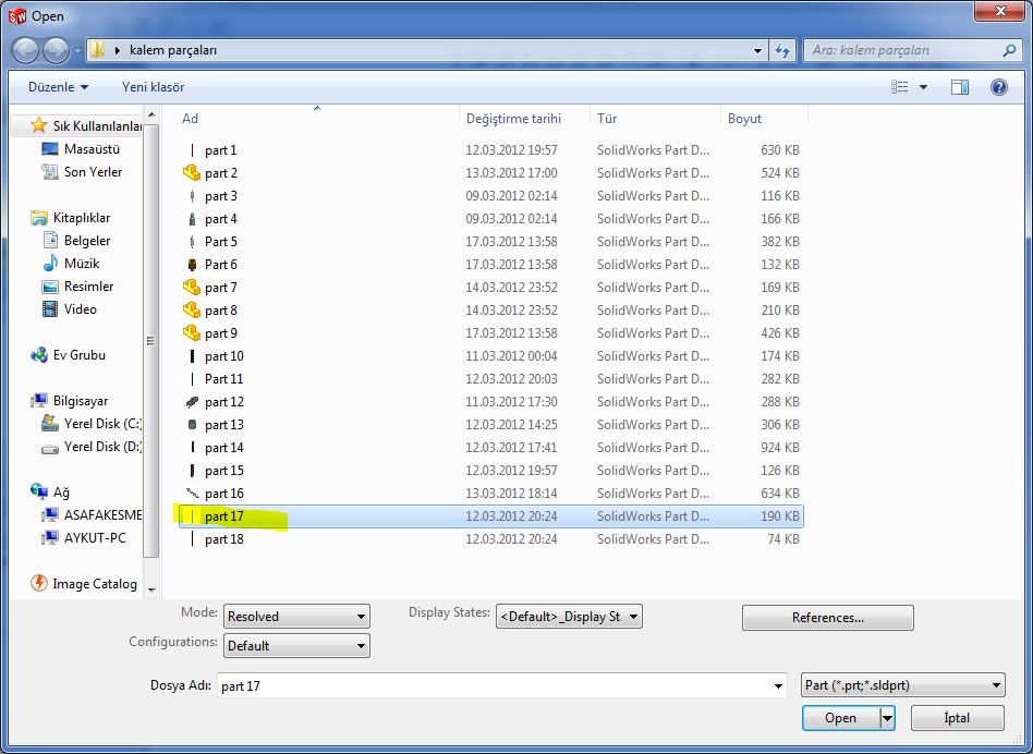

  8. Step 8:
    insert part 17
  9. Step 9:
    hide part 11 and part 14

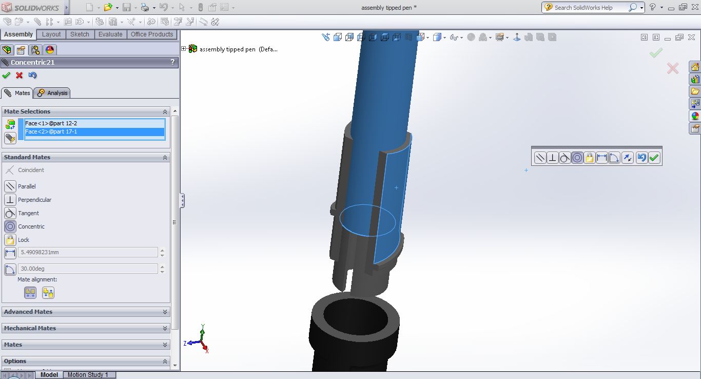

  10. Step 10:
    use blue surface for mate
  11. Step 11:
    now click on this surface .ok

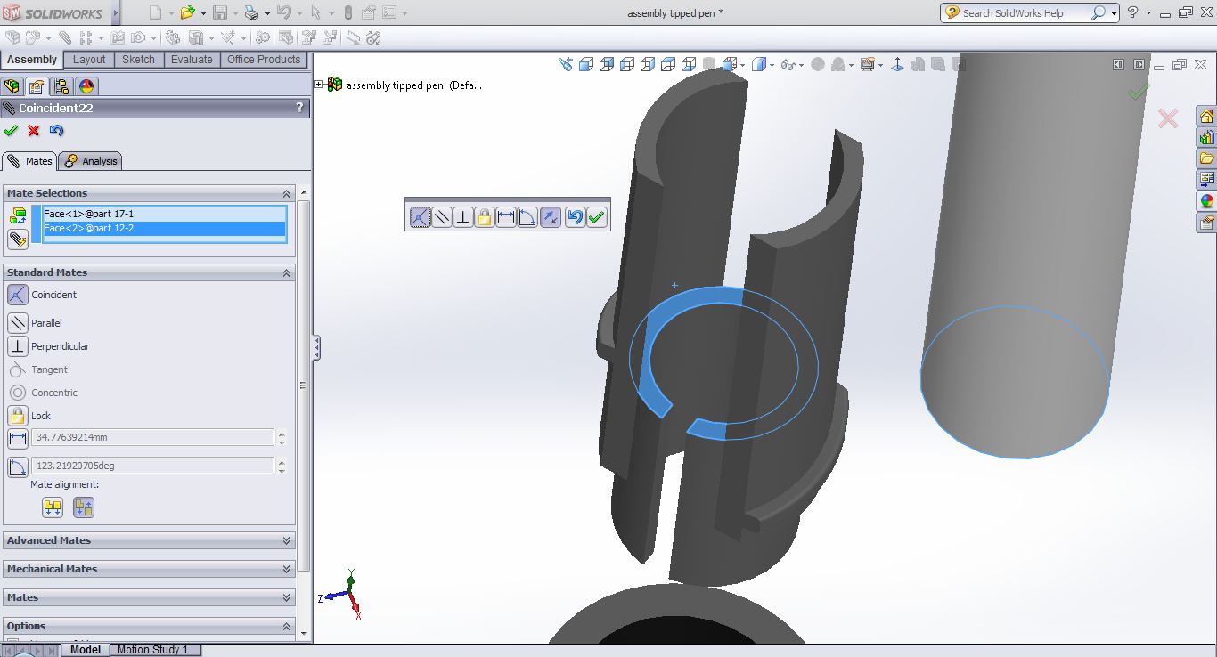

  12. Step 12:
    face 1 for mate
  13. Step 13:
    click on shown face and confirm that
  14. Step 14:
    now you can see that the erase is rising when you turn part 14
