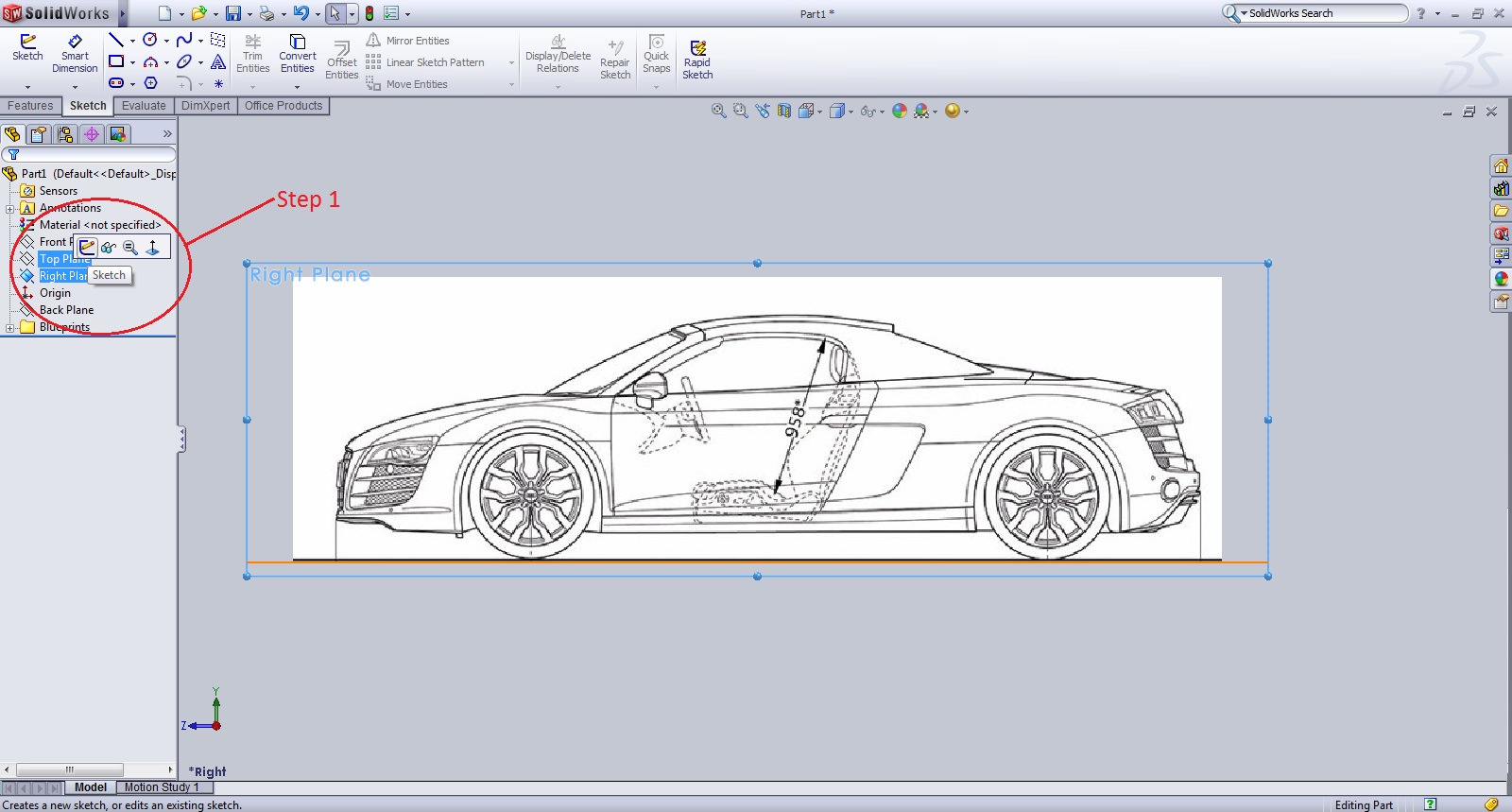

  1. Step 1:
    Step 1: First we will start by making a new sketch on our right plane. This will allow us to create a sketch on top of our sketch picture. It is as easy as tracing.
