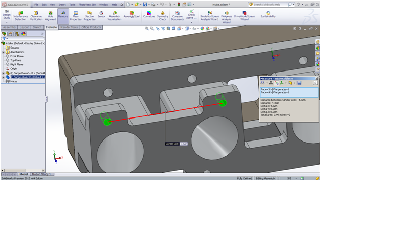

    It is a dimension hole spacing = 4.32 "beginning before using the move face, now I will explain the change within the hole without having to make a sketch, this help us if the file is in the form of IGES / X_t

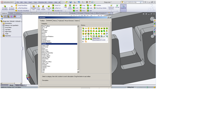

    Step 2
    Select the Move Command Face
    Or select customize> Command> feature> Move Face.OK

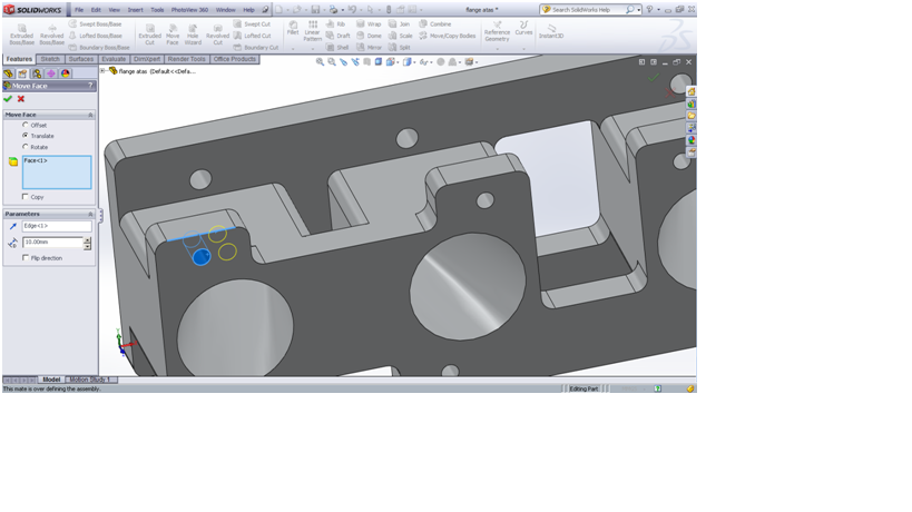

  3. Step 3:
    Step 3
    Move in the face select "Translate" no "face ", the face hole, mailing copies to add to the hole,
    And in the parameters there are "edge ", it is the line to determine the direction in which the hole in the slide, and the input sample distance of 10 mm. once completed, the fox is also next to the hole with the same distance each approach, with the list "flip direction". Next OK

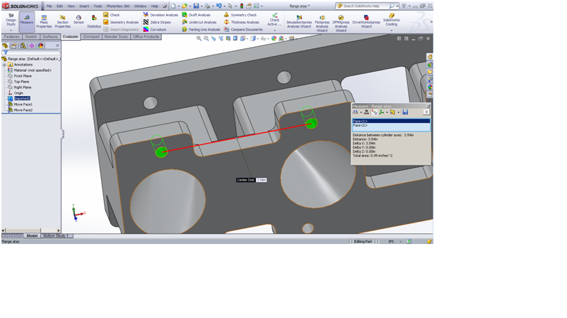

  4. Step 4:
    This is the final result after changing the hole spacing, without having to make a sketch

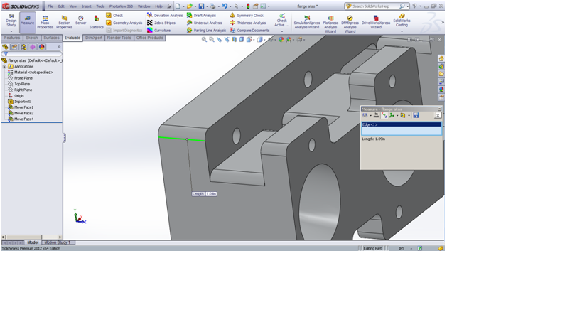

  5. Step 5:
    Now I will explain to alter the intake thick, before you certainly difficult when imported file (Parasolid), because we had to make a plant-sketch-extrude.In this explanation may be helpful and speed up your work.
  6. Step 6:
    Move in the face select "Offset" no "face ", the intake wall face,
    And in the input parameters = 0.5 in, it is the thickness that would distance me fox, next click OK
  7. Step 7:
