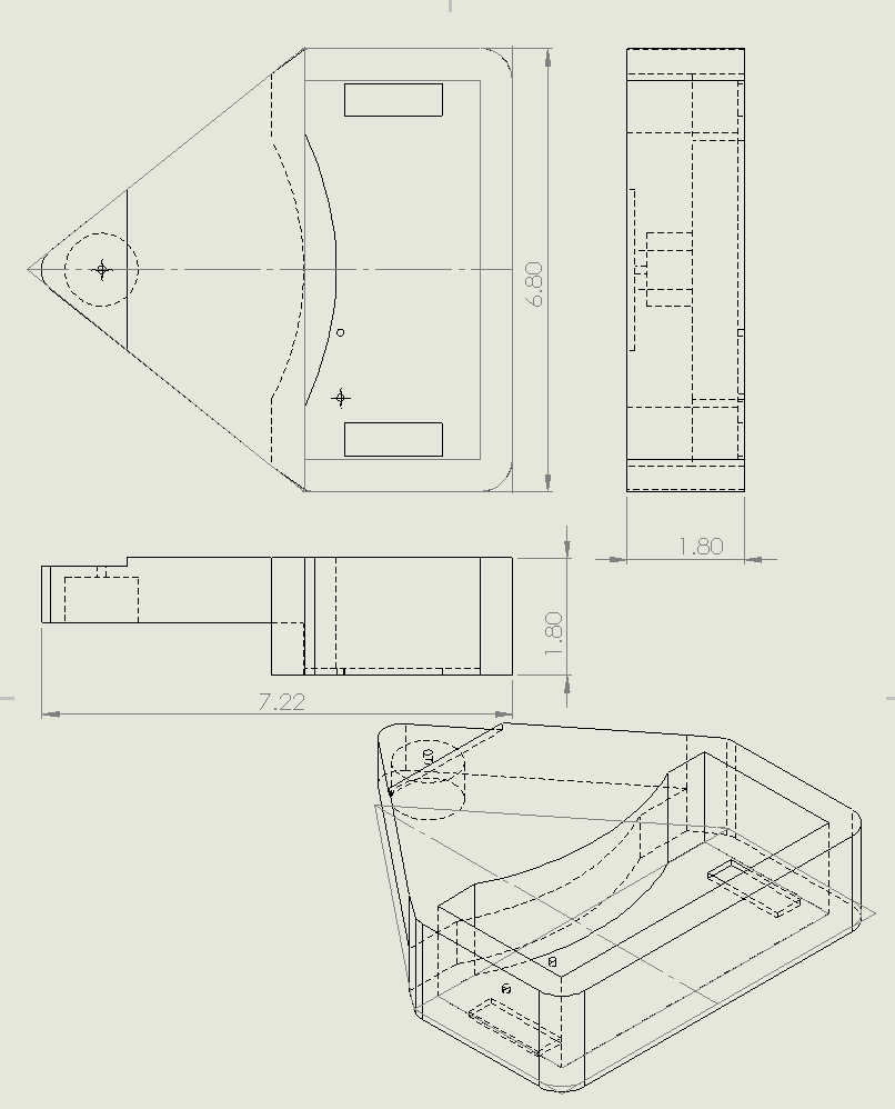

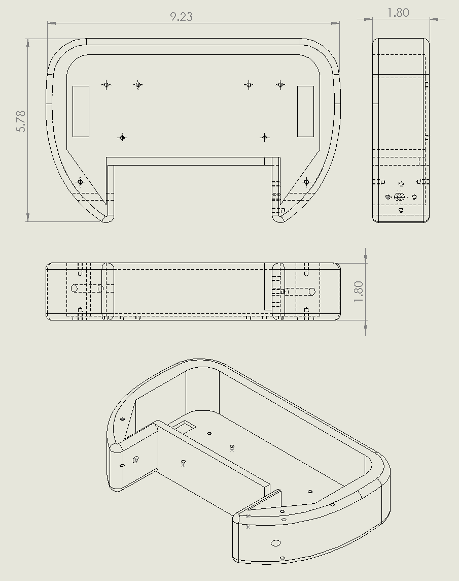

Step 3: Structural Design
The shape of your robot as a whole is a huge determining factor of how well your robot will do. For instance, a number of bot designs rely on spinning weapons. With the amount of mass that’s spinning at high speeds and the amount of angular momentum that it generates, problems may arise if your center of mass is incorrectly placed. Correctly placing your center of mass may also allow you to push harder, or just not flip yourself over when you suddenly accelerate.
Another huge part of structural design is understanding the types of impacts you want to protect against, these can include top, bottom, side, front, and back impacts. A simple way to deal with protecting against these impacts is to use deflection by having angled or rounded shapes to stop direct impacts. Here are some example sketches:
Keeping all of this in mind, let's take a look at some of the types of bots you can design...
