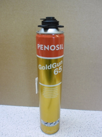

The content of OCF (One Component Foam) aerosol can consists of a mixture of polyurethane prepolymer and liquefied gases. As it escapes the aerosol can, the prepolymer reacts with air moisture and instantly appears as a foam.
The foaming process can be problematic at the cold temperatures as gases lack the power to expand and the chemical reaction become slower. This is the reason why aerosol cans work better in warmer environments, but this is not always possible.
Thus, Krimelte needs your help in developing an innovative heater that can be mounted on their OCF gun nozzle that helps to heat up the foam that already is out from aerosol can.

    Hope to take a part in this challenge. But, I think some more information required in order to start designing the heater.
    * Dimensions of gun and aerosol can (or a CAD model of them), to determine the size of the heater unit it can hold.
    * The material properties (conductivity) of the gun walls, to calculate the heat transfer rate (if someone is going to design the heater on the gun).
    * Is the mixture needs to be exactly 20°C when passing the heater, or can it be any temperature between 0°C to 20°C?

    Interesting project, but again, we need CAD models of the gun and can, and materials they are made of, otherwise this won't work. I live in New Zealand (Australasian Continent) we cannot by this brand anywhere, so how do you propose we design anything accuratley.

    PENOSIL GoldGun 65 is rated to use from +5°C (http://www.wolfgroupweb.com/uudiskiri/2011/1/PENOSIL-Gold-Gun-65-Plus-All-Season-TDS_eng.pdf), so we will assume that is no problem with gases in aerosol can until air temperatore does not fall below that limit; i think that the problem with the latent heat of the gases it occurs when the gases themselves trying to expand at the end of the nozzle's gun.

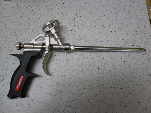

    ..and, please, a solid CAD model of the gun (even not the same gun depicted) would be very appreciated :)

    Penosil make winter foams that are rated for -18°C to +30°C. So that would lead me to believe the foams will cure correctly at those temperatures.
    And we definitely need models of the cans and the applicator gun.

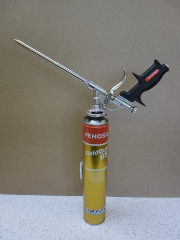

    Okay I just uploaded a 3D drawing of the gun shown above, I didnt include the can or the part that allows the can to be attached because I ran out of time this morning though Im sure I'll be able to upload it later. It should be to scale as I spent a good hour going over measurements and scaling as best I could based on a photo. I hope this helps, Krimelte Foam Gun

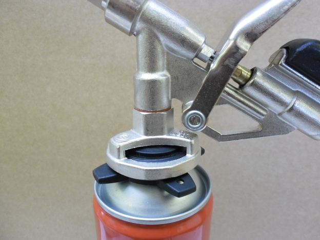

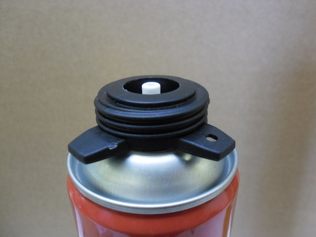

    I just updated my model to include the piece which allows the can to attach to the gun. Here's the link Krimelte Foam Gun

    Thank you Zack! I have just uploaded a one liter aerosol can (Penosil 1000ml aerosol can), the threaded adapter is roughly approximated, and needs some fillet. And definetely not threaded :)

    Aerosol cap and gun is not suitable for each other and is not same as photo.. Is there any exact model for this case..

    There are no exact models of either, the aerosol container or the foam gun, you can change the dimensions of at least the aerosol model to suit Zachs model or vice versa or draw your own
    The dimensions of these items are immaterial to the challenge and the important criteria are in the challenge brief,...... for example the specific heat, the mass of material delivered/ minute and the temperature change , and of course your design concept of the best way to achieve Krimelte,s requirements.
    I understand that a good designer will always ask questions but sometimes we need to make assumptions !!!! and use what we have to achieve a solution.
