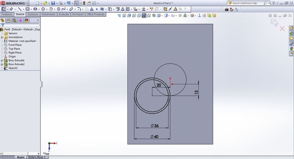

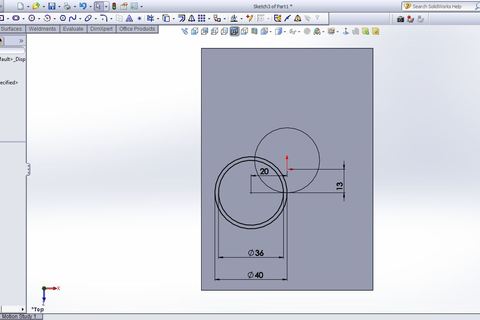

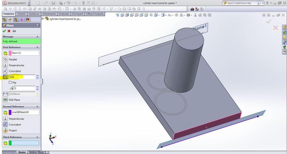

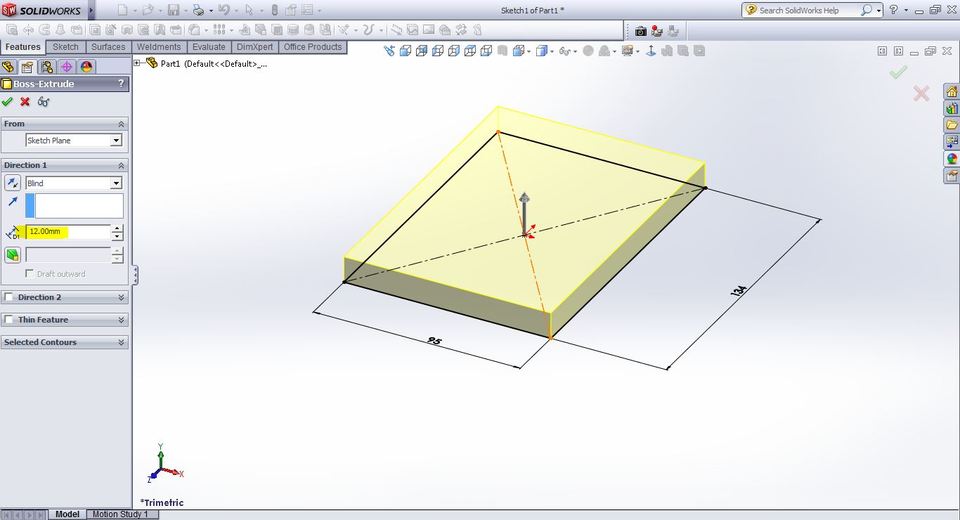

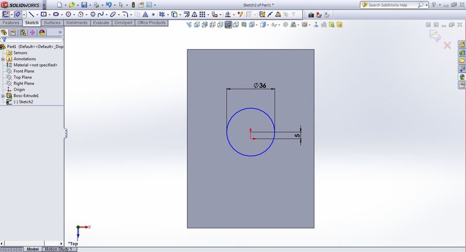

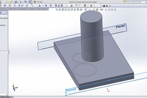

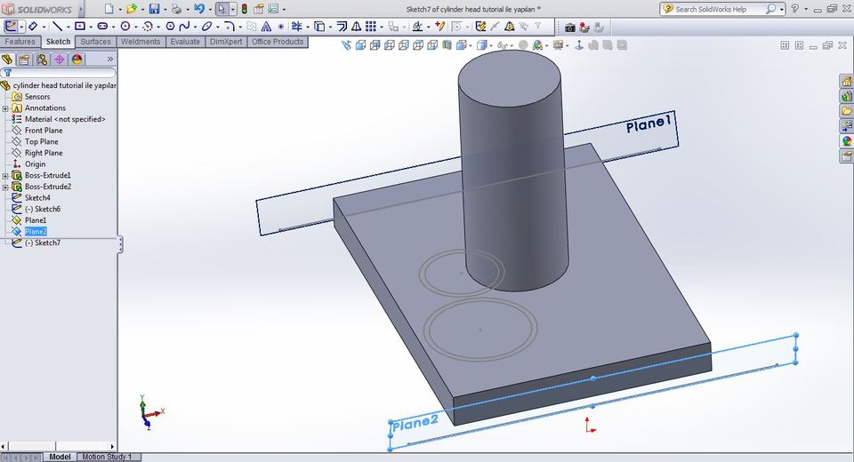

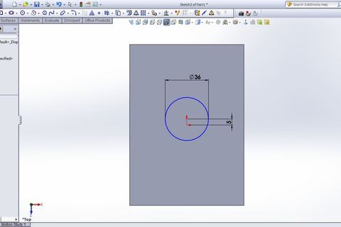

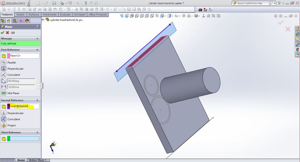

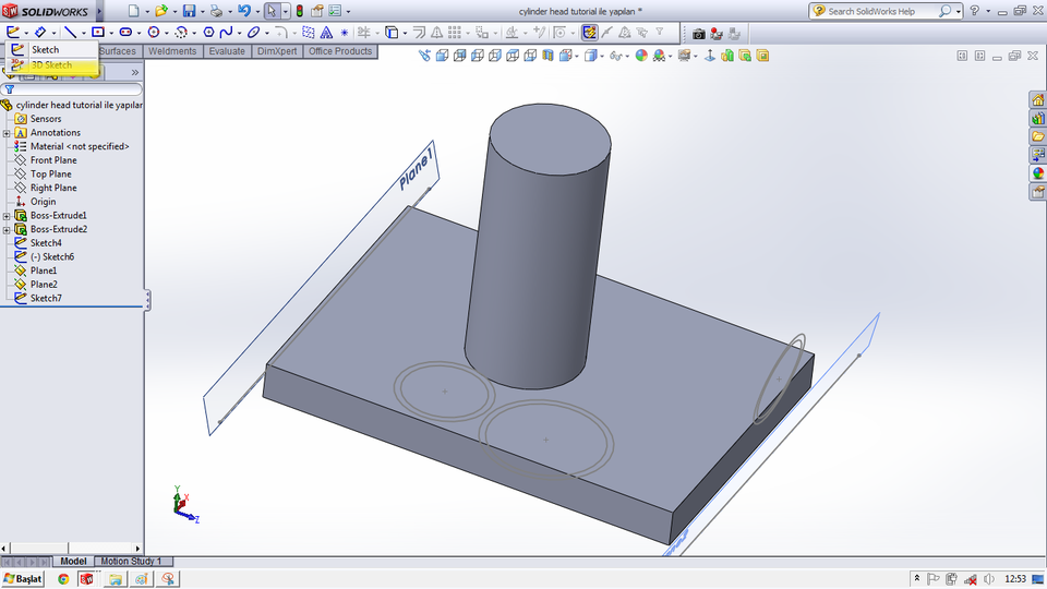

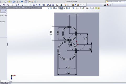

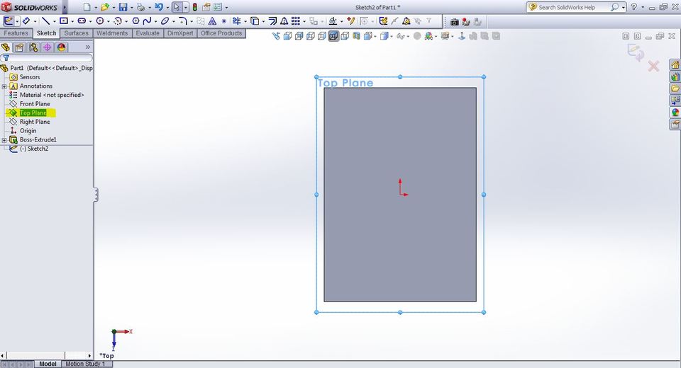

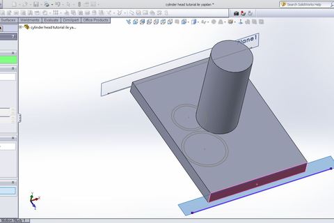

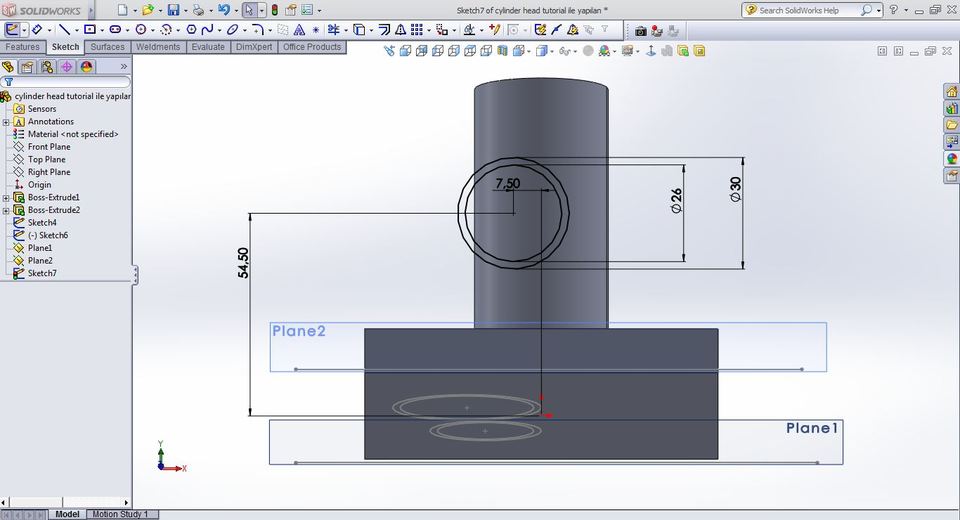

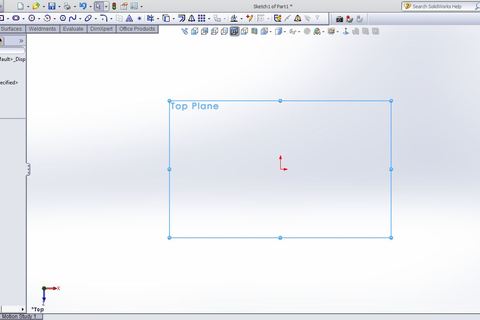

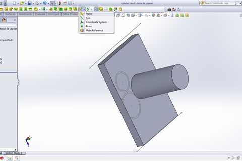

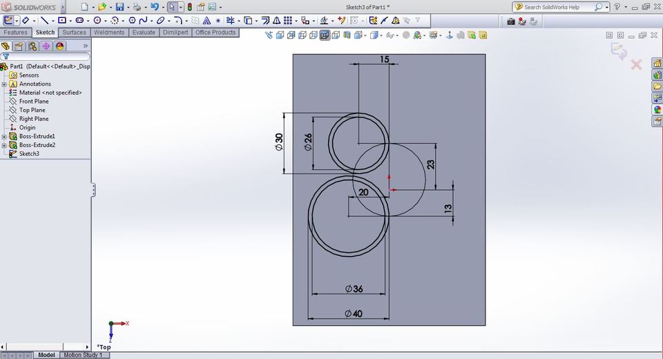

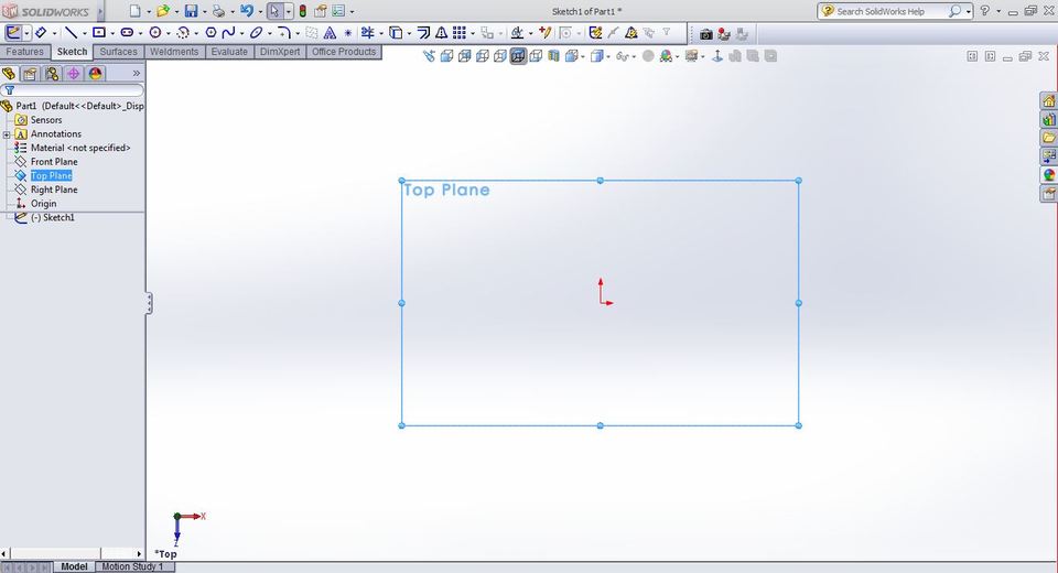

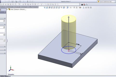

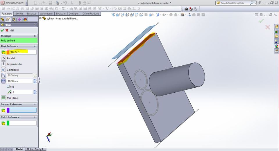

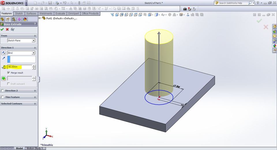

Tutorial: How to make engine part 28
10 Answers
CYLINDER HEADS

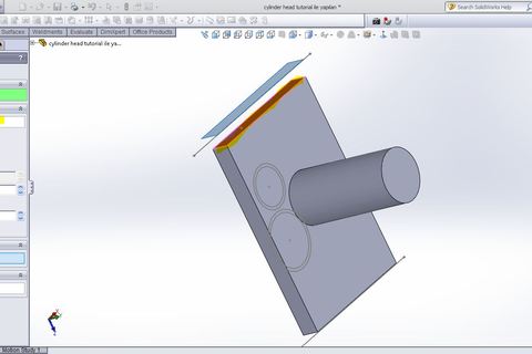

Answered with a tutorial: https://grabcad.com/tutorials/tutorial-how-to-make-engine-part-28
Haha loved the start of this one. Prepare yourself a coffee. Impressive tutorial so far. Well done on carrying through the whole thing must have been a huge effort, but fun.Thank you
