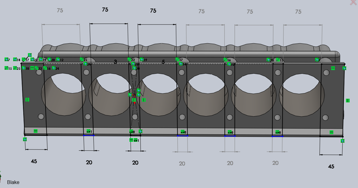

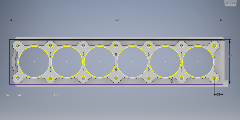

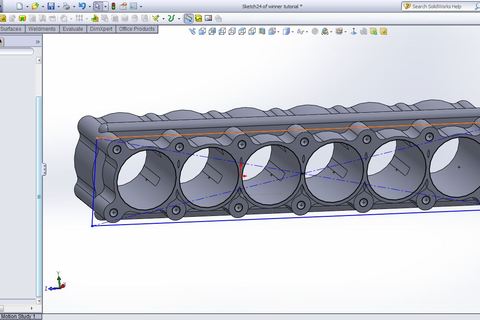

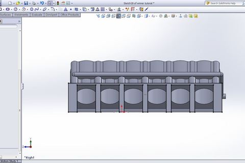

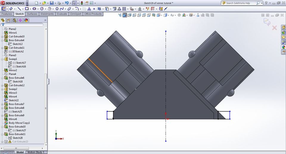

step 1 and 2 the demensions for the rectangle is: 640 x 130mm

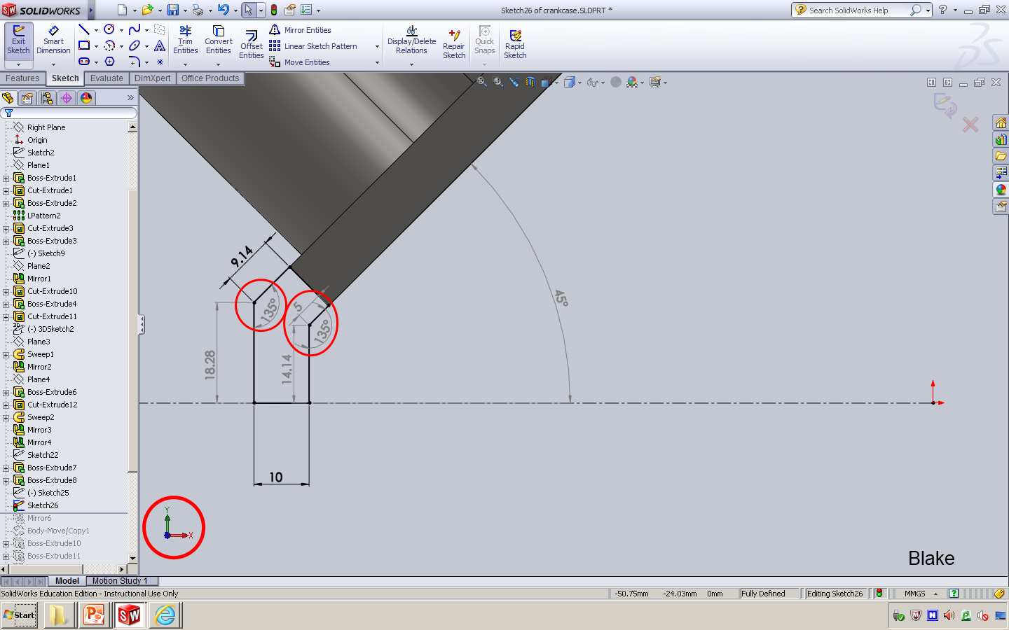

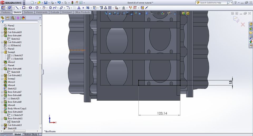

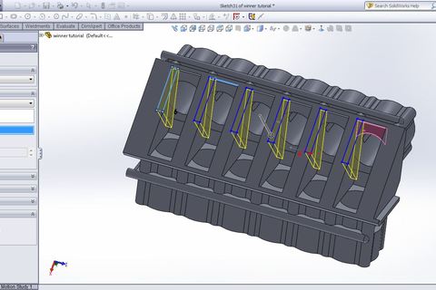

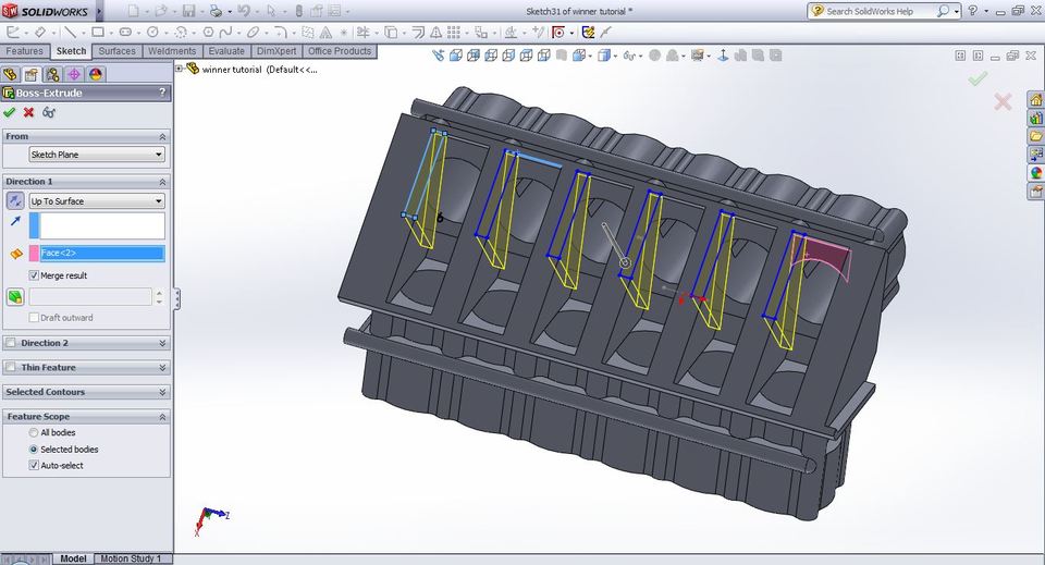

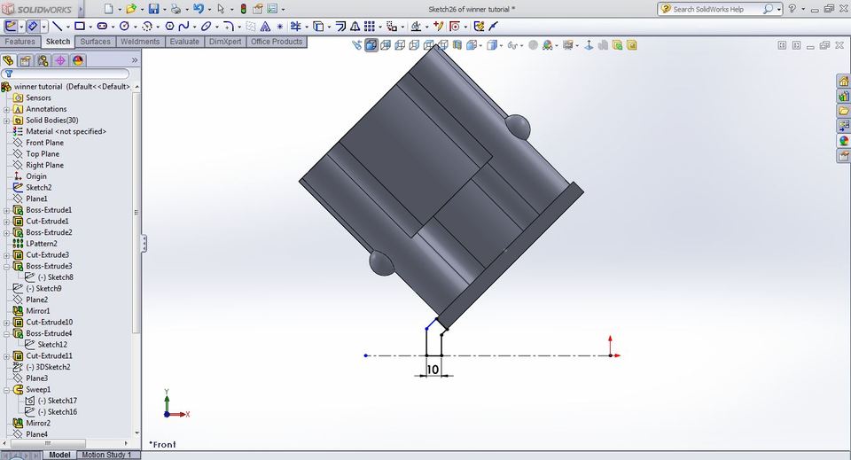

Here are the measurements for step 6

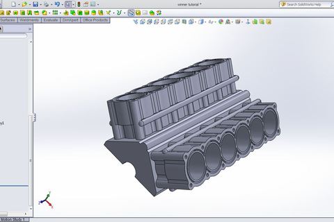

Measurements for step 3

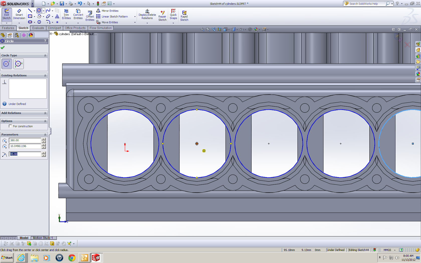

Victor,

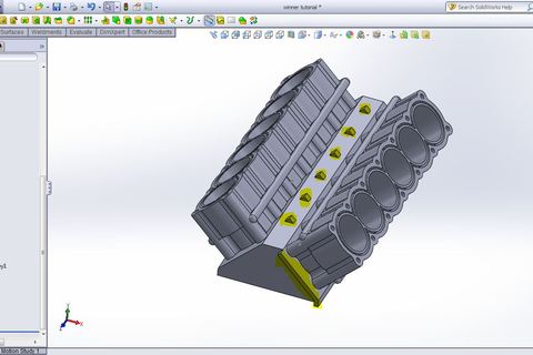

It took me a few to figure it out also, but what hes doing is extrude/cutting the extra material out of the piston holes at a depth of 160mm from the top of the piston surface.
So pick the "top" of the piston surface and create your sketch there, then look at my picture that Ive attached for a more comprehensive understanding.
Draw all 12 holes like the ones you see in my screenshot and then extrude/cut them to a depth of 160mm from the top of the pistons. Hope this helps you out!!

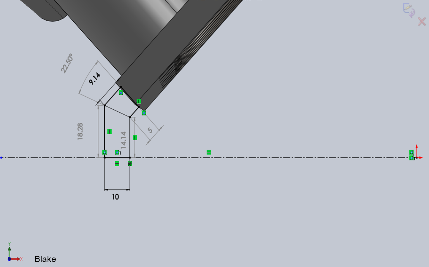

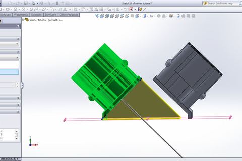

Brylle, here are those angular dimensions you asked for:

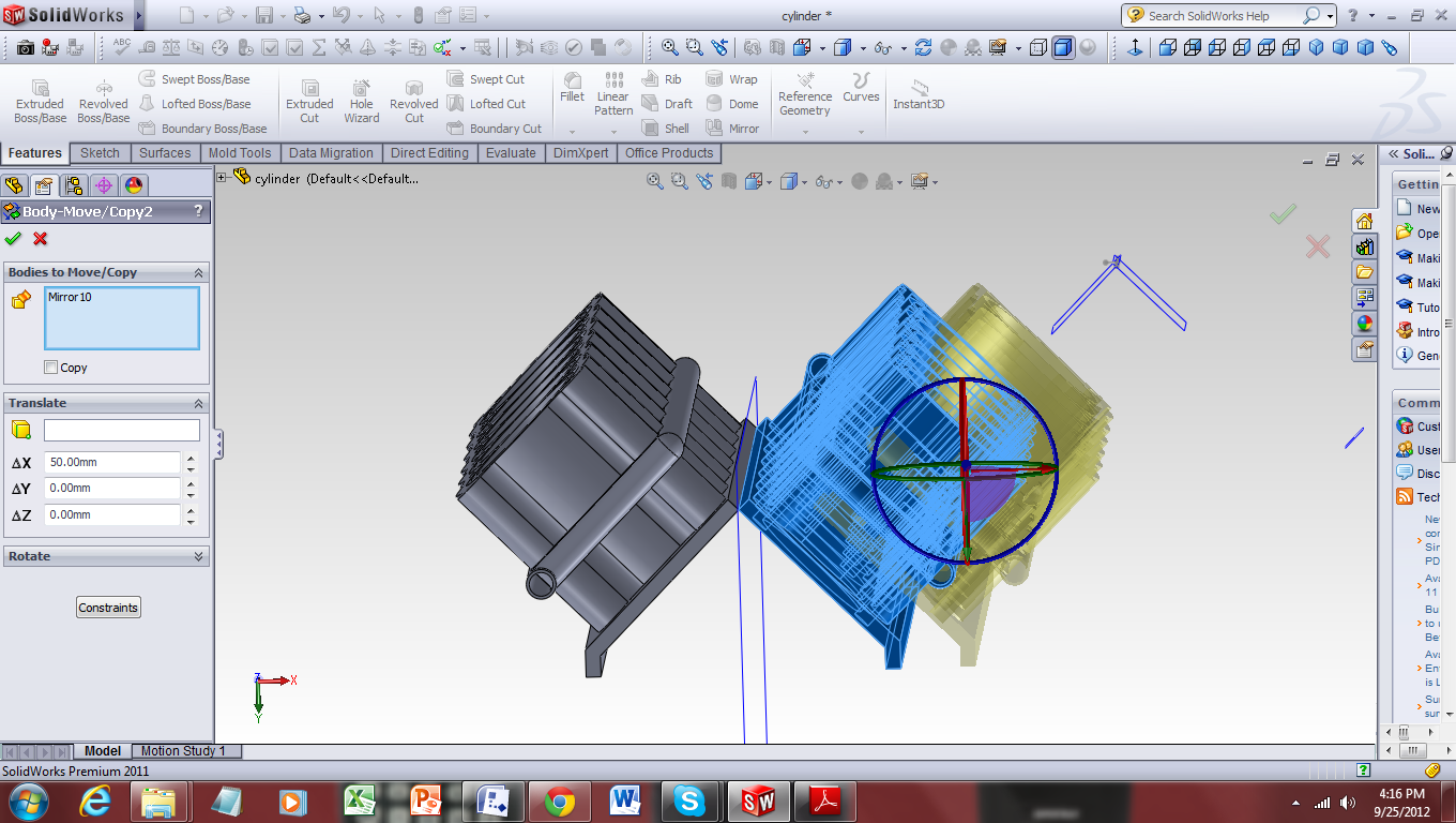

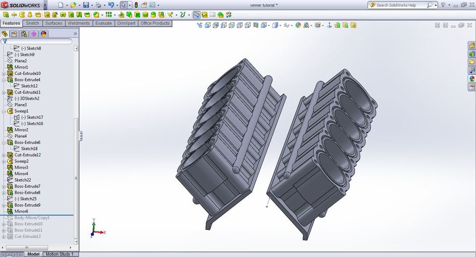

"Brylle
I don't know how far these cylinders should be apart from eachother. Also I dont know if the method I used is correct. mirror the original body and use move/copy command. Need your help buddies. thank you"
here is a picture of the dimension you required:

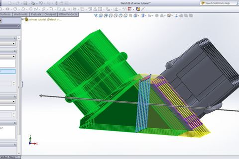

Thanks for the help. I was able to make the desired output by making another plane coincident with the original body and move it using move/copy command.
here you go, use this as an example to follow what i did.

What are the dimensions for the extrusion in Step 3? And what are the width of the ribs in Step 6?

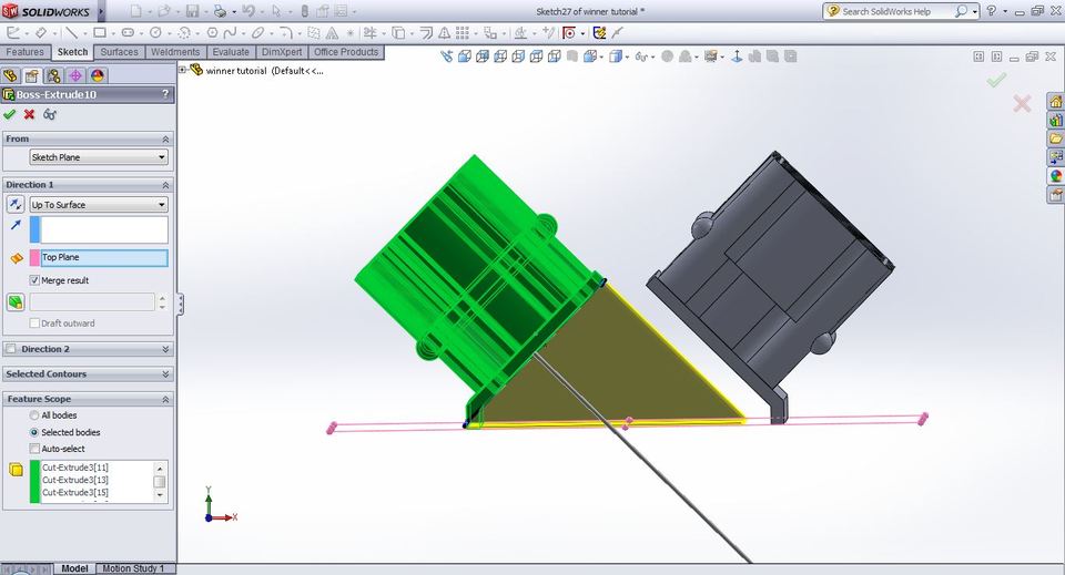

hello I would like to ask @ what angle I incline the 2 block and how much distance separate them form each others

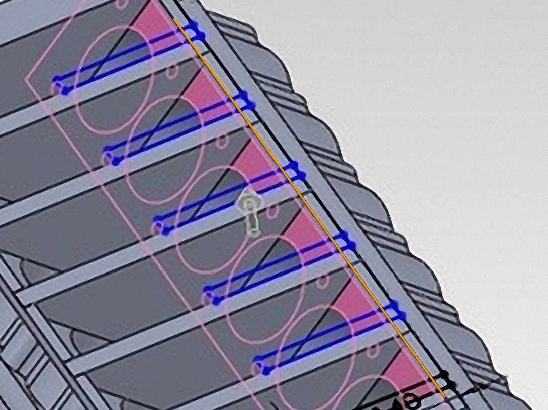

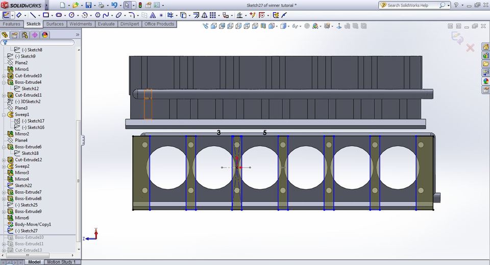

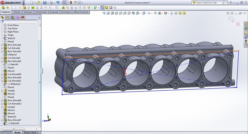

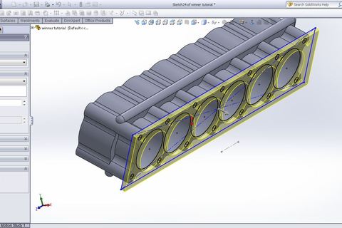

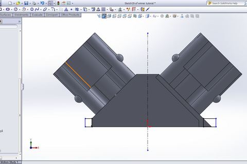

This is what happens when I do step 12. I dont know what is wrong
Brylle,
From what I noticed by looking at your added picture you went to far when drawing your rectangle, ill highlight the area Im talking about in the same picture you posted! I've drawn an orange line where you should have stopped!! Hope it helps!!
The arrow pointing in the direction of the extrusion looks funky also but that just may be the perspective im getting from the screenshot.

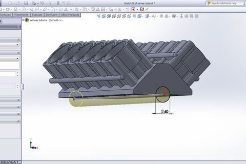

Could somebody explain step 16?

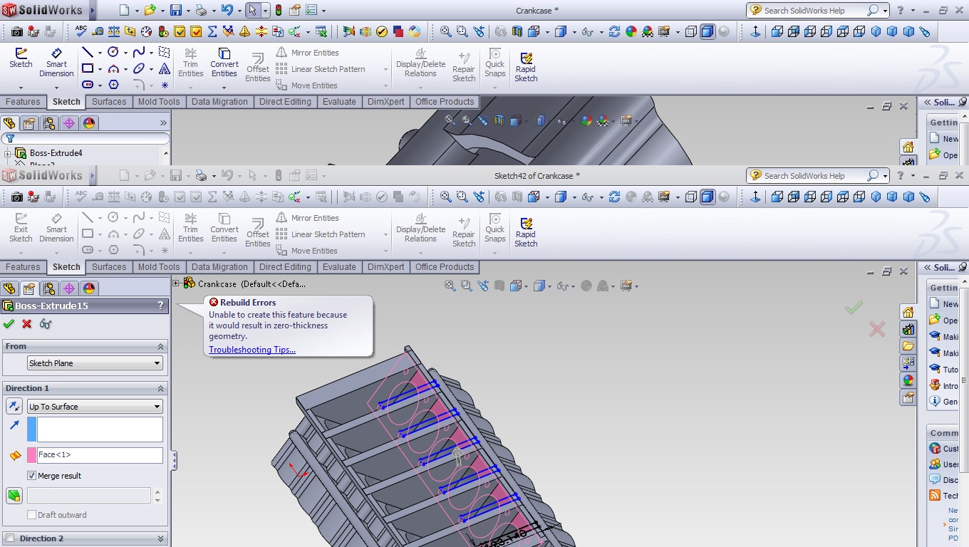

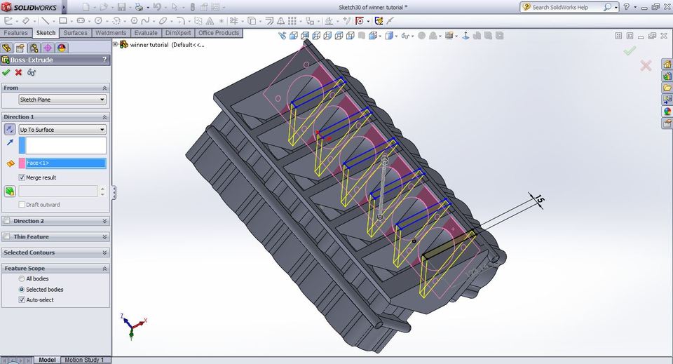

I'm having trouble with step 9. I go to extrude and I'm getting an error "unable to create this feature because it would result in zero-thickness geometry". I think it's something to do with direction 2 because I can get it to extrude to the body just fine but it wont extrude to the surface. Any help would be greatly appreciated. Thanks!

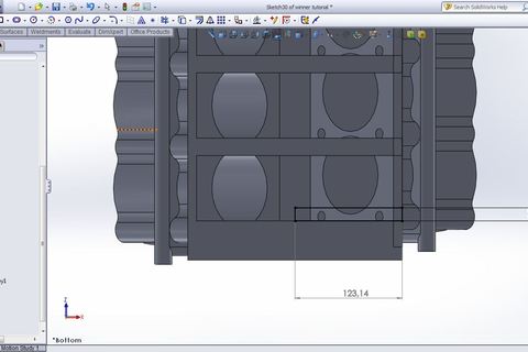

What is the dimensions in the first Picture ??, i am using inventor, and need the diamensions of the rectangle ?
Olá, gostaria de saber qual a distancia entre os dois corpos no passo 4, grato.

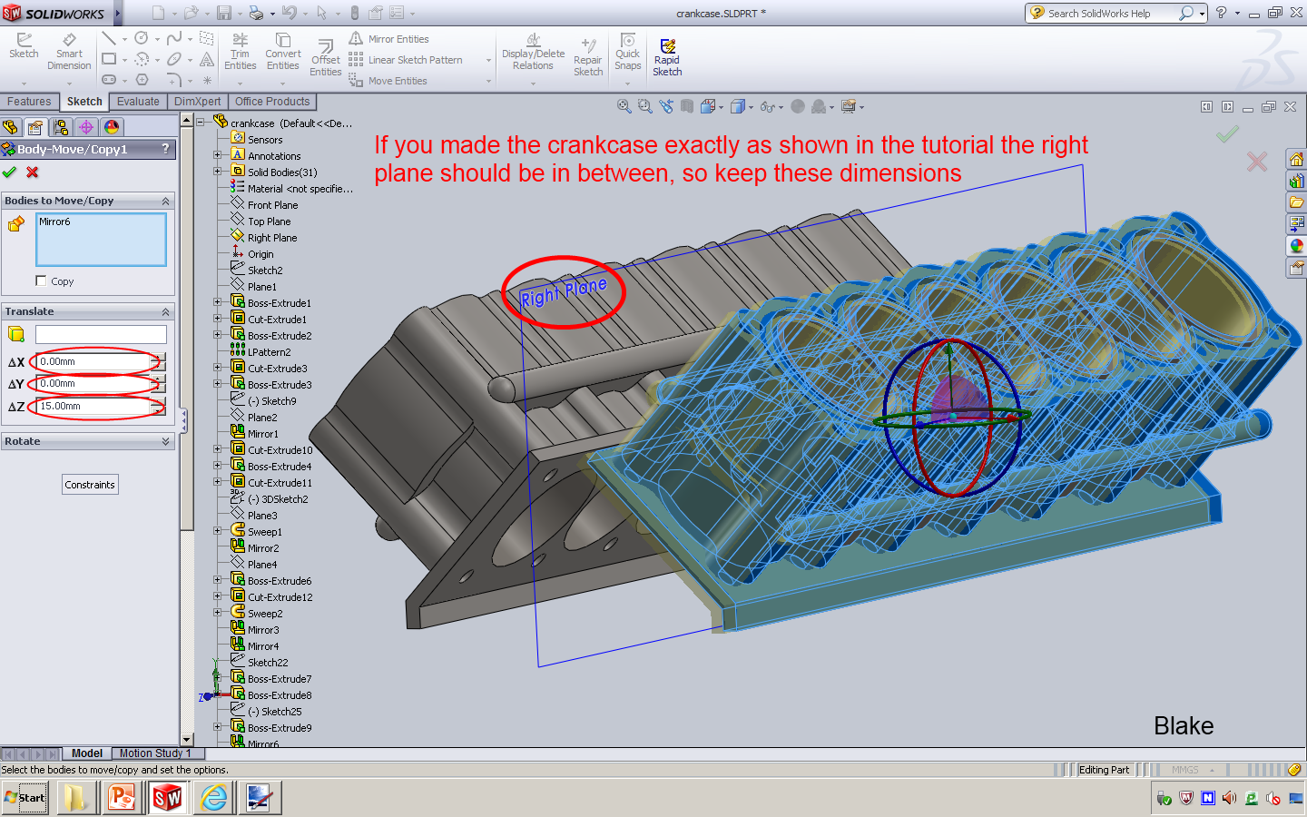

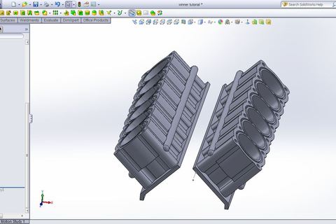

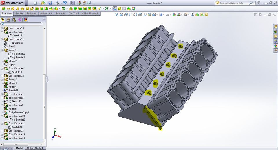

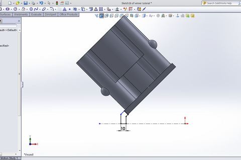

Step 4
mirror all bodies with using right plane
Problem is that i dont have any bodies
only cut extrude, boss extrude, sketches, mirrors etc on the left side. They can be selected but doesn't make a mirrored object like on the left.
So what should we do before we mirror????

I checked the proportions between his sketch from the bottom view later on, these seem like more accurate dimensions for Step 1.
