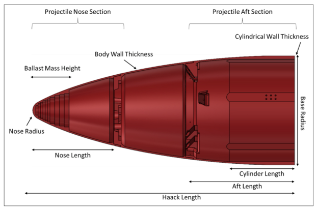

Challenge Description:
A successful outcome of this contest is a credible 3D model of a separation mechanism that is both cost-effective by utilizing easy to manufacture methods (such as 3D printing or laser/water jet cutting) and Commercial Off-The-Shelf (COTS) parts and doesn’t rely on high-energy systems like explosives.
The separation mechanism must fit inside the current Haack-cone volume of SPEED’s first stage, utilizing only the Aft section and available Nose section internal volumes:
Haack Cone Parameters
• C = 1/3
• Length = 66.5cm
• Base Radius = 15cm
• Body Wall Thickness = 0.41cm
• Nose Radius = 2.5cm (spherical rounding of the cone tip)
• Ballast Mass Height (from Nose) = 10cm
• Nose Length (from Nose to bottom of Lap Joint) = 22.24cm
• Aft Length (from Lap Joint bottom to Base) = 29.84cm
Cylindrical Extrusion
A cylindrical extrusion on the base of the haack cone with the following parameters adds a “barrel” to the end of the first-stage:
• Length = 6.825cm
• Wall Thickness = 0.9cm
