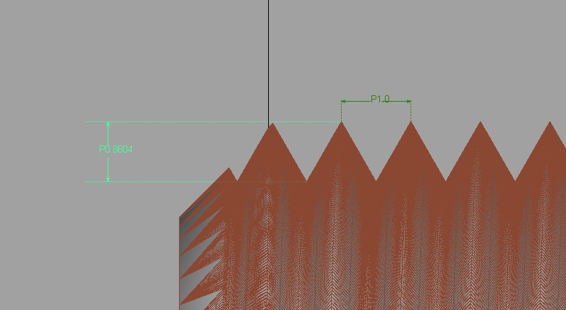

Hi everybody. I need a 14 mms counter clockwise thread 3D model, both inner and outer.
Possibly in IGS or STEP format.
Help anyone?

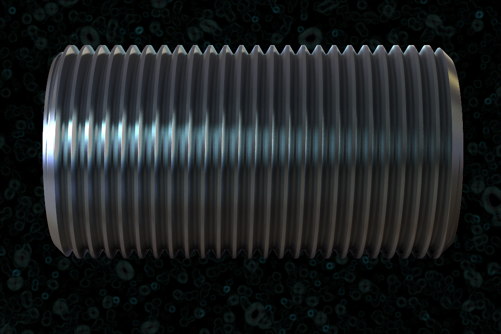

I made some parts: https://grabcad.com/library/m14x1-thread-counterclockwise-left-handed-1
Solidworks models are last saved in 2017. The step files should import to other CAD/CAM programs.
An image with the reference dimensions is also provided.

I need to send it to a CNC service.
Please check the attached picture
Male and female have the same dimensions
units are mm
Fred I've checked your files, they're exactly what I was looking for. Very clean files.
Thanks a lot, really.
