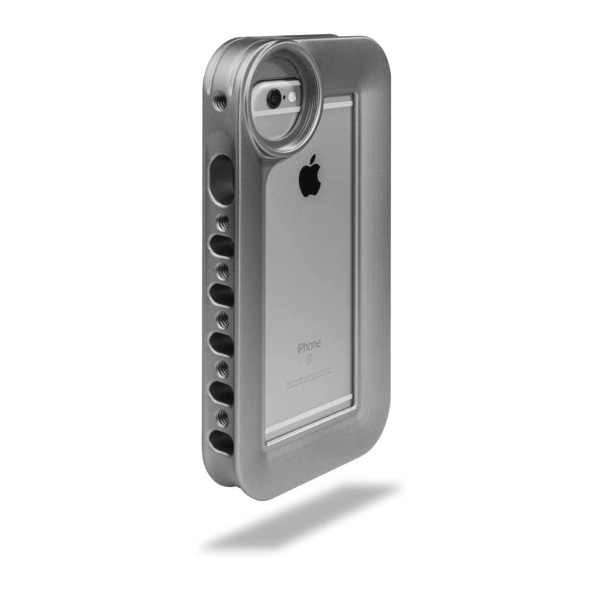

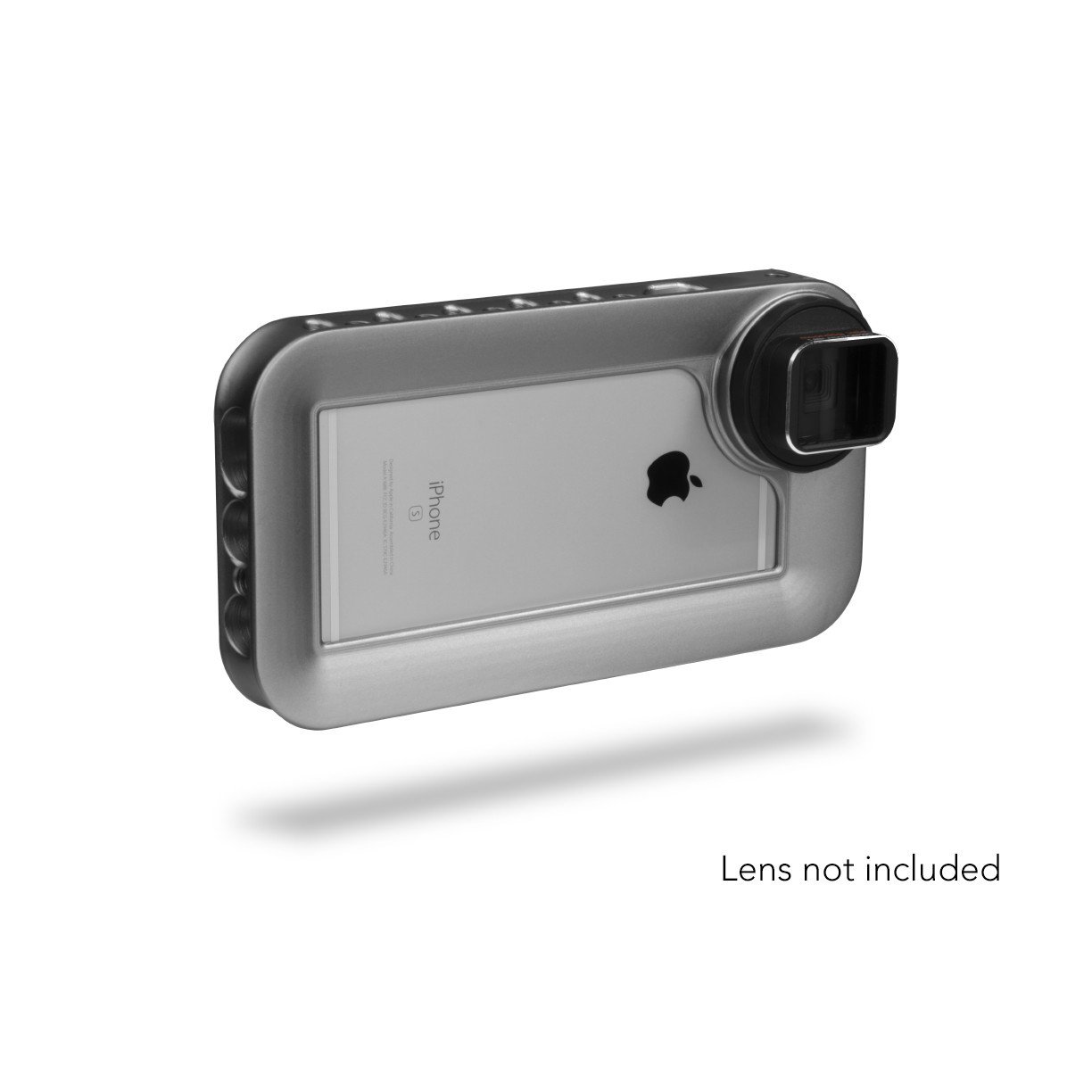

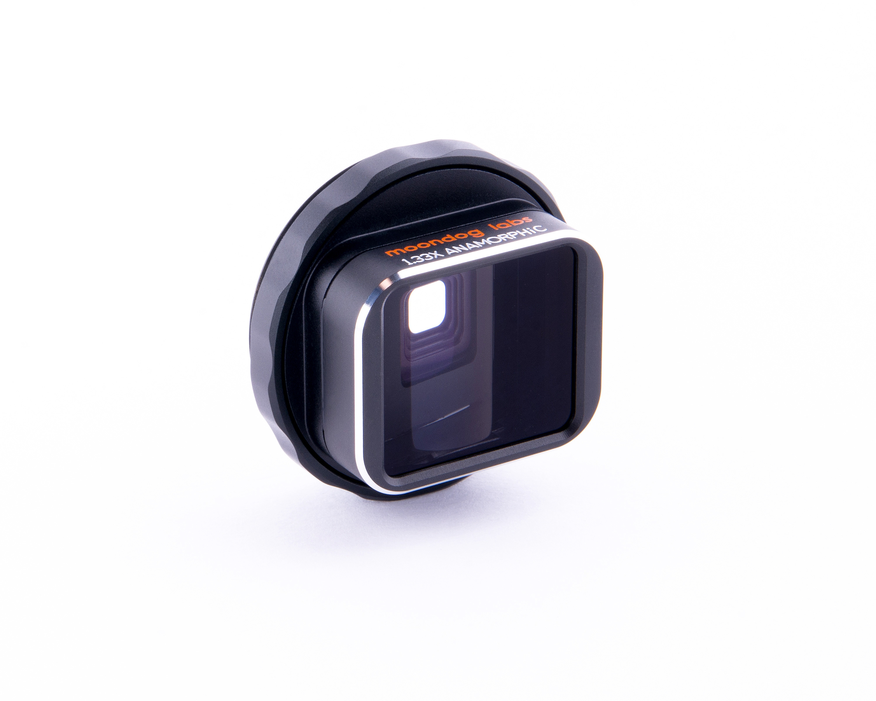

I was hoping someone could help me guide me on how to create a 37mm screw mount for this lens: https://www.moondoglabs.com/store/#!/1-33X-Anamorphic-Adapter-Lens-37-mm-thread/p/55253074/category=8525657
I want to model an iPhone case with a 37mm screw mount that I could use with the linked lens. Just screw the lens to the case and avoid using a clip and other crappy adaptations.
Unfortunately I don't know how to make the screw mount that would accept this particular lens.
These guys have a case that does the same thing but I'd like to create something less bulky and 3d print it:
https://heliumcine.com/collections/iphone
Any help would be much appreciated.

Thanks for the input but before contemplating on that, how do I model the screw mount itself in 3d?

From the images provided it looks like a female thread is the mounting method. To design the thread, it needs to be identified. It is most likely a common thread used for many lenses, but it is best to be positive.
Cmalco mentioned a bayonet type of interchangeable system, and that would be handy, but photo C above looks like a threaded socket.
The threads are most likely rather fine, so creating them in "plastic" will not be a good idea. DMLS is possible, but expensive. I'd look into having the threads machined (once they have been identified. A lathe or mill (with single point thread cutting capabilities) should be able to produce these with little trouble.
Spec sheets for the lens should identify the thread used.
Another critical factor is alignment with the existing lens, and proper spacing for the focus. I still believe metal is going to allow for the best fit and function, but I could see some early prototypes made of a rigid material like DSM Nanotool for testing.
The bayonet style lens is an option from the lens maker. It's made specifically for the iPro lens system.
https://www.bhphotovideo.com/c/product/1330284-REG/moondog_labs_5135_1_33x_anamorphic_adapter_for.html
