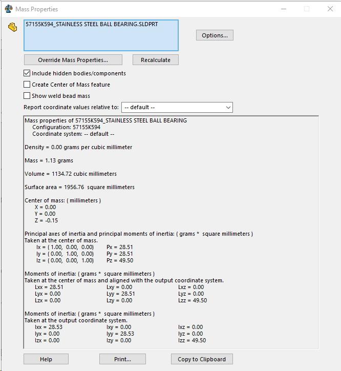

assume you had buy an object like a DC motor and you only modeled it in solidworks without details but you have data sheet and net weigh of that motor. so without choosing a specific material you want to add the mass of that object to your design. what is the solution?
Accepted answer
first design an object.
and if you don't want to add a specific material to it and still want to have mass then just go to the mass properties option in evaluate tab go-to option select custom setting and then change the density of and you can have desired mass.
1 Other answer
Click Mass Properties. Then there is a button in there to override the mass properties.
Make it what you want.
