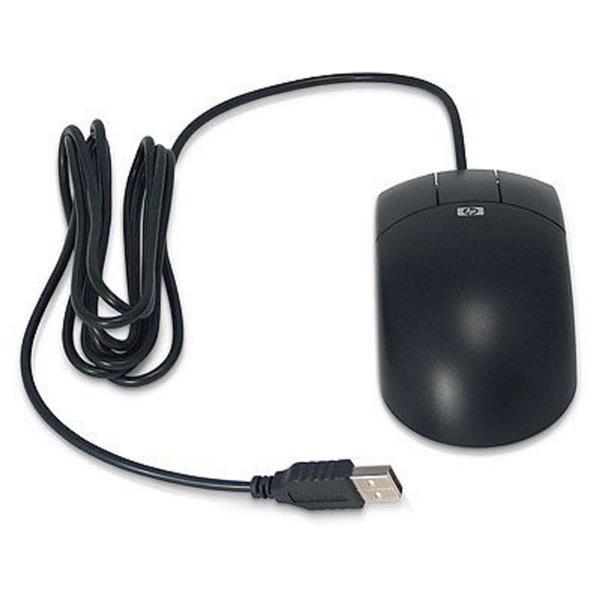

I mostly use CATIA and just can't stand pressing the middle button/wheel. In CATIA, the middle button is used for pan AND rotate (in combination with the left button). So I basically have to press the middle button (which is also a scroll wheel) every 2 seconds and it is really a pain, to the point that my middle finger hurts after a few hours. I have two mice, both Logitech, an M510 and an M720. They work great for everything, except CATIA.
Does anyone know if there is some sort of configuration in CATIA or Logitech Options to somehow change this? The BIG advantage of the "CATIA" method is that you do not need to touch the keyboard at all to move in 3D (no ctrl or shift button to hold) and I kind of like it this way.

I've never liked using a scroll wheel mouse with CATIA either. Not sure this is the best, but I use an old 3-button optical mouse. HP DY651A.
